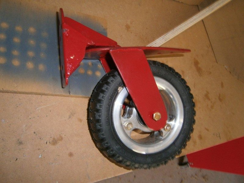

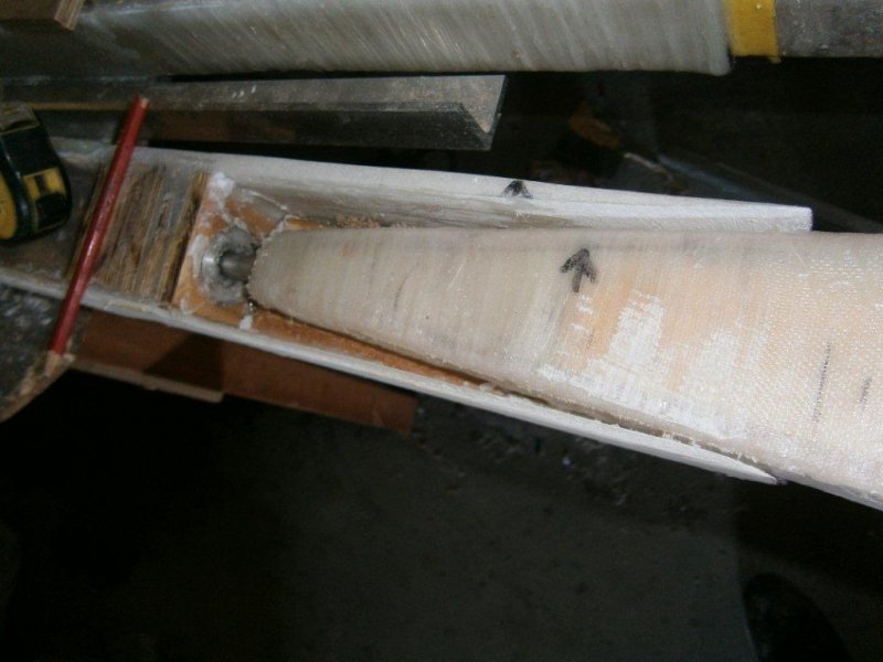

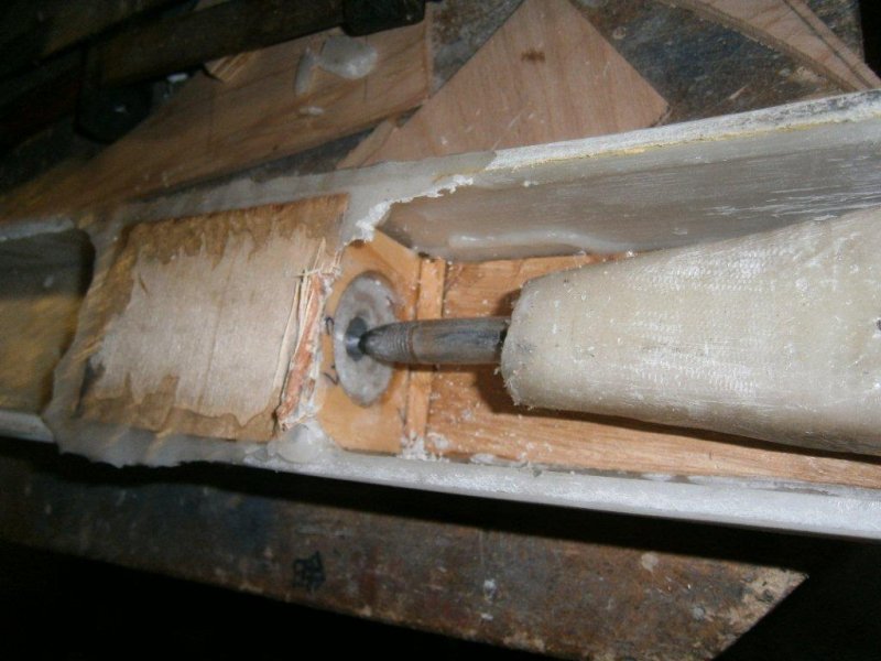

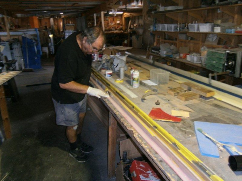

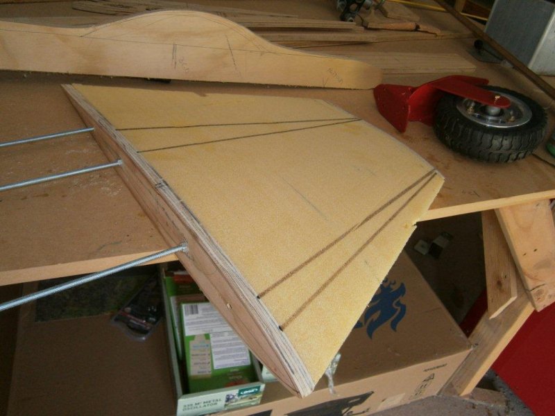

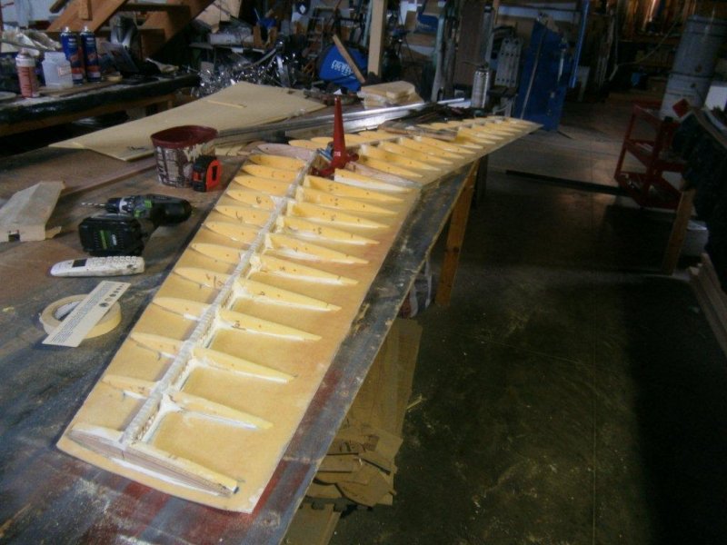

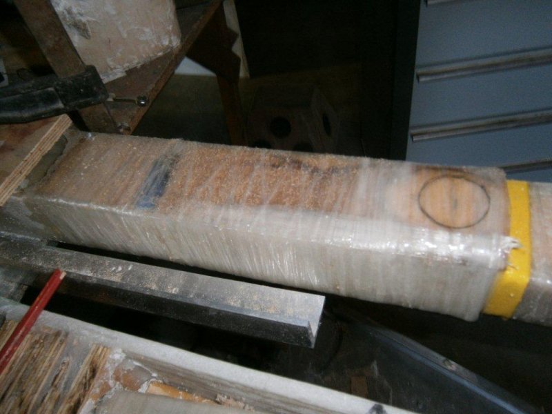

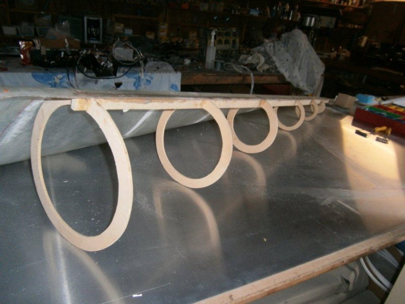

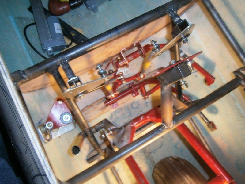

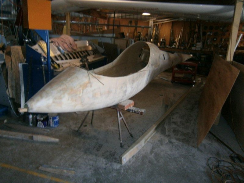

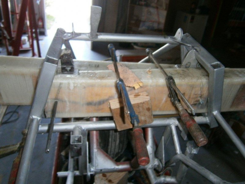

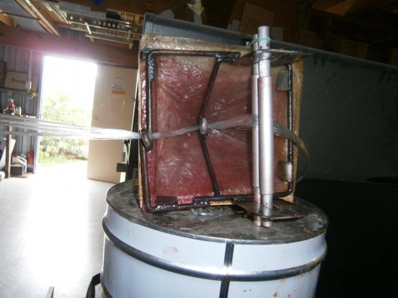

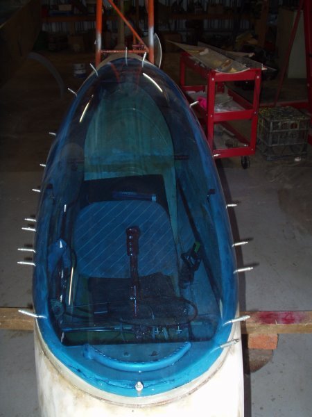

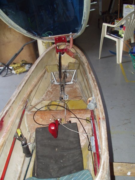

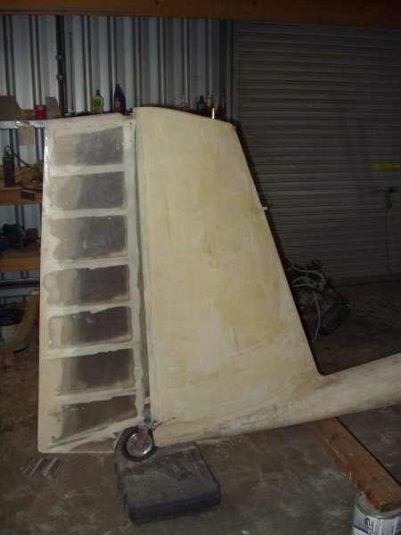

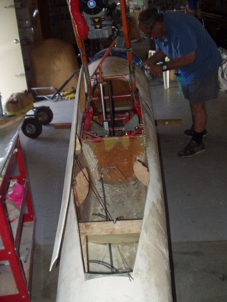

graham brown Posted August 8, 2015 Share Posted August 8, 2015 Hi Garry asked me to post some pictures of his new fibreglass motor gliding he is building (the Shawnee). 1 1 Link to comment Share on other sites More sharing options...

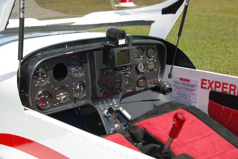

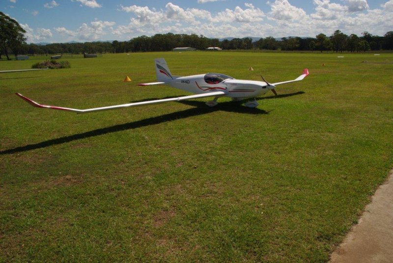

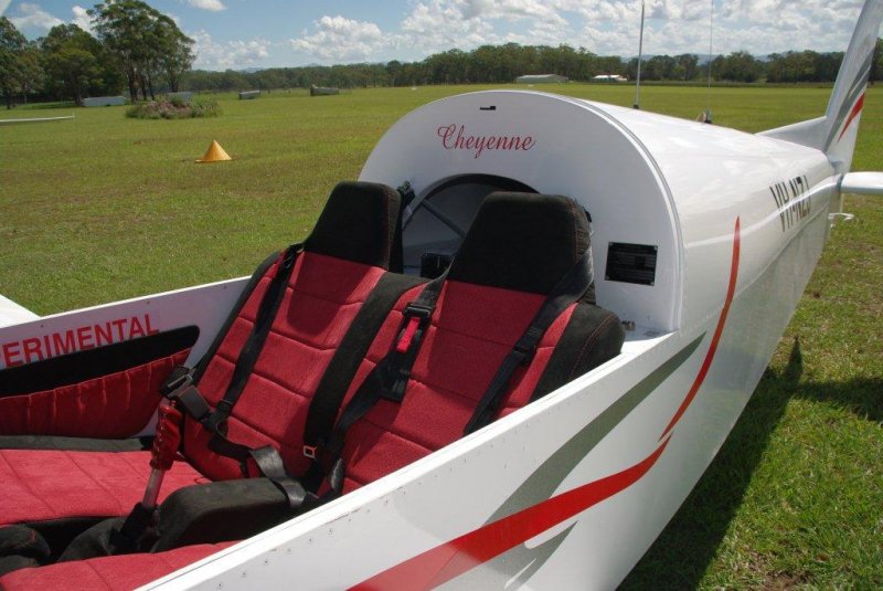

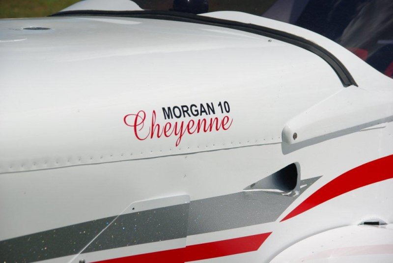

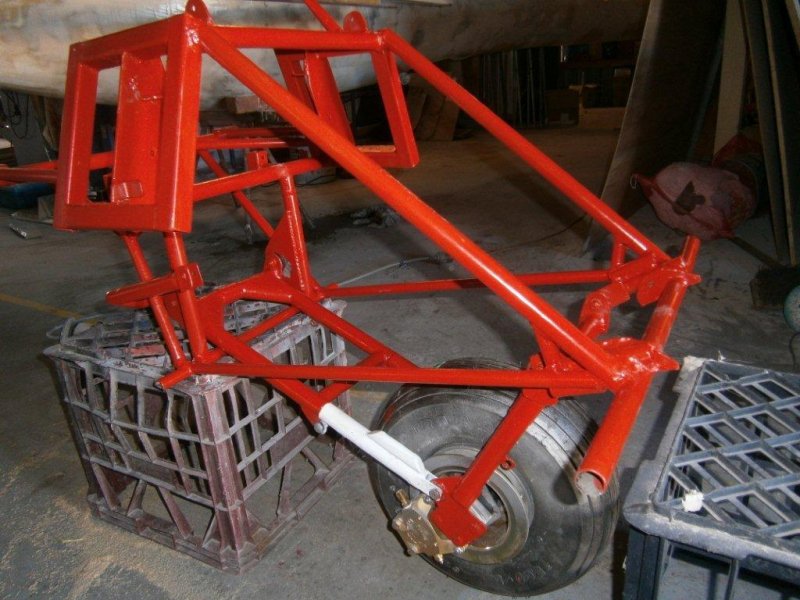

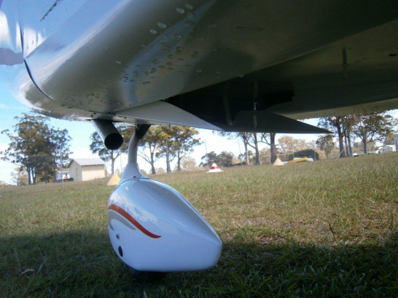

graham brown Posted August 8, 2015 Share Posted August 8, 2015 Also posting the pictures of Garry's Cheyenne touring motor glider. 5 Link to comment Share on other sites More sharing options...
graham brown Posted August 8, 2015 Share Posted August 8, 2015 I left some out. 2 Link to comment Share on other sites More sharing options...
