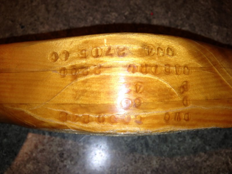

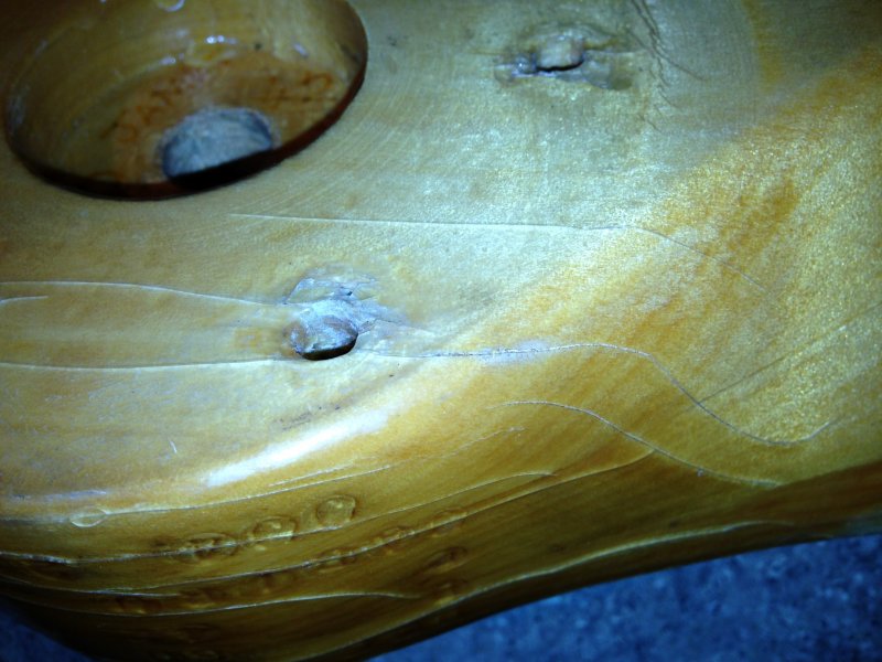

deadstick Posted July 13, 2013 Share Posted July 13, 2013 Had a prop fail on my J160, the story goes as follows:- CFI reported that there was an intermittent vibe that he noticed over a few flight recently. I cast my eye over everything including prop and could not find any fault, so he took me for a fly, I did notice a change in harmonic frequency when climbing though 1k feet and put it down to a sticky diaphragm in the carb due to the exhaust being a bit darker as well. Anyway after sitting idle for over two weeks due to terrible weather and flooding the aircraft is prepped for flight and started, there is now a massive vibe at idle and across the RPM range so its shut down and I begin looking for the culprit, I was pretty sure it was the propeller as it was a 1 per revolution style of imbalance. Well as the attached pics will show there was major cracking between the prop hub bolt holes and a crack running down the back of the blade, I can only assume the cracks were present before and the wet weather has allowed the wood to soak with water and swell.... I repeat the prop was inspected on the aircraft prior to the bout of wet weather without any indication of cracking... 2 Link to comment Share on other sites More sharing options...
Guest Maj Millard Posted July 13, 2013 Share Posted July 13, 2013 Mmmm not a real flash finish...at a rough guess from the photos it looks like the prop has been a bit loose, and allowed to 'work'...........Maj... Link to comment Share on other sites More sharing options...
deadstick Posted July 13, 2013 Author Share Posted July 13, 2013 MM, the prop didn't come loose its like the wood has swelled and cracked, I suspect there may have been a small crack in the composite finish that allowed moisture ingress. there is a strip of delamination straight down the middle of the back ace of one of the blades. I have experienced the delamination before, One prop didn't even last the ground run post install from new before it threw a leading edge and others have delaminated within a few hours of use. I would really like to throw on a Sensenich W62HJ-48G but its a C model Jab so I am stuck with the factory wooden prop it was certified with unless I could afford the coin to have a car35 Eng certify a mod prop but alas the two Jabs I have keep my hand in my pocket as it is LOL Link to comment Share on other sites More sharing options...
AVOCET Posted July 13, 2013 Share Posted July 13, 2013 Looks like a send back to the factory job , IDE be a bit concerned about the fly wheel bolts , Probly worth a look , check tention , Maybe replace the bolts , Mike . 1 2 Link to comment Share on other sites More sharing options...
Guest Maj Millard Posted July 13, 2013 Share Posted July 13, 2013 MM, the prop didn't come loose its like the wood has swelled and cracked, I suspect there may have been a small crack in the composite finish that allowed moisture ingress. there is a strip of delamination straight down the middle of the back ace of one of the blades. I have experienced the delamination before, One prop didn't even last the ground run post install from new before it threw a leading edge and others have delaminated within a few hours of use. I would really like to throw on aSensenich W62HJ-48G but its a C model Jab so I am stuck with the factory wooden prop it was certified with unless I could afford the coin to have a car35 Eng certify a mod prop but alas the two Jabs I have keep my hand in my pocket as it is LOL I 'd say your Probabily correct there, poor finish letting in moisture. I've always finished my wood props in Estapol satin, in the spray can. Always give a very nice and durable finish. The selection of wood is important also . Should be able to handle a little moisture penetration without going to shxx.........Maj...... Link to comment Share on other sites More sharing options...
Vev Posted July 14, 2013 Share Posted July 14, 2013 I Believe the 2200 engine is very hard on prop/hubs owing to engine pulsing every 180 deg, where the 3300 is every 120 deg and much easier on components. For what it is worth, I experienced a prop failure at take-off in 2010 in a J160. Take-off roll was normal and got to 300' up wind when I experienced a bad vibration, which I instantly recognised to be prop related failure owing to the frequency. I pulled the throttle power back to where there was less vibration and limped back around to land on the strip. On inspection, I could see the back side of both blades had significant cracks at the blade/hub interface. It was clear the blades had coned forward and the tips may have moved as much as 1.5-2" ... I was lucky it didn't toss a blade/s at 300' as I was running out of clear land ahead, that is, if the engine hadn't departed the airframe altogether. I also saw this repeated in a Mogan Cheetah with a 2200 when the prop suffered multiple fractures and lost bits off the blades. In this instance the vibration was so bad it lost the spinner and damaged the engine rubber mounts leaving the engine flopping around on the engine mounting bolts ... not sure how the pilot got it back home. I was following him and watching him loosing altitude, I ended up rushing ahead trying to get students out of the circuit to give him a good shot at a clear runway for a once only landing option. The lesson for me .... I check my prop very carefully each day and don't hesitate to remove a spinner to take a good look if I suspect anything. I also check bolt torque every 25hrs, this may be an excessive regime but it gives me piece of mind. Cheers Vev 1 2 Link to comment Share on other sites More sharing options...
