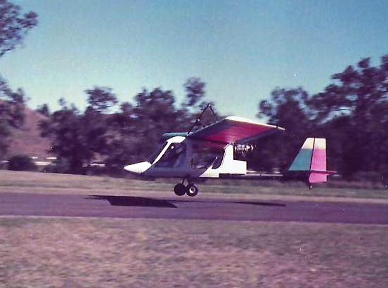

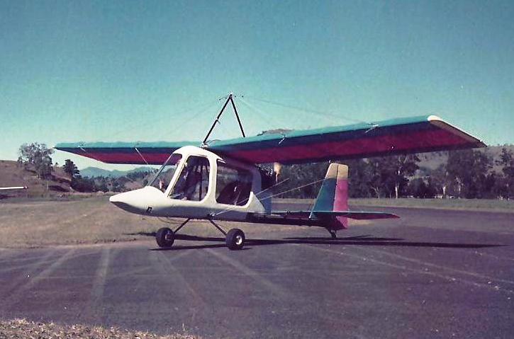

I had a problem like this a long time ago and didn't find the answer until years later. I'm not guaranteeing it's the same thing but could be worth checking.
I built a fully enclosed pod for the Drifter, ugly looking thing but it was nice and warm in winter, but it had that same wandering problem, feet off it would slowly oscillate a long way side to side, I never measured it but it seemed like 15-20 degrees each way. I just assumed that the amount of side area forward of the CG was too great and was overbalanced compared with the vertical stabiliser, especially since the Drifter doesn't have dorsal or ventral fins.
Not long after that I sold the Drifter and went flying commercially so I didn't worry about it any further.
About ten years later a fella in Arnhemland had an American ultralight that was a copy of a Challenger and it had the same problem. He fitted VGs halfway down each side of the fuselage and it fixed it completely. His apparently correct theory was that the flow was semi-laminar on the fuselage sides but any deviation from straight ahead would turn the flow turbulent further forward on one side than the other. That meant more lift on the attached side so the fuselage would rotate toward the lifty side. Eventually it would reach an angle where the fin took over and it would cycle back the other way.
It most likely wouldn't apply to yours because the fuselage is in the prop wash but if you don't find another explanation it would be easy enough to put a strip of something down the front of your door line to break any attached flow and see what happens.
