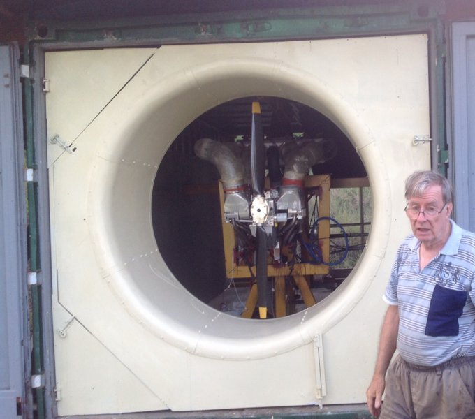

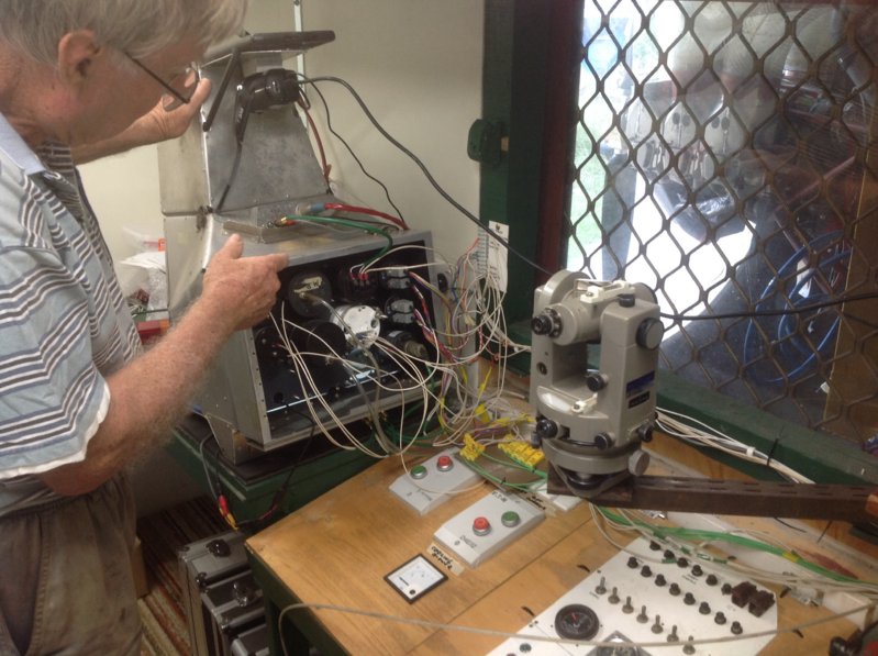

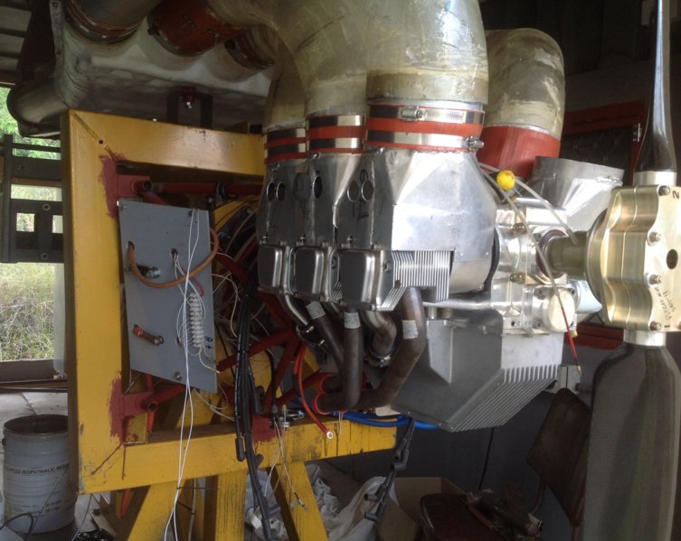

What's happening with the CAMit engine Test Cell?
A recent visit to Dafydd Lewellyn was very educational; he sure is a Renaissance Man of aviation.
The test cell has been built and there is an awful lot more to it than I could have imagined.
It's a bit like the space program. The engine is mounted on a massively strong balanced frame which allows torque changes to be accurately measured. Highly accurate sensors emerge from every part of the engine and the cables and tubes run into the sound-proofed control room where banks of instruments monitor every variable.
A complex cooling system delivers air individually to each cylinder; valves can restrict air to test extreme variations in head temperatures.
When all thus is working perfectly the engine testing program can begin.
If you are going to test an aircraft engine for Certification you have to get it right.
