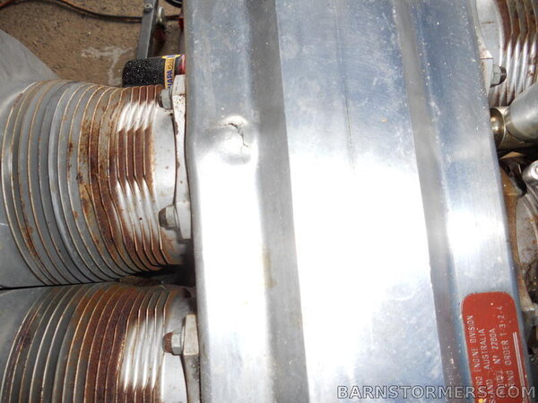

It was the lower bolts between cylinders 2 & 3 and between 3 & 4 which broke. When the motor is in situ it is hard to see the ends of the bolts. (Especially when they are not there!)Both had broken where the thread ends. This means that number 3 pot was attached by only the two upper bolts. It uses 100LL avgas exclusively, so you would't expect detonation to be the culprit but I'm starting to think it may be. Regards, Bob
