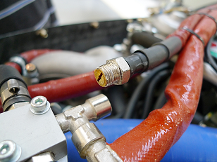

DrZoos Posted December 12, 2013 Author Share Posted December 12, 2013 I used this stuff initially that worked well https://www.google.com.au/search?q=go+kartexhaust+sealer&rlz=1C1GGGE_en-GBAU451AU451&espv=210&es_sm=93&source=lnms&tbm=isch&sa=X&ei=kCupUqKKOI2TiQfA1IH4Dg&ved=0CAkQ_AUoAQ&biw=1366&bih=643#es_sm=93&espv=210&q=go+kart+exhaust+sealer&spell=1&tbm=isch Then i added a second layer and some rotax exhaust header wrap that i bought from Autobarn and cable tied that to the original position. Its now questionably less effective then when i just first wrapped it and left it lose to test it. But the weather has also got hotter. So the jury is out at present on that. Link to comment Share on other sites More sharing options...
JUSTNUZZA Posted December 14, 2013 Share Posted December 14, 2013 Today I bled the fuel line at the pressure sender, wrapped the sender, gascolator and electric pump in thermal reflective tape, checked and used contact cleaner on sender electrical connections and flew for 1.2 hours hassle free with no low pressure warnings. Even in high pitch attitude practising stalls with idle thrust no low pressure warnings . Will now see what a hot day is like next as today was only 21 degrees. 1 Link to comment Share on other sites More sharing options...

JUSTNUZZA Posted December 26, 2013 Share Posted December 26, 2013 Have been flying last two days in 35 degree heat and no low pressure warnings since covering sender, gascolator and electric boost pump in the heat reflective tape. I do not have a return line to fuel tanks so I don't think that will be your problem DrZoos. Link to comment Share on other sites More sharing options...
