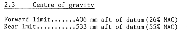

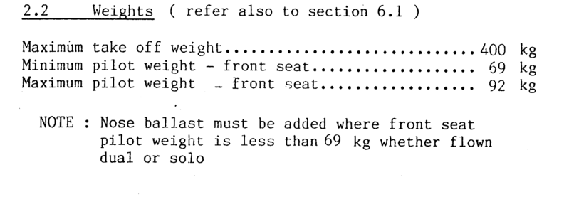

M61A1 Posted January 15, 2014 Share Posted January 15, 2014 Cut and paste from the SB582 book. FLIGHT CREW AND PASSENGER LIMITS Minimum flight crew One pilot Command seat Front seat Maximum permissible number of persons on board. 2 Minimum load front seat 65 kg Maximum load front seat 95 kg And from the A503- The CoG figure are not right as well, 533mm is not 55% MAC, it's around 33%. Most Drifters fly better with a bit more weight up front. Dunno what's the go with the bold, I turn it off and it comes back as soon as I type. Link to comment Share on other sites More sharing options...

shafs64 Posted January 15, 2014 Author Share Posted January 15, 2014 So if the front seat pilots weights say 125 kg. it could be way forward of the COG? what is the empty weight of a drifter. Cut and paste from the SB582 book.FLIGHT CREW AND PASSENGER LIMITS Minimum flight crew One pilot Command seat Front seat Maximum permissible number of persons on board. 2 Minimum load front seat 65 kg Maximum load front seat 95 kg And from the A503- [ATTACH=full]26880[/ATTACH] The CoG figure are not right as well, 533mm is not 55% MAC, it's around 33%. Most Drifters fly better with a bit more weight up front. Dunno what's the go with the bold, I turn it off and it comes back as soon as I type. [ATTACH=full]26881[/ATTACH] Link to comment Share on other sites More sharing options...
