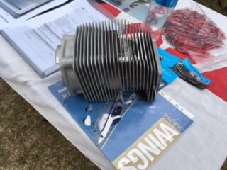

jetjr Posted October 9, 2016 Share Posted October 9, 2016 Don't like the sound of having to remove barrels every time there's a valve issue. Being able to swap a head out or send for repair was a nice feature Without CAE parts things look pretty grim for all owners of current engines 1 1 Link to comment Share on other sites More sharing options...

Oscar Posted October 9, 2016 Share Posted October 9, 2016 Don't like the sound of having to remove barrels every time there's a valve issue. Being able to swap a head out or send for repair was a nice featureWithout CAE parts things look pretty grim for all owners of current engines And removing barrels disturbs the crankcase seal. IF Jabiru uses the same Loctite seal methodology for the crankcases as in the present engines, this will prove to be a major problem, with seal breaking and crankcase fretting, and consequent loss of pre-tension on the through bolts - which now also hold the heads on, with four rather than five point attachment ( the earlier development 2210 engines needed several additional head bolts to maintain head sealing). .. CAMit moved to a different crankcase seal technique over three years ago. 1 Link to comment Share on other sites More sharing options...

bexrbetter Posted October 9, 2016 Share Posted October 9, 2016 Yes but that's a whole new design, this one is new materials on existing design so not only retains certification but should be lots of problems already found. How the hell can you change materials and new techniques such as nikasil bores and now casting, and retain certification? You'll have to excuse me for calling nonsense on that one. 1 Link to comment Share on other sites More sharing options...

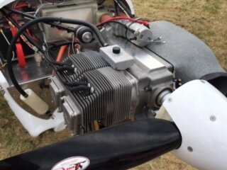

bexrbetter Posted October 9, 2016 Share Posted October 9, 2016 Most talk was about the new engines with parts coming from elsewhere, but fact is they arent real yet You may be right but damn, those parts pictured sure look final spec and out of production dies to me. 2 Link to comment Share on other sites More sharing options...

jetjr Posted October 9, 2016 Share Posted October 9, 2016 It would be the same parts, Jab have been slowly replacing CAE parts for a while Jabiru complain about bitzer modified engines and if Camit aren't supplying anymore almost all will be except newest ones Yes they did look final and well done, hard part is anyone buying a new engine will now wait. From what was said I got the impression there are only one of these engines ever built and running. One pictured for just a few hrs. Long way to go in my eyes. Some parts have done more. Link to comment Share on other sites More sharing options...

jetjr Posted October 9, 2016 Share Posted October 9, 2016 I was at a meeting a few weeks back where rod stiff spoke about the new engines and he said the new engine or one of the new engines had been on a test bed run at full revs for 3 days non stop ( except for refuels and stops to do the required maintenance due to the hours clocking up) and another ( or perhaps same one at different time I don't recall which) had several hundred hours in flight in an airframe. Several staff had sore butts from flying all day every day! yes correct but theres several versions of the "new" 2210 engine, one in aircraft has machined case and ran a couple of versions of bolted heads for some time, Done 300hrs total I think over couple of years now. Not sure what version the one test cell has, assume its latest cast block with cast, screwed heads. - but its done 1000hrs as you indicate Other in aircraft at Narromine had around 10 hrs at the time. Link to comment Share on other sites More sharing options...
