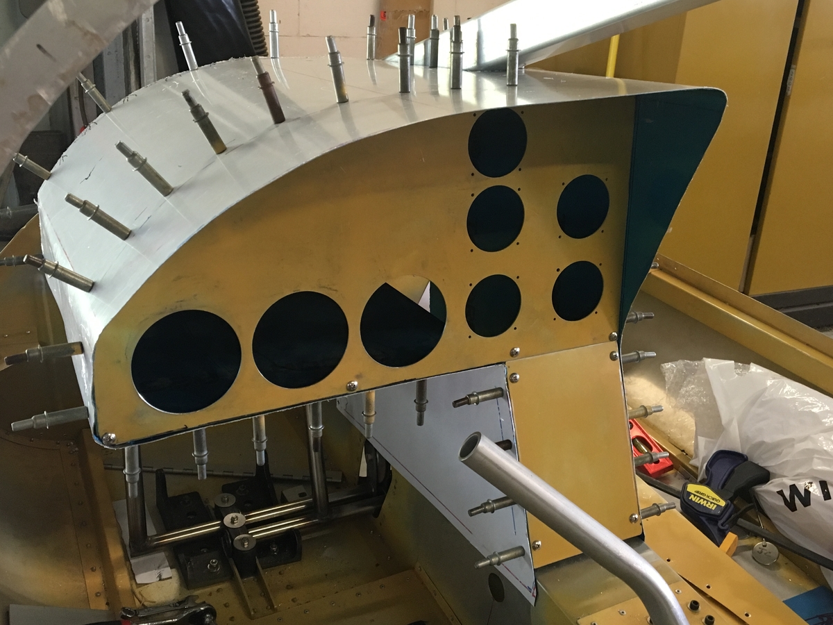

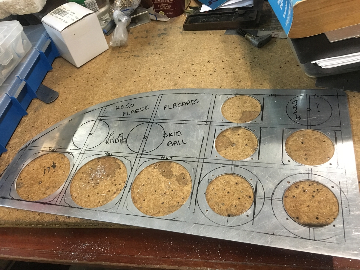

planet47 Posted December 22, 2018 Author Share Posted December 22, 2018 Here we have the beginnings of my instrument panel with abit of work to go yet and a few instruments. 4 1 Link to comment Share on other sites More sharing options...

planet47 Posted April 13, 2019 Author Share Posted April 13, 2019 Thank you HITC for your response. Is the polisher shaped like an angle grinder usable on 6061? I was having a look at various types of polishers in a shop today and I was very unsure of where to go with it for several reasons. I just wanted to play with this as a finish on different parts of the project if not all of it and then again I may not go for this finish in the end anyway. I just want to experiment with it and see if it is viable. Another question concerns the use of some sort of reflective dulling material around the outside of the instrument panel (pictures above). The plastic is off it and I have riveted it together and the only clecos remaining are along the very bottom where it joins the tunnel. Link to comment Share on other sites More sharing options...
Marty_d Posted April 13, 2019 Share Posted April 13, 2019 Couldn't you use a matt paint on the outside of the instrument panel? Link to comment Share on other sites More sharing options...

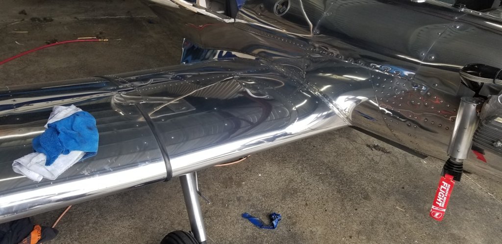

spacesailor Posted June 25, 2019 Share Posted June 25, 2019 Polishing becomes a Addiction !. "cleaning my plane finally.. wanted to do it after my flight... but my head was about to pop... as I clean the bugs off and the 4 million fingerprints of my shiny bird... i start seeing the need for more polishing... damn... my eye is starting to twitch and im fighting the urge to get the polisher out.. omg..." spacesailor 2 Link to comment Share on other sites More sharing options...

pmccarthy Posted June 25, 2019 Share Posted June 25, 2019 Polishing becomes a Addiction !. [ATTACH type=full" alt="PolishedHummel.jpg]43759[/ATTACH][ATTACH alt=PolishedHummel.jpg]43759[/ATTACH] "cleaning my plane finally.. wanted to do it after my flight... but my head was about to pop... as I clean the bugs off and the 4 million fingerprints of my shiny bird... i start seeing the need for more polishing... damn... my eye is starting to twitch and im fighting the urge to get the polisher out.. omg..." spacesailor That’s beautiful. Link to comment Share on other sites More sharing options...
Blueadventures Posted June 25, 2019 Share Posted June 25, 2019 Polishing becomes a Addiction !. [ATTACH type=full" alt="PolishedHummel.jpg]43759[/ATTACH][ATTACH alt=PolishedHummel.jpg]43759[/ATTACH] "cleaning my plane finally.. wanted to do it after my flight... but my head was about to pop... as I clean the bugs off and the 4 million fingerprints of my shiny bird... i start seeing the need for more polishing... damn... my eye is starting to twitch and im fighting the urge to get the polisher out.. omg..." spacesailor With most people running away it looks like they heard there is more polishing to be done soon? Link to comment Share on other sites More sharing options...
