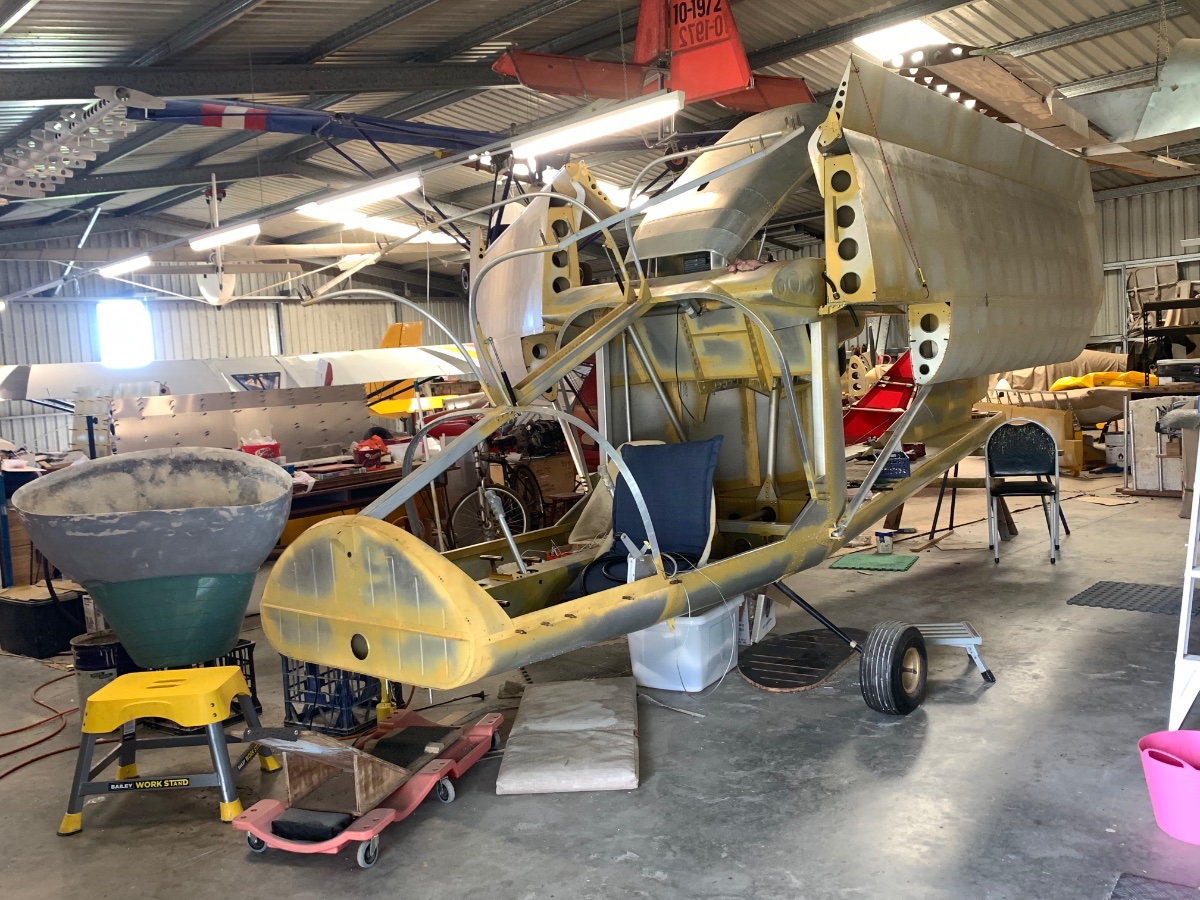

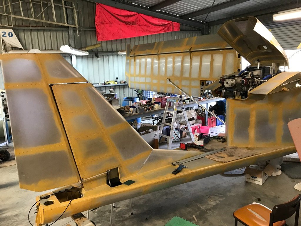

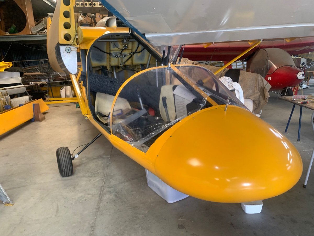

Garfly Posted December 19, 2022 Share Posted December 19, 2022 For another perspective on the weekend's activity, here's Planet's airplane-to-be with its speed brakes deployed. ;- ) For a demonstration of the folding concept here's a video of the aircraft's designer - our Pylon500 - showing how it's done. Arthur folds wing.m4v (Meanwhile, planet47 - who's happy to remain anonymous - took a break from riveting this weekend to polish up the nose cone.) And, oh yeah, it does have an engine. It should be a riveting Xmas! 6 1 Link to comment Share on other sites More sharing options...

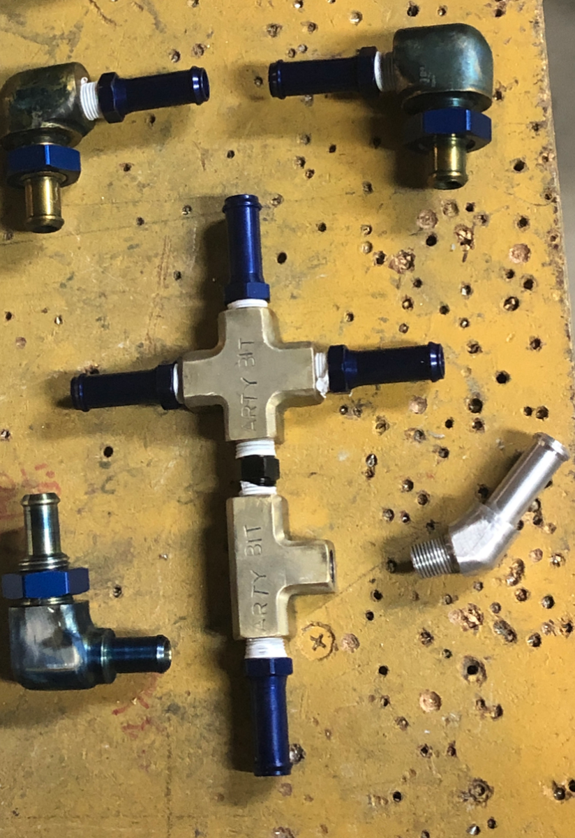

pylon500 Posted December 19, 2022 Share Posted December 19, 2022 (edited) 'Gravity feed...' I used to remember the old two stroke diaphragm pumps could pull fuel up about two feet (at least), in our situation the tanks are about level with the carbi's (they would be above during climb), so I'm assuming the 912 mechanical pump should maintain pressure to the carbi's as a 'level' system. My biggest concern was exposing the fuel pickups in the tanks when the wings are folded, so I've got a slightly more complex fuel system than just a line to the engine. Tank fuel will come into the side tubes and will have to flow down to the T branch where it will then feed to the engine. the lower tube will go to a below fuselage drain point, and the top tube goes to a 'purge' pump, that will scavenge all bubbles in the lines and pump it back to one of the tanks. That's the theory anyway, was initially going to use a header tank, but figured the lines were enough volume to do the job. Made many of my own bits and saved around $200 (if I don't count my time). Edited December 19, 2022 by pylon500 2 1 Link to comment Share on other sites More sharing options...

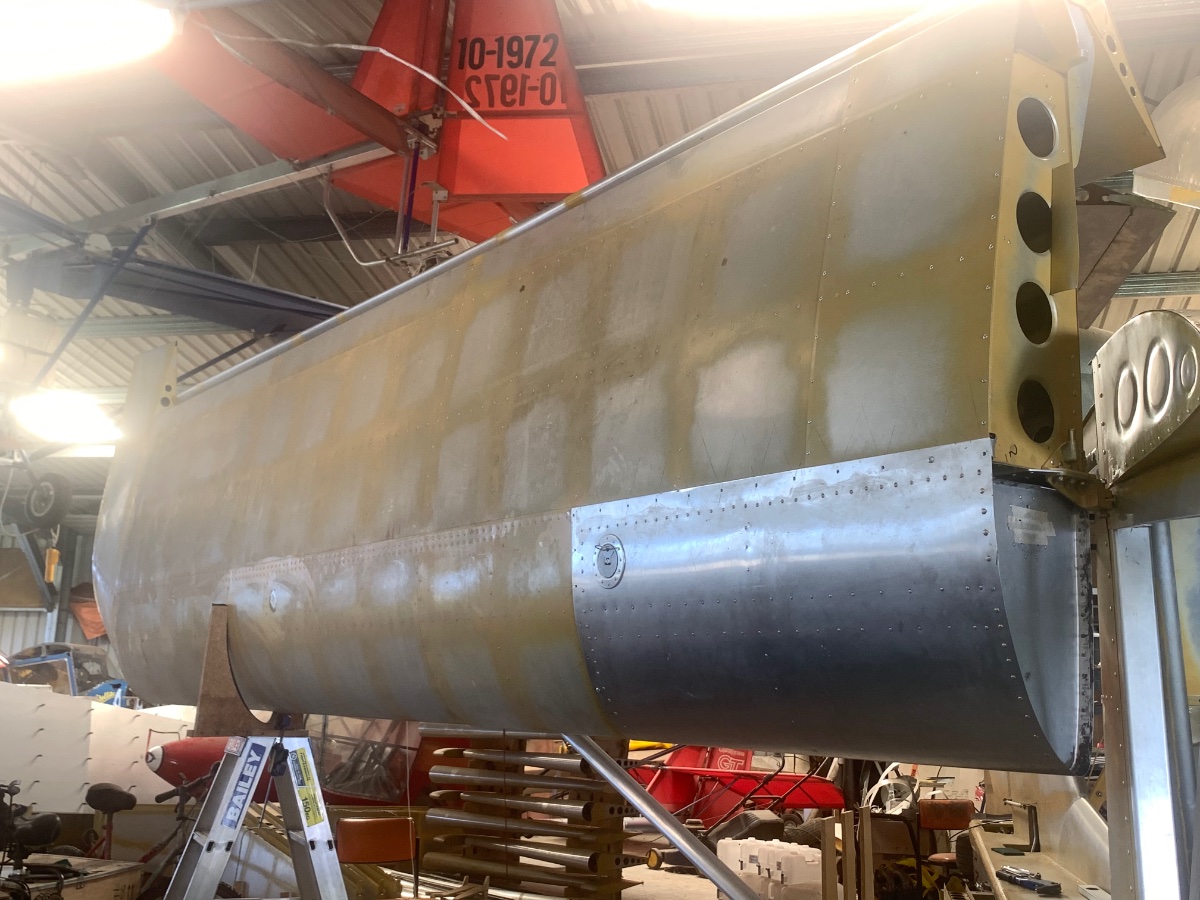

planet47 Posted January 8, 2023 Author Share Posted January 8, 2023 A wing that has its fuel tank for the first of many times 3 2 Link to comment Share on other sites More sharing options...
