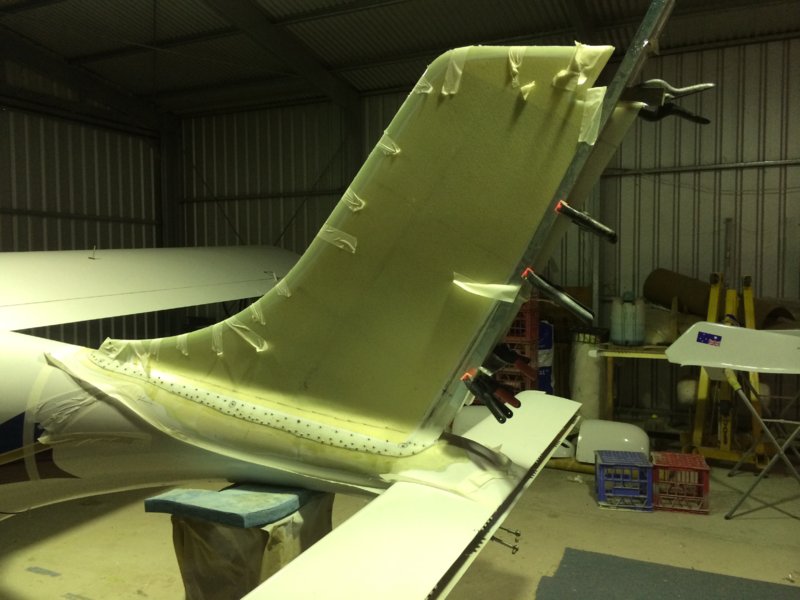

I got the dreaded flu that lasted for 6 weeks and then at Xmas igot another does , on top of a long hot summer in the flinders, and then I decided to make another v/stab , and now I'm ready again to hit the sky's ,

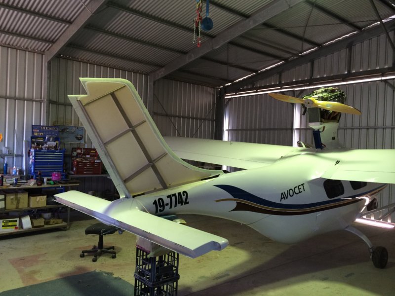

help . I had fun building the the new v/stab onto the existing fin post , but all came good . used the moulds to jig everything in place .
cheers.image.jpg.49f20bab67951705369ec0e842ba0c6d.jpg.

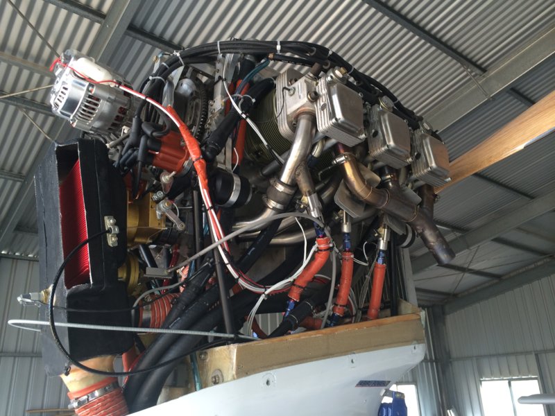

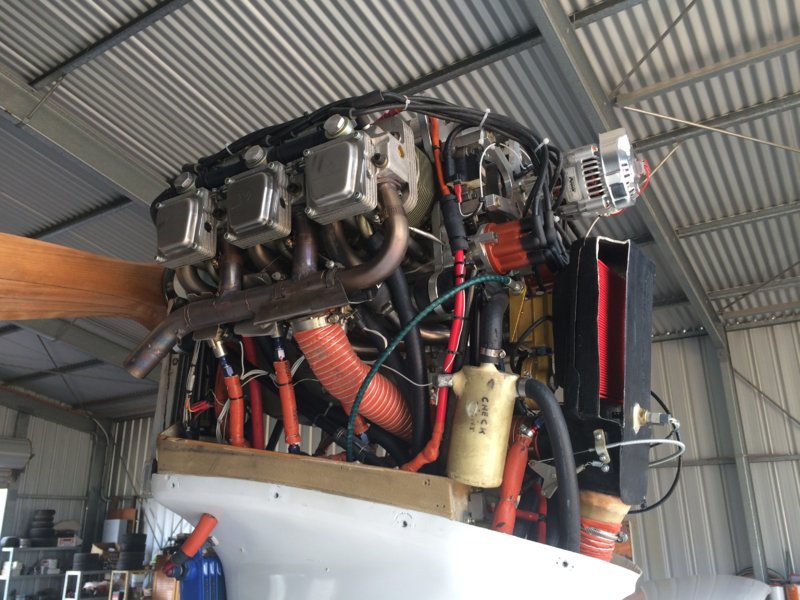

Hi there Avocet, I'm keen to hear how the injected, liquid cooled head jab 3300 is performing. I think you could be on a winner there. What sort of prop and pitch etc?
the LCH& the multipoint work exceptionally good combined
with 62"x54" pitch prop.
it's a much smoother running & idl.,a good temp. spread and a oil temp thermostat keeps the oil at 80 deg
heads /water temp 95/100deg. works we'll on the pusher set up .
cheers mike
  • Winner 1
Looks great, very inspiring, I might start with the SDS injection and go from there:chuffed:
if you add the LCH to the SDS the extra current load with the water pump ect , ,7ampdraw, required a 30amp alt (on vac pump drive) .weight starts to creep up .
cheers mike
  • Helpful 1
That jab modified might do the job but it's starting to look like a Plumber's nightmare. Nev
The plumbers nightmare (my nightmare by the way ) is being redesigned as we speak ,
T he Crome Molly mount will go all the way down to the roof ,and the turret cowls will screw off , making better access . another big mod !!
you know , rod stiff told me , it never ends. !!!
Mike
