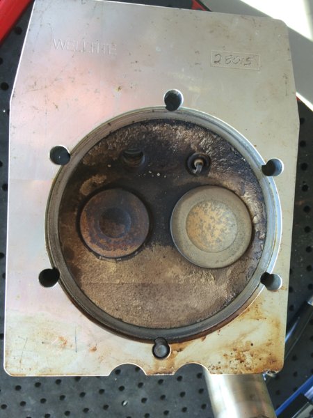

01rmb Posted June 9, 2014 Share Posted June 9, 2014 As discussed earlier in post Is there something wrong with the way the Jabiru engines are being operated which is exasperating the premature failure of the engines? After 300 hours - running mostly Avgas the pressure leak test was down in the 40's on 2 cylinders but worse it was picked up that there was leakage past the exhaust valves on at least one of the cylinders necessitating removing the heads for inspection. I have attached a photo showing the level of buildup from the lead fouling that was found before being cleaned up. The lead buildup had started to affect the exhaust valve sealing (small valve) and then the valve started to get burnt which you can see at the point closest to the spark plug. What you can't see is that on the underside of the valve there is a small hole being burnt through leading to low cylinder pressure and combustion into the exhaust. Eventually the leak will lead to the valve stem being burnt through and the valve head falling into the engine. Fall flat, the engine may at least run, fall at an angle and the piston impacts the valve head and leaves pieces of piston in the sump along with a pretzel of a piston connecting rod and more loose pieces of metal in the engine. But basically, if it happened when you were in the air, you will be landing rather quicker than intended. Following inspection of my engine the LAME advised that it would not have lasted the next 20 hours. The LAME removed all heads, gave them a thorough cleanup and replaced all valves and springs (cheap parts so not worth mucking around). Good as new and will easily last until the scheduled overhaul time. The consensus is that the problem is totally related to running avgas and the resulting lead fouling. Some running conditions (with longer idle times resulting in cooler combustion temperatures) will expedite the level of buildup and decrease the time to problems occurring. Two aircraft I know that are doing 20-25 hours per week each in typical ad initio training were having all sorts of problems with the engines including 2 near forced landings when running on avgas - After switching to premium mogas there have been no problems. Good enough evidence that following my own problem that I will only run premium mogas. Importantly - Do your preflight checks and at any sign of poor compression, leaking gas into the exhaust or rough running have a mechanic check the engine before the wheels leave the ground. If running avgas maybe it is worth inspecting the exhaust valves much earlier than scheduled maintenance advises if your running conditions may lead to greater lead fouling potential. 1 2 4 Link to comment Share on other sites More sharing options...
frank marriott Posted June 9, 2014 Share Posted June 9, 2014 O1rmb I run avgas (all the time) but do a leakdown each 50hr service and pop the head and reseat the valves on any head that is down i.e. if not better then 60/80. (500hrs) 1 1 Link to comment Share on other sites More sharing options...
01rmb Posted June 9, 2014 Share Posted June 9, 2014 O1rmbI run avgas (all the time) but do a leakdown each 50hr service and pop the head and reseat the valves on any head that is down i.e. if not better then 60/80. (500hrs) And 50 hours ago the worse cylinder was 72/80... So good advice but worth caution because this engine was not going to do another 20 hours! 1 1 Link to comment Share on other sites More sharing options...
facthunter Posted June 9, 2014 Share Posted June 9, 2014 It is more common to have this effect with the Rotax 912's as they run too cool for 100LL. They usually recover after a few tanks of mogas but you cannot be sure some valve or seat damage won't be done in the meantime. There is a fair amount of lead in 100LL so a shandy might be preferred. You need higher octane with the aircooled motors because of the higher temps as a general rule. Jabiru recommend avgas, but a lot of taxiing and being s bit rich at low revs may cause extra problems. Nev Link to comment Share on other sites More sharing options...

AVOCET Posted July 4, 2014 Share Posted July 4, 2014 w As discussed earlier in post After 300 hours - running mostly Avgas the pressure leak test was down in the 40's on 2 cylinders but worse it was picked up that there was leakage past the exhaust valves on at least one of the cylinders necessitating removing the heads for inspection. I have attached a photo showing the level of buildup from the lead fouling that was found before being cleaned up. [ATTACH]29303[/ATTACH] The lead buildup had started to affect the exhaust valve sealing (small valve) and then the valve started to get burnt which you can see at the point closest to the spark plug. What you can't see is that on the underside of the valve there is a small hole being burnt through leading to low cylinder pressure and combustion into the exhaust. Eventually the leak will lead to the valve stem being burnt through and the valve head falling into the engine. Fall flat, the engine may at least run, fall at an angle and the piston impacts the valve head and leaves pieces of piston in the sump along with a pretzel of a piston connecting rod and more loose pieces of metal in the engine. But basically, if it happened when you were in the air, you will be landing rather quicker than intended. Following inspection of my engine the LAME advised that it would not have lasted the next 20 hours. The LAME removed all heads, gave them a thorough cleanup and replaced all valves and springs (cheap parts so not worth mucking around). Good as new and will easily last until the scheduled overhaul time. The consensus is that the problem is totally related to running avgas and the resulting lead fouling. Some running conditions (with longer idle times resulting in cooler combustion temperatures) will expedite the level of buildup and decrease the time to problems occurring. Two aircraft I know that are doing 20-25 hours per week each in typical ad initio training were having all sorts of problems with the engines including 2 near forced landings when running on avgas - After switching to premium mogas there have been no problems. Good enough evidence that following my own problem that I will only run premium mogas. Importantly - Do your preflight checks and at any sign of poor compression, leaking gas into the exhaust or rough running have a mechanic check the engine before the wheels leave the ground. If running avgas maybe it is worth inspecting the exhaust valves much earlier than scheduled maintenance advises if your running conditions may lead to greater lead fouling potential. what sort of Mogas are you using ? 98 or 95 ? as I'm running LCH , so cooler heads . I've had issues with mogas 98 softening fuel lines because of aromatics . mike. Link to comment Share on other sites More sharing options...
