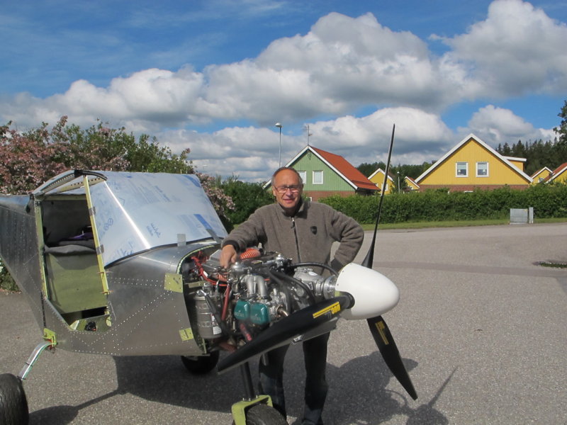

Hasse Posted June 24, 2014 Author Share Posted June 24, 2014 Hi guys, I just want you to know that I started the Engine today - for the first time. All went OK but as I had mounted the mag switches upside down it took some time before I realised my mistake. Not easy to get the Engine running with mags in off position :-). Apart from that all motor instruments looked ok but it seems that I have a small leakage in the "spider" connection for the fuel. This is strange as I was quite careful to add glue on the threads (or whatever you call it) to get it tight. Anyone who recognise this kind of leakage? I posted a picture o a happy builder. Hasse 4 Link to comment Share on other sites More sharing options...

rankamateur Posted June 24, 2014 Share Posted June 24, 2014 but it seems that I have a small leakage in the "spider" connection for the fuel. This is strange as I was quite careful to add glue on the threads (or whatever you call it) to get it tight.Anyone who recognise this kind of leakage? Don't feel too special, you are not alone, it' s a bit of a lottery. Startade du motorn utan mig! It's obviously a private intimate moment, not to be share, like carrying her across the threashold! 1 Link to comment Share on other sites More sharing options...
Hasse Posted June 25, 2014 Author Share Posted June 25, 2014 I actually know "Hasse" ive been to his place a few times and we have been talking allot. Startade du motorn utan mig! (Did you start the engine without me!) Congratulations, myself ive decided on the D-Motor and is pulling the wires for it now. Sorry Dennis! Couldn't keep away from the Engine. Some kind of magnetic itch :-) Anyway, the chinese version of Scotch brite has arrieved. Thanks. But you know Dennis, the amount you ordered for me is enough to clean a fleet of B-757. So, you've decided on the D-motor. Was it the weight, efficiency, reliability or cost that made you to take the D-motor and not the Rotax? See you soon Hasse Link to comment Share on other sites More sharing options...
