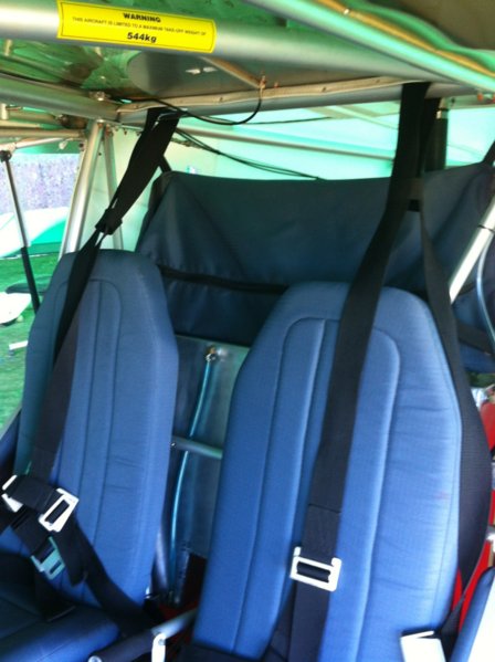

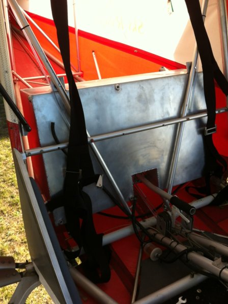

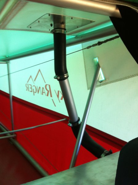

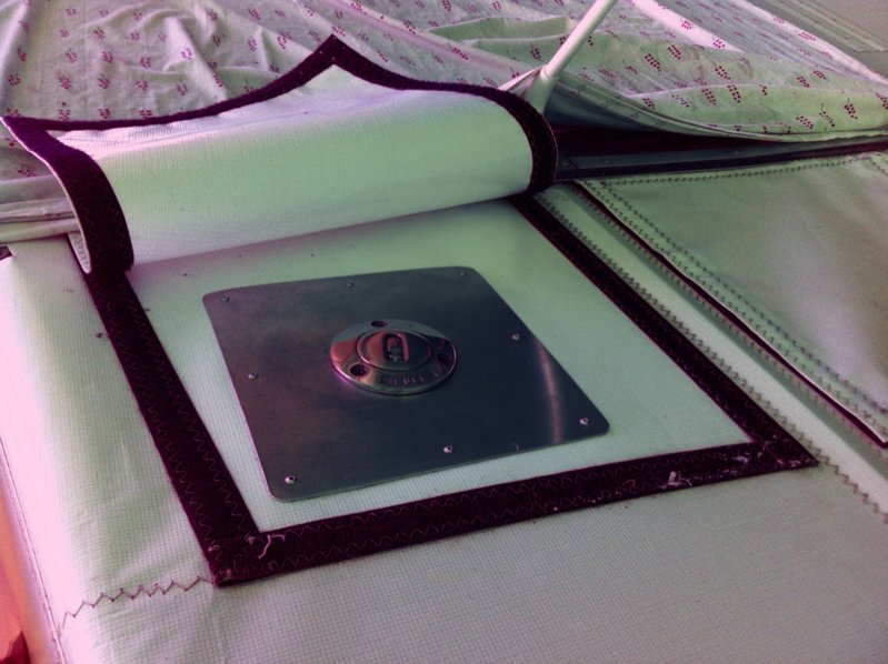

Garfly Posted July 17, 2014 Share Posted July 17, 2014 Here are some pics of the 90L (24 US gal.) installed in my Swift last year by the previous owner. It's the more recent and lighter aluminium tank referred to by Greg (in #12 above). You can see that the luggage bag can still hang above it. But you can also see that under certain load configs you could run out of rear CG before you run out of MTOW. It's in that light that I understood Greg's suggestion that wing-tanks might mean you're able to haul more luggage (apart from having more space for it). I have seen pictures of European installations where the filler cap exits the side wall which may be more convenient still. I wonder how the filler caps will be set up for the wing tanks. It's certainly a fascinating development. 1 Link to post Share on other sites

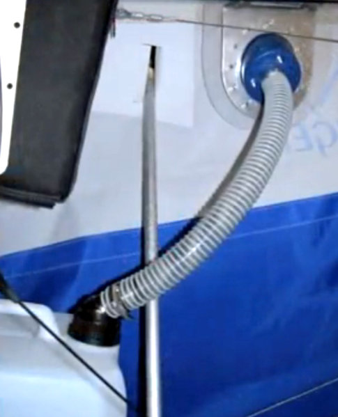

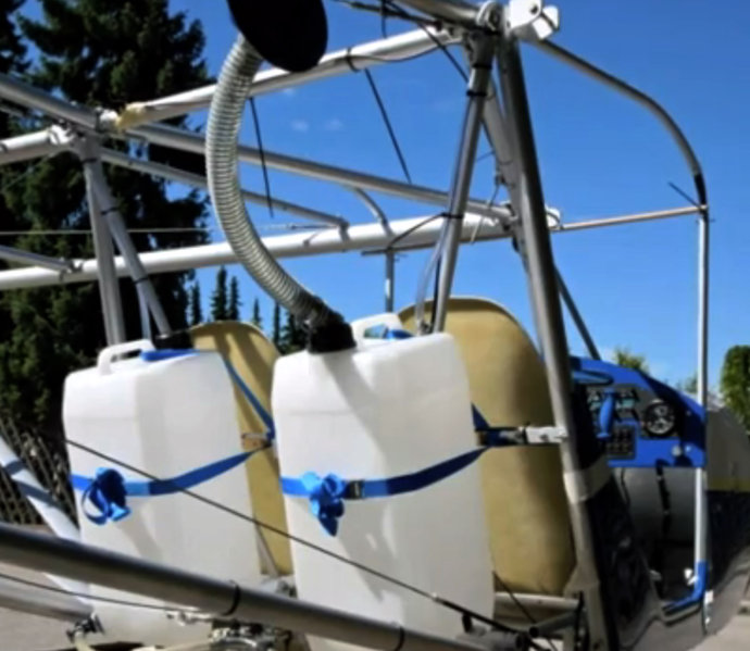

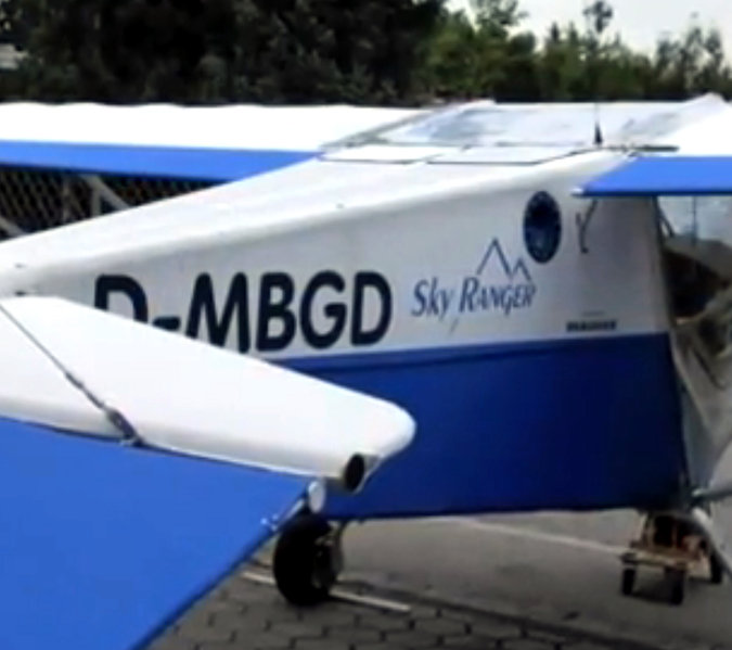

Garfly Posted July 17, 2014 Share Posted July 17, 2014 Here is a video from Germany of that Swift build which incorporates the the side fuel-filler (into the two plastic tanks). If you watch the vid you'll see that this one has the ballistic recovery parachute (mandatory in parts of Europe) taking up half the space the full-size luggage bag uses. (The rocket aims upwards and fires through the flap of fabric above the parachute.) Which points to another advantage of the wing tanks, I guess - you can have your 'chute and baggage too. Link to post Share on other sites

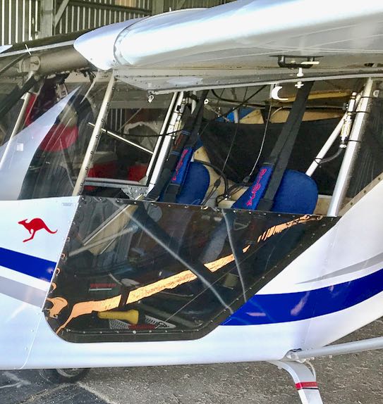

Blueadventures Posted December 28, 2017 Share Posted December 28, 2017 Anyone fitted higher backed seats? Hi I have the moulded fibre glass seats in the Nynja and they are comfortable. Longest flight 4.25 hours to date. They have a padded seat cover on them. You cab see the height of the back in the image. There will be more images on the BestOff sites. Cheers 1 1 Link to post Share on other sites

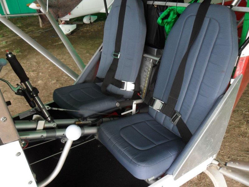

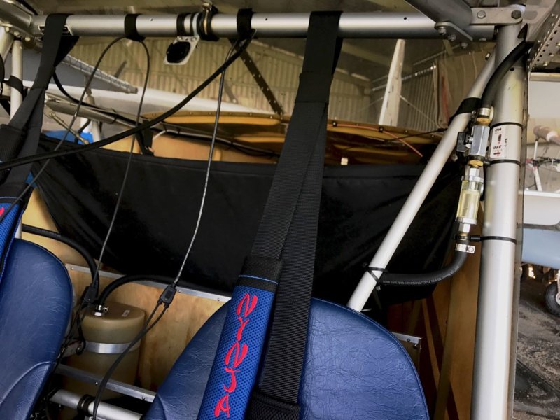

Garfly Posted December 28, 2017 Share Posted December 28, 2017 Here are a couple more glimpses of your Ninja seats, Mike. (Though taken to show bits of your header-tank/wing-tank arrangement ;-) And these are the standard old Skyranger seats. 1 1 Link to post Share on other sites
