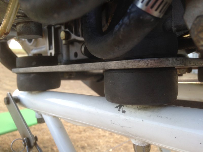

sandman Posted August 14, 2014 Share Posted August 14, 2014 Just had a L2 replace my engine mounts on my 582 drifter with repco engine mounts ( Black Rubber ). With these new mounts there appears to be a noticeable vibration through the pod only at idle 2200-2600 rpm. I was told that these were the original mounts for the drifter. Can anyone give me more info on theses mounts please. I'm hoping the mounts will settle down after awhile and the idle vibs might disappear. Cheers. Link to comment Share on other sites More sharing options...

sandman Posted December 1, 2014 Author Share Posted December 1, 2014 I have just replaced this set up with different engine mounts and vibration has pretty well disappeared, shes back like the old engines I had on it, I'm very happy with it now. Link to comment Share on other sites More sharing options...

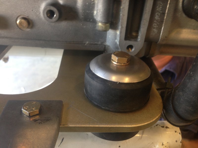

sandman Posted December 10, 2014 Author Share Posted December 10, 2014 Link to comment Share on other sites More sharing options...
Tex Posted December 10, 2014 Share Posted December 10, 2014 Where did they come from Sandman? Link to comment Share on other sites More sharing options...
sandman Posted December 10, 2014 Author Share Posted December 10, 2014 Cannot remember right now but I have a set of neoprene drifter mounts brand new if you know of anyone needing some. Link to comment Share on other sites More sharing options...
Tex Posted December 10, 2014 Share Posted December 10, 2014 The same as those you now have fitted or are they the ones you took off? Link to comment Share on other sites More sharing options...
sandman Posted December 11, 2014 Author Share Posted December 11, 2014 These are yellow neoprene form Richard Eacott. Link to comment Share on other sites More sharing options...
