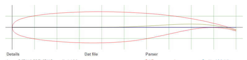

I like those SC wings; the lower, curved surface would be a big advantage in outback conditions when you were landing in thick heath or even gidgee because the curved surface would push through better, keeping the nose up.

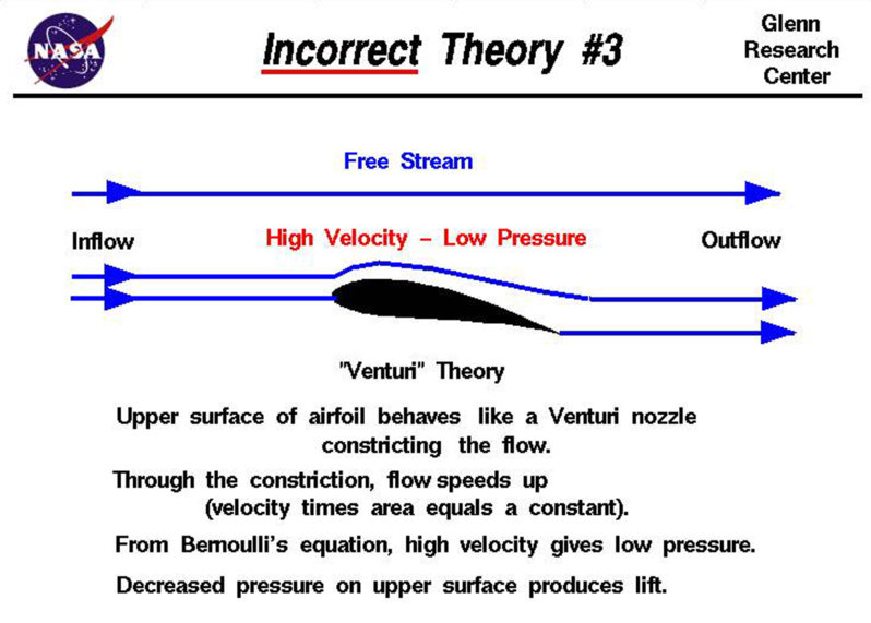

My point is that those people teaching pseudo Bernoulli principles like 'the wing is a venturi, and equal transit time don't know their stuff.
I totally agree but CASA's Part 61 MOS states, for CPL (it is not in BAK for RPL):
Apply Bernoulli’s theorem of constant energy flow to describe how an aerofoil produces lift, limited to the variation of kinetic energy (dynamic pressure) and potential energy (static pressure) as air flows through a venturi or over a aerofoil.
and that is now the law. The time to have that argument was when the MOS was a draft at the NPRM stage with CASA.
I totally agree but CASA's Part 61 MOS states, for CPL (it is not in BAK for RPL): and that is now the law. The time to have that argument was when the MOS was a draft at the NPRM stage with CASA.
Who was it once that said the law is an ass?
What kind of credibility does CASA have left anyway?More so when they are promoting myths.
See the NASA image attached. The venturi myth is simple rubbish because once you cut the top off a venturi it is not a closed system any more, so the conservation of energy is invalid...
As soon as they appoint a new director I will be writing to them. CLARC doesn't listen. This is just embarrassing...
