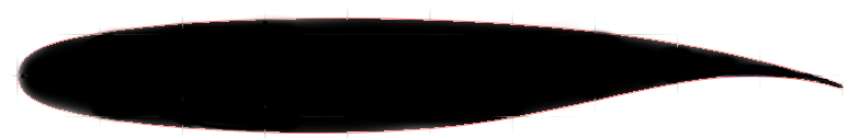

SC wings in fact were designed in the 1960s by NASA scientist Richard Whitcomb (who also gave us winglets).
The SC wing is designed to minimise the angular change of flow over the upper surface of the wing thus reducing density changes that happen when the air ‘turns the corner’ of the leading edge. Density is directly related to the speed of sound so when density drops, the local speed of sound drops causing standing shock waves. This is the basis of MMO and MCrit.
As all airliners cruise in the transonic range (above M 0.8) this reduces drag and much improves efficiency.

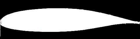

In terms of light aircraft using wings with SC characteristics again Mr Planner you are quite wrong.
Attached is the wing profile of a Piper Tomahawk (not even a new aircraft)
Many performance LSA aircraft are now using symmetrical or SC style aerofoils as a drag reduction measure just as the P-51 (close to symmetrical did many years. The Canberra has a symmetrical wing so when you try to explain bogus theories about wings flying because they curved upper surfaces and flat undersides, they are proven to be nonsense. Either a physical principle fits all of the criteria in all normal examples or it is bunk.
