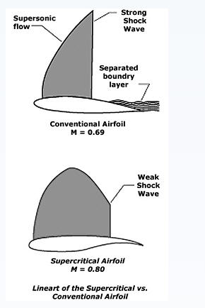

turboplanner Posted September 15, 2014 Share Posted September 15, 2014 I still don't understand your point here. He says that from what they are taught, people expect that a wing curved on the bottom and flat on the top would produce a down force not lift. And yet that is not the case for SC wings. I'm not sure whether you are agreeing or disagreeing? A wing curved on the bottom and flat on the top produces a downforce, as in the Sprintcar wing - the teaching is correct. I'm saying his description is incorrect. A Supercritical Wing is a complex shape and not just flat on the top and curved on the bottom. A Supercritical Wing does camber on the top, just a lesser amount than a conventional aerofoil, and its complex shape underneath is designed to offset the lesser camber by creating more downforce. I've attached a diagramme comparison of a conventional aerofoil and supercritical aerofoil from the NASA website. Link to comment Share on other sites More sharing options...
completeaerogeek Posted September 15, 2014 Author Share Posted September 15, 2014 Sorry didn't mean to overstate my point but if you see his latest clanger he says that sprint car wings have nothing to do with airliners... Absolute classic! Apart from using exactly the same principle of turning flow, being able to calculate their relative 'downforce' in exactly the same way and the fact that they are just an aerofoil turning the airflow to create a reaction force... Well nothing at all I suppose... Link to comment Share on other sites More sharing options...
aro Posted September 15, 2014 Share Posted September 15, 2014 Sprint car wings have nothing to do with an airliner? That is priceless!!!!! IS there some alternate physics theory from your Universe you would like to share? I said sprintcar wings have nothing to do with an airliner. Probably what I should have said is that sprint car wings are curved on the bottom for a totally different reason than the wings on an airliner. Link to comment Share on other sites More sharing options...
2tonne Posted September 15, 2014 Share Posted September 15, 2014 Remind me not to visit your home village they seem to be missing their idiot. Perhaps its time to go home. I love comments like this - takes me back to the geeks at my school battling it out in the playground:laugh:. Oh, and I wasn't one of them ok. 1 1 1 Link to comment Share on other sites More sharing options...

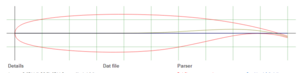

completeaerogeek Posted September 15, 2014 Author Share Posted September 15, 2014 A wing curved on the bottom and flat on the top produces a downforce, as in the Sprintcar wing - the teaching is correct.I'm saying his description is incorrect. A Supercritical Wing is a complex shape and not just flat on the top and curved on the bottom. A Supercritical Wing does camber on the top, just a lesser amount than a conventional aerofoil, and its complex shape underneath is designed to offset the lesser camber by creating more downforce. I've attached a diagramme comparison of a conventional aerofoil and supercritical aerofoil from the NASA website. _______________- Geez you really are scrambling now aren't you? It s a long time since I have seen someone backpedalling that fast. They work EXACTLY the same way. It is irrelevant which way the flow is turned. They perform the SAME FUNCTION using the same principles. Time to quit while you are behind..... Link to comment Share on other sites More sharing options...
completeaerogeek Posted September 15, 2014 Author Share Posted September 15, 2014 I said sprintcar wings have nothing to do with an airliner. Probably what I should have said is that sprint car wings are curved on the bottom for a totally different reason than the wings on an airliner. _______________- How can I make this any clearer. IT IS EXACTLY THE SAME PHYSICAL PRINCIPLE AND THE CURVED SHAPES PERFORM EXACTLY THE SAME FUNCTION. They change the direction of the air to suit whatever purpose is intended... Link to comment Share on other sites More sharing options...
aro Posted September 15, 2014 Share Posted September 15, 2014 I'm saying his description is incorrect. A Supercritical Wing is a complex shape and not just flat on the top and curved on the bottom. Flat on the top is an approximation. So is flat on the bottom for a conventional airfoil. There is more curvature on the bottom of the SC airfoil. If you measure the distance along the surface from LE to TE it is further on the bottom - which is a problem for the equal transit time theory. But I thought we had agreed that the equal transit time theory doesn't hold water? Link to comment Share on other sites More sharing options...
turboplanner Posted September 15, 2014 Share Posted September 15, 2014 Well since I'm just a poor country boy who had to leave school at the age of 26 to help out on the farm perhaps you could explain why this would be so classic, GIVEN your description, which you now appear to be correcting? In particular a Sprintcar with an upside down aerofoil to your description, and I quoted it precisely - where the resulting effect is DOWN. An airliner, which has a supercritical wing flies because the resulting effect is UP I suppose there could be some airliners fitted with upside down aerofoils, but I've never seen one, and that was the context of my comment that Sprintcar wings have nothing to do with airliners, rather than an attempt to provide another start to the endless belt of your assumption that "they are just an aerofoil turning the airflow to create a reaction force", minus Bernoulli once again, of course. 1 Link to comment Share on other sites More sharing options...
aro Posted September 15, 2014 Share Posted September 15, 2014 How can I make this any clearer. IT IS EXACTLY THE SAME PHYSICAL PRINCIPLE AND THE CURVED SHAPES PERFORM EXACTLY THE SAME FUNCTION.They change the direction of the air to suit whatever purpose is intended... Settle down, I agree with you. All I was trying to say is that I don't understand the point that was being made in the original reference to sprintcar wings. Link to comment Share on other sites More sharing options...

turboplanner Posted September 15, 2014 Share Posted September 15, 2014 Flat on the top is an approximation. So is flat on the bottom for a conventional airfoil.There is more curvature on the bottom of the SC airfoil. If you measure the distance along the surface from LE to TE it is further on the bottom - which is a problem for the equal transit time theory. But I thought we had agreed that the equal transit time theory doesn't hold water? Well most of us do, but I think the geek seems to be implying that there are instructors who don't. Link to comment Share on other sites More sharing options...

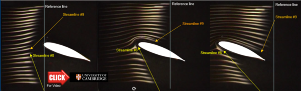

facthunter Posted September 15, 2014 Share Posted September 15, 2014 If equal transit time worked you would have no drag. You can't get something for nothing. There is no reason to believe particles which separate have any reason to get together later after passing through some processing independently. It would be a baseless assumption. For air to move through a curved path there must always be more pressure on the outside of the curve, or if you want to interpret it another way, the pressure will be lower on the inside. Nev Link to comment Share on other sites More sharing options...

aro Posted September 15, 2014 Share Posted September 15, 2014 Explaining how an aerofoil produces lisft using the variation of pressure as air flows through a venturi seems to require an incorrect application of Bernoulli, presumably equal transit time. Actually I take that back - it doesn't require it at all, since the venturi is only one surface. It just demonstrates that static pressure reduces as air speed increases - which is OK. It is the step comparing half a venturi to a wing that is incorrect - which is commonly taught. 1 Link to comment Share on other sites More sharing options...
turboplanner Posted September 15, 2014 Share Posted September 15, 2014 In fact, a venturi doesn't explain lift at all, because the air comes out the other end travelling in the same direction at the same speed, so it cannot possibly produce lift. Dafydd has just posted on the original Bernoulli thread, and that shows the bigger picture of an aerofoil rather than just Bernoulli/not Bernoulli. Link to comment Share on other sites More sharing options...
