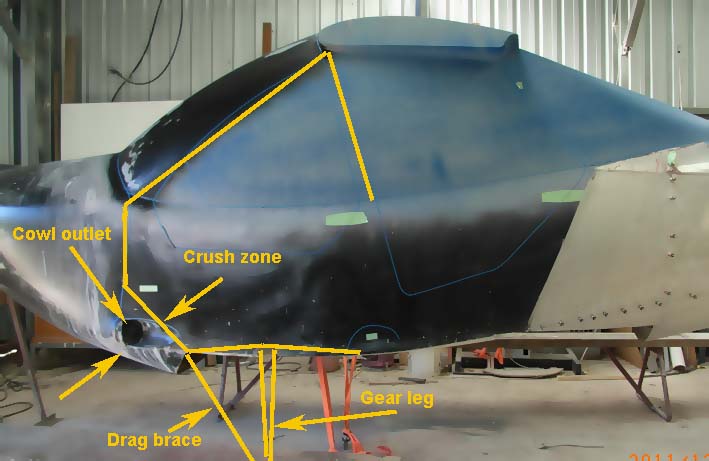

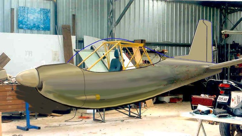

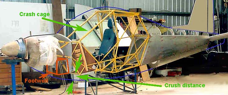

Dafydd Llewellyn Posted September 25, 2014 Author Share Posted September 25, 2014 Some of you may find the attached of interest. The third image is a photoshop drawing, but the real thing looks very much like that. It has a faired-in cargo pannier underneath the crash cage, which can (provided it's not loaded with hard objects) provide some eight inches of crush capability. The pilot's footwell also contributes to the crush capability; the rudder pedals are designed to move rearwards as it crushes, carrying the pilot's feet with them. This fuselage has the major features identified in the thread. I don't see how to achieve more than this without the design getting silly. 4 1 Link to comment Share on other sites More sharing options...
facthunter Posted September 25, 2014 Share Posted September 25, 2014 There is a practical limit to building a structure that will cover higher velocity events, with an aircraft. In flight fire is a serious event, requiring quick response and getting out after an invert or damaged structure. The seat design including restraints and the cell around the occupants is very important. The front mounted motor helps as shield to some extent when impacting less than very solid objects. Primary safety involves things like visibility handling, control/ stability, performance. and most importantly the pilot's skills and experience and attitude to safety matters. Nev 1 Link to comment Share on other sites More sharing options...
turboplanner Posted September 25, 2014 Share Posted September 25, 2014 That looks very promising Davydd, would reduce the chances of the engine/instrument panel rotating in on the occupants if it hit in a shallow dive, or his a stump while sliding along on its nose, and also reduces the chance of the rear fueselage folding up and crushing the occupants from the rear. A similar profile in a low wing would make a huge improvement in protection from upside down crush, and deformation of the canopy preventing occupants getting out in a fire. A horizontal bar connecting the front and rear of the roll cage could be used as high as possible, consistent with getting into the aircraft standing on the wing without being obstructed by the top of the roll cage. I've attached Formula 500 details because all up weight with a driver and fuel is about 400 kg and it spends its time between about 100 and 190 km/hr, so the roll cage has roughly a similar task to an RA aircraft coming in at those speeds, and the design has evolved over 40 fatality free years. Ingress from the ground is roughly the same as ingress from a low wing, but the driver does have to bend to get in and out. The splay shown on the F500 diagrammes came from older, very narrow cars where you squeezed yourself between the chassis members. These days they are parallel or wider at the bottom. In terms of weight, the heavier bars, Chrome Moly 4130 steel tube 32 mm OD x 1.6 mm wall weighs 1.19 kg/metre.While I have weighed complete frames, the figures are archived on paper at the bottom of big piles. The gusseting is based on successive crashes, and allows some parallelogramming and distortion in the crash which provides some progressive crumple. Link to comment Share on other sites More sharing options...
Dafydd Llewellyn Posted September 25, 2014 Author Share Posted September 25, 2014 That looks very promising Davydd, would reduce the chances of the engine/instrument panel rotating in on the occupants if it hit in a shallow dive, or his a stump while sliding along on its nose, and also reduces the chance of the rear fueselage folding up and crushing the occupants from the rear.A similar profile in a low wing would make a huge improvement in protection from upside down crush, and deformation of the canopy preventing occupants getting out in a fire. A horizontal bar connecting the front and rear of the roll cage could be used as high as possible, consistent with getting into the aircraft standing on the wing without being obstructed by the top of the roll cage. I've attached Formula 500 details because all up weight with a driver and fuel is about 400 kg and it spends its time between about 100 and 190 km/hr, so the roll cage has roughly a similar task to an RA aircraft coming in at those speeds, and the design has evolved over 40 fatality free years. Ingress from the ground is roughly the same as ingress from a low wing, but the driver does have to bend to get in and out. The splay shown on the F500 diagrammes came from older, very narrow cars where you squeezed yourself between the chassis members. These days they are parallel or wider at the bottom. In terms of weight, the heavier bars, Chrome Moly 4130 steel tube 32 mm OD x 1.6 mm wall weighs 1.19 kg/metre.While I have weighed complete frames, the figures are archived on paper at the bottom of big piles. The gusseting is based on successive crashes, and allows some parallelogramming and distortion in the crash which provides some progressive crumple. That crash cage of mine is actually the aircraft primary structure; it's essentially a 25G cage but it also carries the undercarriage, the engine mount, the wing and lift-strut, and the rear fuselage. The skin of it is largely removable for servicing; and since it has "stroker" seats, the control circuitry runs outside the steel frame, between it and the non-structural skin. The total weight of the yellow frame in those photos is 56 lbs. It's "fail-safe" to some extent; the analysis covers a number of single-element failures. The aircraft has two seats in tandem. The detail of the frame is not evident in those photos, but it can certainly deal with the FAR 23.561 inverted case (3 G inverted). The analysis showed that a "spider" is needed in the windscreen aperture, to minimise local bending stresses at a number of cluster joints; however it has to be made from non-magnetic material , and so is not in the photos. 2 Link to comment Share on other sites More sharing options...
facthunter Posted September 25, 2014 Share Posted September 25, 2014 Yes. the high load parts are in a compact area and a space frame is ideal. I would like to see more use of a high temp metal skin between the engine bay and the cabin too extending back and underfloor. Behind the rear seat could be a different form of construction .Nev Link to comment Share on other sites More sharing options...
Oscar Posted September 25, 2014 Share Posted September 25, 2014 What you are seeing there is a hybrid: a 'space-frame' occupant cage that connects the mainspar, u/c and engine mounts thus keeping all the highly-stressed components flying along in harmony, and an essentially monocoque rear fuselage cone that provides light-weight stiffness to the empennage. A 'glass outer skin provides aerodynamics and by being easily removable (since it is not providing structural integrity), allows remarkable access to the control runs etc. In the flesh, this is a very deep-chested aircraft - a bit like a Staffordshire Terrier by comparison to the Whippets of the small aircraft world. The 'Stroker' seat requires some of this depth, but there is also depth from an integrated pannier that contains usable load items in an entirely safe 'container' (that has low impact on c/g variation). It is the only aircraft that I've ever seen that one can easily remove a (large) outer panel and access the control runs for inspection, adjustment and maintenance. Link to comment Share on other sites More sharing options...
Dafydd Llewellyn Posted September 25, 2014 Author Share Posted September 25, 2014 Yes. the high load parts are in a compact area and a space frame is ideal. I would like to see more use of a high temp metal skin between the engine bay and the cabin too extending back and underfloor. Behind the rear seat could be a different form of construction .Nev Those photos are of the plugs for the fuselage moulds, so naturally no proper firewall in there at that stage. Yes, there will be a conventional stainless-steel firewall, extending to the lower skin, with fibrefrax backing. Attached a shot of the rear fuselage, for your interest - the sheet metal bit weighs 30 lbs. There's a vapour barrier between the pannier and the cabin. I'm not trying to sell you the aeroplane; I'm trying to illustrate how some of the secondary safety feature identified in this thread can be incorporated into the design of a small aeroplane. It's designed for certification under CS-VLA, so of course it has all the safety features demanded by that standard. Link to comment Share on other sites More sharing options...
