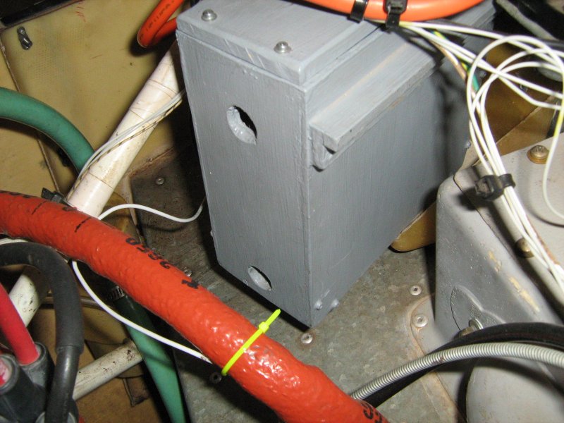

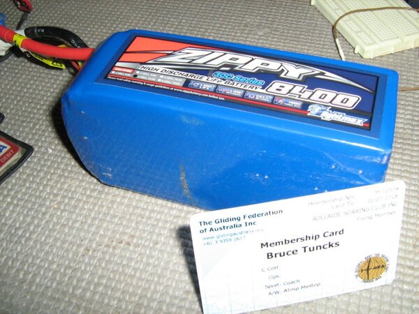

Bruce Tuncks Posted February 1, 2016 Share Posted February 1, 2016 As promised, here is a picture of my battery box. It measures 170mm wide by 170 high by 70 deep. It is made from plywood and I painted it grey to look more technical. There is actually room for 2 of the Zippy batteries inside but I only have one and some packing. The strip on the back is so that the Jabiru holding strap doesn't lift it up at the lower front. I spent time worrying about whether it should have been made from metal so as to not be flammable, but I decided that the ply is less likely to cause a short and anyway there is lots of more flammable stuff there, like petrol and rubber, so the risk is acceptable to me. 1 Link to comment Share on other sites More sharing options...
