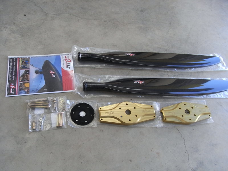

ShaneA Posted August 21, 2017 Share Posted August 21, 2017 Robinsm and Paul G do the pitch blocks supplied by bolly fit the Brolga Props or do I need to buy an entirely new Bolly Prop to change the Blade angle ???? New Xair Standard Owner Link to comment Share on other sites More sharing options...
robinsm Posted August 21, 2017 Share Posted August 21, 2017 I dont know, never having owned a brolly prop. I did buy new pitch blocks from the states in sizes 13, 14, 15, 16 and 17 degree but finished up using the recommended 16 degree ones from brolga. (that being said, I had to enlarge the bolt holes in the American ones but that was simply a matter of running the correct drill size through the holes. The supplied Australian pitch blocks were fine. 1 Link to comment Share on other sites More sharing options...
corvairkr Posted August 22, 2017 Share Posted August 22, 2017 Robinsm and Paul G do the pitch blocks supplied by bolly fit the Brolga Props or do I need to buy an entirely new Bolly Prop to change the Blade angle ???? New Xair Standard Owner ShaneA, The Bolly props don't have pitch blocks mate but they are adjustable. This link should help you out http://bollyaviation.com.au/wp-content/uploads/2015/05/BOS-3-instructions.pdf Jason 1 Link to comment Share on other sites More sharing options...
JG3 Posted August 22, 2017 Share Posted August 22, 2017 The pitch blocks that Brolga used are still available from the original supplier in the USA. Competition Aircraft | Ultra-Props and Propellers for Ultralight Aircraft Link to comment Share on other sites More sharing options...
Peter G Posted August 22, 2017 Share Posted August 22, 2017 Robinsm and Paul G do the pitch blocks supplied by bolly fit the Brolga Props or do I need to buy an entirely new Bolly Prop to change the Blade angle ???? New Xair Standard Owner Hey Shane, I have a Bolly carbon prop on mine which has a two piece main hub the blades sandwich between and gives me what ever pitch I want to set it to, the Brolga prop with pitch blocks are probably easier to set as you just buy the block you want. I used a digital pitch meter to set my blades which took time to set right, the pic below is mine one before we bolted it together :) cheers Pete 1 Link to comment Share on other sites More sharing options...
