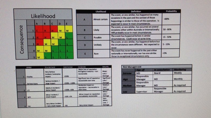

DGL Fox Posted June 27, 2015 Share Posted June 27, 2015 Doesn't get much safer than that I have attached a photo of the risk matrix for those of you that are interested. Well it does Aldo, now do the same scenario with a Rotax powered aircraft by using your matrix you should see that the Rotax powered aircraft are even less likely to have serious injury or death by engine failure and that is my point, thankyou, you have made it very clear that FOR ME it is a safer option, if I want to buy my first aircraft it should be cheaper to run and safer to buy a Rotax powered plane because there has been less failures. Aldo you have way more experience flying experience than I and you feel a lot more confident in the thought that you may have an engine failure and you can handle it but I don't have the experience or that confidence, in time probably, but not right now, so I am happy with the knowledge that I have done MY due diligence and this is the best option for me. David Link to comment Share on other sites More sharing options...

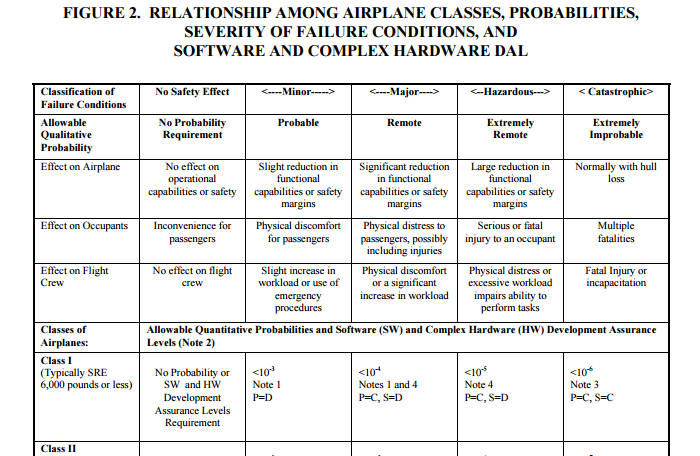

djpacro Posted June 27, 2015 Share Posted June 27, 2015 ... So if we use the risk assessment matrix (which is the most commonly used these days) .... Those numbers are not particularly relevant to this debate, neither are those in this attachment but they are much closer (these are for systems in a FAR 23 certified single piston engine aircraft, not for the engine itself). Link to comment Share on other sites More sharing options...

Aldo Posted June 27, 2015 Share Posted June 27, 2015 Well it does Aldo, now do the same scenario with a Rotax powered aircraft by using your matrix you should see that the Rotax powered aircraft are even less likely to have serious injury or death by engine failure and that is my point, thankyou, you have made it very clear that FOR ME it is a safer option, if I want to buy my first aircraft it should be cheaper to run and safer to buy a Rotax powered plane because there has been less failures.Aldo you have way more experience flying experience than I and you feel a lot more confident in the thought that you may have an engine failure and you can handle it but I don't have the experience or that confidence, in time probably, but not right now, so I am happy with the knowledge that I have done MY due diligence and this is the best option for me. David David You miss the point risk assessments are objective (logical) not subjective (emotional) so if you are going to use the risk assessment procedure then you will arrive at the same conclusion I have. If one aircraft that is/was powered by a Rotax engine has had a fatality in an engine failure situation then by nature of the risk assessment process it is automatically in a higher category the lowest it can ever be is a yellow (medium) E1 position on the matrix. The difference here is we are talking about Jab airframes and engines as a combination, if Rotax had an airframe that was as good as a Jab the outcome may be different. I'm happy that you are happy. Aldo Link to comment Share on other sites More sharing options...
Aldo Posted June 27, 2015 Share Posted June 27, 2015 Those numbers are not particularly relevant to this debate DJ So where does Jab arrive in comparison on the FAR 23 matrix Aldo Link to comment Share on other sites More sharing options...
djpacro Posted June 27, 2015 Share Posted June 27, 2015 I'm quite familiar with that AS as well as aviation SMS and aircraft certification requirements. My point relates to the use of, for example, 5% as the figure for a rare occurrence. CASA specifies rare as "Once in the next 10 years–may occur only in exceptional circumstances" per http://www.casa.gov.au/wcmswr/_assets/main/sms/download/2012-sms-book3-safety-risk-management.pdf Link to comment Share on other sites More sharing options...
DGL Fox Posted June 27, 2015 Share Posted June 27, 2015 Aldo, Sorry but you are missing the point, the engine is the problem not the airframe, do the analysis on the engine only. David Link to comment Share on other sites More sharing options...
Aldo Posted June 27, 2015 Share Posted June 27, 2015 I'm quite familiar with that AS as well as aviation SMS and aircraft certification requirements. My point relates to the use of, for example, 5% as the figure for a rare occurrence. CASA specifies rare as "Once in the next 10 years–may occur only in exceptional circumstances" per http://www.casa.gov.au/wcmswr/_assets/main/sms/download/2012-sms-book3-safety-risk-management.pdf DJ Ok thanks for that. Link to comment Share on other sites More sharing options...
Aldo Posted June 27, 2015 Share Posted June 27, 2015 Aldo,Sorry but you are missing the point, the engine is the problem not the airframe, do the analysis on the engine only. David David No problem have a nice night Aldo 1 Link to comment Share on other sites More sharing options...
