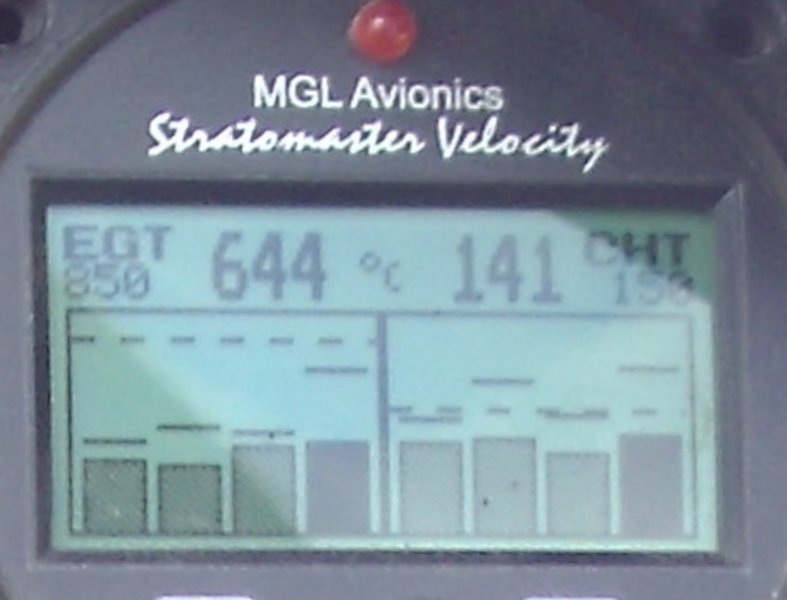

I'm away from home, with only this single pic to help me relate to this discussion. Can anyone interpret it for me?
This is my reading at cruise; it looks okey, but without a side scale it's hard to read the temp spread between cylinders. I presume the big numbers are the the hottest cylinder. On the CHT side the bars only appear when 100C is reached, so I guess there's 50C between the bottom and the dotted line, which is the 150C CHT I've set to trigger the alarm. Is that what the small 150 means?
I can't recall at what temp the EGT bars appear, so how do you read the spread?
What does the little 850 on the EGT side mean? Is it the dotted line across all 4sensors and does it trigger the alarm?

Alarm settings?
If you had egt at 850 it wouldnt be for long, expensive bits damaged
Many ems setups pick out peak cylinder temps as with mix control that is the one you lean for
In Jabiru this peak cylinder can swap positions with throttle settngs and load

Jetr is right that the egts change with throttle settings and the speed of the mixture coming in,at full throttle my number 5 mixture is the hottest instead of 2 .at full noise there is a little spread but nowhere near 100 degrees c.will be away for a week or so will get a full throttle reading when I return
