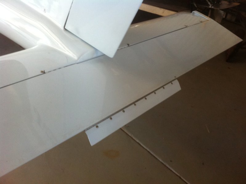

One of the mods I am planning for my J230 is to remove the mechanical trim and add electric trim. I plan to cut a section out of the trailing edge of my elevator and use a Ray Allen servo. Anyone have a suggestion for elevator trim tab size?
Build it carefully. (the trim tab mechanism or it will flutter if it disconnects). Size Get the % area from a similar design. Some have the trimtab move as the elevator moves to Auto servo it. Be careful with all of that. At least it isn't a full flying tail. Nev
rgmwa. Most airplane design engineers regard them as a critical part that MUST be very carefully designed , inspected and maintained. It's efficient but can have flutter consequences. I have owned a Twin Commanche which is a lovely plane in many ways . See the Vid on flutter with one on this forum. Nev

That would be great if you could send me some photos. Please provide the dimensions too. I would also like to know how much throw your trim tab is capable of and how much you actually use.
How effective is your trim tab? Would you recommend one of the same size or a larger?
My understanding (from what I have read) is that the J2/4 series planes are light in aileron athority but slightly twitchy in pitch. If this is true, I won't want to enlarge the elevator by adding an external trim tab. Building the trim tab into the elevator will also be more aesthetically pleasing. Comments?
I assume that a trim cut out of trailing edge of the elevator will have less chance of fluttering. (Does "assume" have the same, humorous, meaning for you guys in the Southern Hemisphere as it does up here?) A trim tab cut out of the trailing edge will be thicker and therefor more ridged than one made to extend from the trailing edge of the elevator.
I will also need to ensure a bullet proof connection to the Ray Allen Servo and mounting. I may consider mass balancing the trim tab or adding some friction to the hinge.

I would follow the above trim system (added to trailing edge) instead of cutting it into the elevator.
A tab mounted to the trailing edge has a better leverage to work as a trim, which means it can be smaller.
Cutting into the elevator will mean adding a sub-spar for it to hinge on, adding weight aft of the elevator hinge, and the tab itself would then have thickness (to match the elevator) which will also add weight.
This will then require more counter balance weight to balance the elevator, adding more weight to the rear of the aircraft.
Although the Jab has a tail and elevator, it doesn't hurt to maybe incorporate a 'anti servo' system into the trim for feel and damping at speed.
