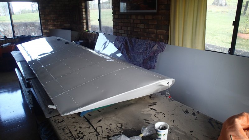

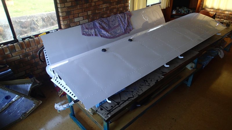

Wings painted and tail plane being done next week then onto the fuselage, can't wait to start putting it together 001_smile.gif.2cb759f06c4678ed4757932a99c02fa0.gif Decided against doing it myself and got professional spraypainters that were recommended to me doing the job but it's a slow process with them having plenty of work on.

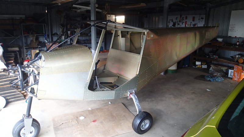

Really interesting new panel they have, makes it allot easier and nicer.

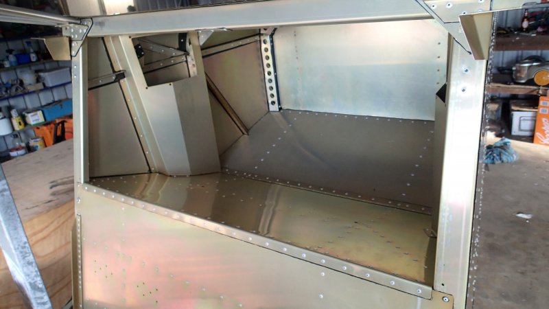

The extended luggage compartment I wish I had, can you use the rescue chute in that configuration?
Is the front wheel of different kind than the rear?
Hi Skee,
All wheels are identical and I think it a case of having the extended luggage and no chute or if you have the chute you have to do away with the extended luggage compartment. I was playing with he idea of putting a chute in but decided on the extended luggage. If i decided to put a chute in at a later date then I guess I'll have to put a false wall in.
