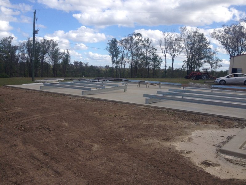

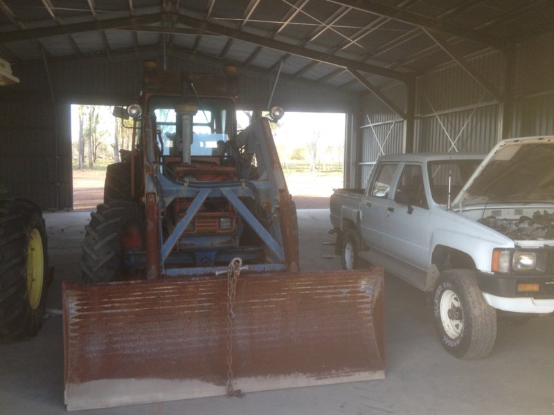

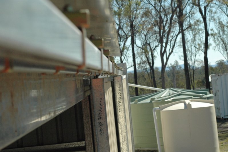

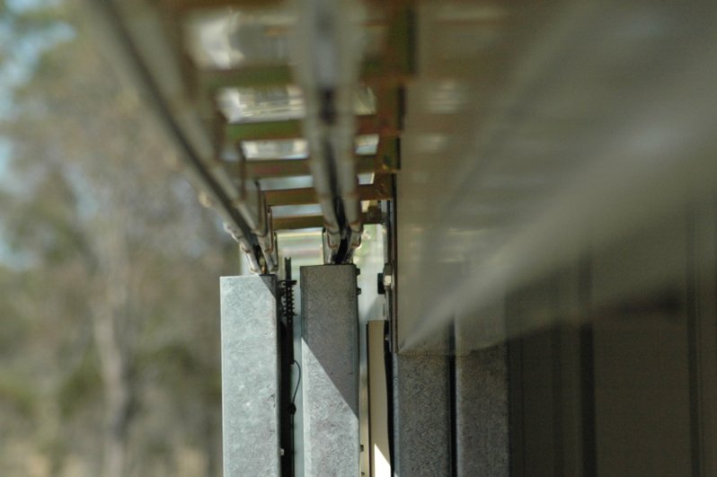

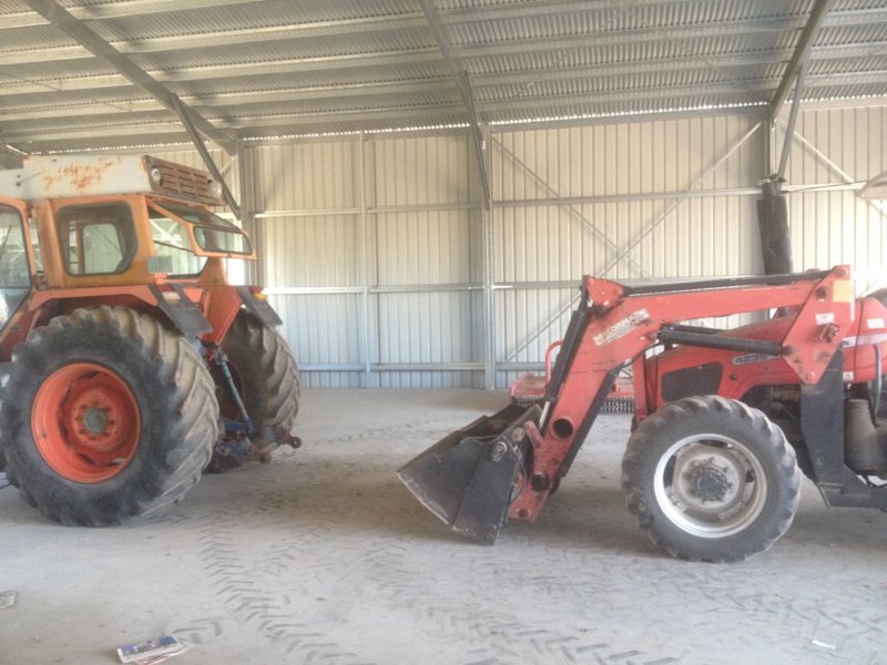

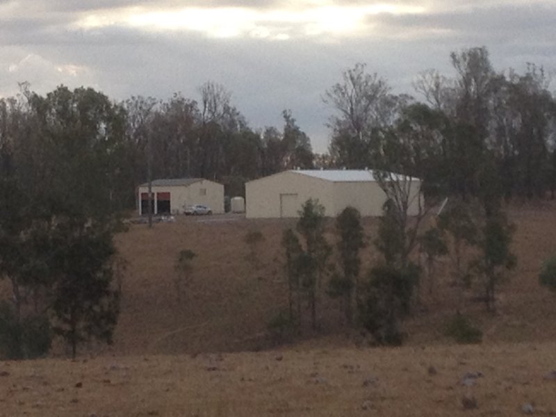

Kyle Communications Posted April 7, 2015 Share Posted April 7, 2015 My hangar was done by Fair Dinkum sheds..they are signitories to this new association to make sure the ratings of the shed are correct it came about after a cyclone up north and all the sheds blew away that were rated for it. The shed design and construction is the best I have seen especially for the money. I have to stress I am happy with the shed and the design..its just the nongs who did the doors. The doors were a klusterf*ck. That though was the shed erectors had never done them before but they did such a good job on the hangar. The erectors were a contractor/agent for fair dinkum sheds. My hangar is 15 metre opening/wide and 18 metres long the gutters are 4.5 metres from the ground and the peak of the roof is 6 metres off the ground. There are 5 bearing type whirly birds on the roof and a 3metre wide roller door in the rear. It is all concreted floor. Shed cost inc the doors and the concrete was total $71,000 all done at my farm some 50km west of Bundaberg. I had quotes for the same size up over 100,000 bucks. I have some pics of the bottom rollers and tracks..just have to find them. The unistruts are now much straighter and its 90% there...I just have to tidy up the other 10%. The $71,000 was total price installed Mark Link to comment Share on other sites More sharing options...

nickduncs84 Posted April 7, 2015 Author Share Posted April 7, 2015 I have concertina doors on the hangar at Ycab...they are a huge pain in the bum..they always need adjusting and they bind if you dont do it in a specific order. The hangar owner has tried at least 3 times since I have been in there to fix them...this latest time they are the best they have been ...but are still crap Great looking shed! I'm starting to think 100k may not be realistic for a 18 x 36. One of the guys that works on the property used to be a concreter, so the original plan was to get the concrete supplied and get him to take care of it. But reading these posts, I'm starting to question that.... Link to comment Share on other sites More sharing options...

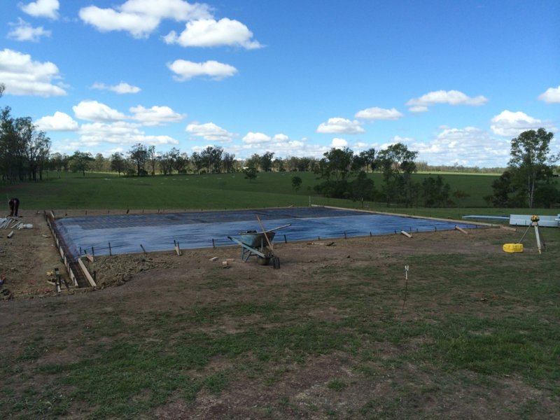

Kyle Communications Posted April 7, 2015 Share Posted April 7, 2015 I had quite a few quotes one was even $110,000 for the same thing. I had to ask the guy 3 times if his cost for the concrete floor was correct. It was $22,000 which seemed extremely cheap to me but he said that was the price. The prep work was excellent and the slab was excellent quality as well. My mate was there when they were pouring it and he said everything was done correctly. It was $13,000 for the erecting and the balance was the shed and doors cost. My mate did the earthworks with my tractor so the slab could be done so there would be extra cost if you had to get someone to prepare the pad for the floor Link to comment Share on other sites More sharing options...

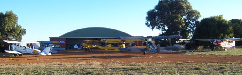

DWF Posted April 7, 2015 Share Posted April 7, 2015 There are a couple of fairly new hangars at the north end of Jandakot (WA) that have bi-fold vertical doors. No idea of their cost. When I was building my hangar 10 years ago the ones from USA were prohibitively e xpensive when you added in exchange rate shipping, tax, etc. My hangar is a bit overbuilt but is very solid. 24m x 18m concrete floor and built in 2 level accomodation. Door opening is 20m x 4m (IIRC) with 4 doors each with 2 bottom rollers and nylon guides at the top. Bottom rollers used to be bushed but now have ball bearings and the rather heavy doors glide effortlessly (once the initial inertia is overcome). The bottom tracks are about 6mm wide and stand clear of the concrete into which they are set by about 10mm. Build it solid - especially the doors. Even if it costs a bit more (which it probable will) you will not regret it in the long run. It attracts these: DWF 3 1 Link to comment Share on other sites More sharing options...
Marty_d Posted April 7, 2015 Share Posted April 7, 2015 I like that. You don't have to worry about building a house, just live above your planes. Link to comment Share on other sites More sharing options...

bexrbetter Posted April 8, 2015 Share Posted April 8, 2015 There are a couple of fairly new hangars at the north end of Jandakot (WA) ............ It attracts these: I've been wondering where the secret air force base is in WA, off to lodge a report to my Comrades immediately. 1 Link to comment Share on other sites More sharing options...
Marty_d Posted April 8, 2015 Share Posted April 8, 2015 I've been wondering where the secret air force base is in WA, off to lodge a report to my Comrades immediately. I don't think the Chinese Air Force has much to worry about from a flock of Tiger Moths, no matter how good their pilots are... Link to comment Share on other sites More sharing options...
