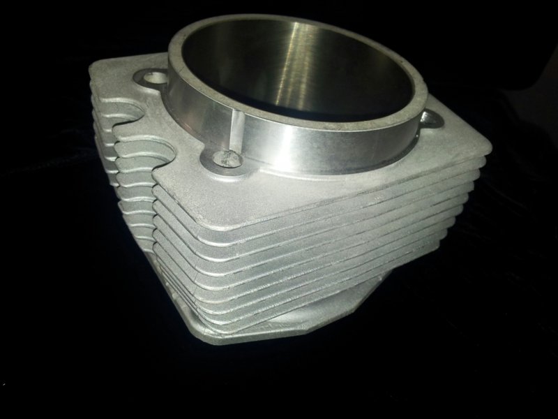

Keenaviator Posted April 10, 2015 Share Posted April 10, 2015 From the Jabiru factory today, some information regarding a new engine. Looks interesting, not only new cast cylinders/heads but it looks like the induction is very different too. As we keep saying the Research and Development never stops here at Jabiru. For the last 4 years the Jabiru engineers have been working on the development of the “2210” engine. It’s exciting news!!! There is still work to be done but we are edging closer to the possible launch of this new engine. We are planning to initially release it as an experimental engine. Eventually there will also be a six cylinder released as well. We have now accumulated just over 800 hours in test time and it is performing well. The engine has non corrosive aluminium cylinders with nickel and silicon carbide bores. These cylinders have three times the thermal conductivity of steel and the bores have very low friction and high wear resistance. The cast cylinders are more robust than the steel cylinders we currently use. We will keep you updated on the progress......... in the meantime we have attached some pictures for you of the “2210” 1 1 Link to comment Share on other sites More sharing options...

planesmaker Posted April 10, 2015 Share Posted April 10, 2015 Looks like very long through bolts, head to head, interesting concept. Link to comment Share on other sites More sharing options...
billwoodmason Posted April 10, 2015 Share Posted April 10, 2015 Is that an oil return unit on the dip stick ? Looks like a good way to mount it. Link to comment Share on other sites More sharing options...

gandalph Posted April 11, 2015 Share Posted April 11, 2015 A colleague with much more expertise and experience in these things than me has suggested that the cylinders appear to be a pressure casting and possibly/probably a derivative of 242 alloy and so good for about 250C. An improvement on the current alloy's temperature handling capability. He expressed some concern about the finning arrangement and suggested that it is likely to put the exhaust valve temp up, unless they've gone for high-conductivity valve seats. The higher temp is going to put the oil temp way up, in the rocker boxes; so they will need to increase the oil flow greatly . He was not very optimistic about this development saying that it will simply move the failure points rather than eliminating them. 1 1 Link to comment Share on other sites More sharing options...
jetjr Posted April 11, 2015 Share Posted April 11, 2015 Current cylinders are steel This looks to have new cylinders and old heads I expect this is the "chimese engine" many have discussed. Good to see progress, going to need more than one engine and 800 hrs though. Camit mods way more developed than this. I have one of those oil catch units......as a measure of effectiveness.....do you want it? Link to comment Share on other sites More sharing options...

bexrbetter Posted April 11, 2015 Share Posted April 11, 2015 Any increase in horsepower? Statically, doubtful as the port layout looks the same but it's possible that with better cooling the hot running hp is slightly better - or more technically specific, less loss of hp (a downside of hot air cooled engines). I imagine the combustion chambers are the same as before too, more's the pity, the Jab chambers are not optimal and a few 'free' hp to be gained there with some rework. Link to comment Share on other sites More sharing options...

Guest john Posted April 11, 2015 Share Posted April 11, 2015 The main items to address with respect to this new engine which is obviously still under RESEARCH & DEVELOPMENT & which requires further & better particulars for interested personnel to consider are are as follows: 1. Have the crankcase through bolts been strengthened to prevent failure? 2. Have the flywheel bolts been strengthened to prevent failure? 3. Are the tappets, hydraulic or mechanical to prevent valve seat recession? 4. Are the new type cylinders, manufactured in Australia or overseas? When the abovementioned queries have been provided with an acceptable answer then & only then can Owners & Pilots make an informed decision if the new Jab engine has moved forward or just sideways. Link to comment Share on other sites More sharing options...
bexrbetter Posted April 11, 2015 Share Posted April 11, 2015 I genuinely think Oscar would have some good content to share. 1. Have the crankcase through bolts been strengthened to prevent failure? 2. Have the flywheel bolts been strengthened to prevent failure? 3. Are the tappets, hydraulic or mechanical to prevent valve seat recession? 4. Are the new type cylinders, manufactured in Australia or overseas? 1. It would appear they have made some attempt at change in the area. 2. Is that still a problem, I thought they had fixed it? 3. Has nothing to do with the issue, millions of hydraulic and millions of solid lifter engines have no issues. Cam ramp profile, valve rotation, spring weight and of course, material type are what counts. 4. Is that a big decision in the purchasing process as long as they function accordingly? .. and yes I prefer if they were made in Oz. 1 Link to comment Share on other sites More sharing options...

hyundai Posted April 23, 2015 Share Posted April 23, 2015 A colleague with much more expertise and experience in these things than me has suggested that the cylinders appear to be a pressure casting and possibly/probably a derivative of 242 alloy and so good for about 250C. An improvement on the current alloy's temperature handling capability. He expressed some concern about the finning arrangement and suggested that it is likely to put the exhaust valve temp up, unless they've gone for high-conductivity valve seats. The higher temp is going to put the oil temp way up, in the rocker boxes; so they will need to increase the oil flow greatly . He was not very optimistic about this development saying that it will simply move the failure points rather than eliminating them. I just came back from jabiru talking to Stiffy and i can tell you they are developing the new engine testing testing and they will find all the problems. I am sure when it goes to market it will be right. As the person who made the LCHeads who just tested for a few hours and sold to the unsuspecting public yes I bought them a big list of problems they should have tested for 2-500 hours not just 6 hours and say yes temps 180Deg on the market sold. Link to comment Share on other sites More sharing options...
jetjr Posted April 23, 2015 Share Posted April 23, 2015 Jabiru too need to extend testing systems and subsequent quality control. Plenty have suggested improvements to Rod over the years including close partners. He isnt very receptive to others ideas. Some of the previous improvements Jabiru have released are reactionary and largely untested i suggest. Sometimes let down by sub standard parts and materials down the track. Examples might be economy carb jetting, new throughbolt nuts, new longer throughbolts, now we have larger throughbolts AND studs, washers and nuts, various flywheel attachment versions and perhaps the whole hydraulic lifter development saga, valve issues, gudgeon circlips, mag rotors and the list goes on. I am a big supporter of Jabiru however experience shows they are prone to making changes on the run and this doesnt result in solid improvements. Its not always the upgraded part which gives the problem. Right now they are under enormous pressure due to CASA limitations and Ive frequently said this may not be the right environment for development of sound upgrades. Especially where slow and expensive testing is required. They arent BRP or Lycoming selling thousands per year and reality is funds are no doubt limited. Its good they are moving ahead and bringing new ideas to the market, these new cylinder/throughbolt arrangement look good, but its some big changes effecting lots of other systems. It will need some serious testing. 1 1 Link to comment Share on other sites More sharing options...
dazza 38 Posted April 24, 2015 Share Posted April 24, 2015 It is a big step forward IMO Jabiru going with Nikasil bores, motorcycles have been using this for years. Link to comment Share on other sites More sharing options...
