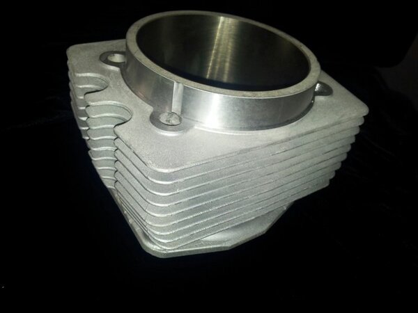

bexrbetter Posted May 16, 2015 Share Posted May 16, 2015 There must be a reason why millennium's cylinders are preferred instead of Eci's nikasil. I don't see the connection between the issue and nikasil bores. The OEM originals are having the same issues and if you are familiar with the differences between a major engine manufacturer and an aftermarket supplier, the higher rate of failure for the aftermarket supplier, as low as it is, is of no surprise. Link to comment Share on other sites More sharing options...
grindio Posted May 16, 2015 Share Posted May 16, 2015 I've been an engine dealer for more than 25 years, and oem parts are not always better than after markets. Do your research on continental o200 heads and cylinders and you'la see why most people in the states are using aftermarket cylinders on certified planes. The very moment Yamaha or Suzuki start producing these light aero engines will be game over for everyone but rotax and lyc. 1 2 Link to comment Share on other sites More sharing options...
JoeDallas Posted May 16, 2015 Share Posted May 16, 2015 I don't see the connection between the issue and nikasil bores.The OEM originals are having the same issues and if you are familiar with the differences between a major engine manufacturer and an aftermarket supplier, the higher rate of failure for the aftermarket supplier, as low as it is, is of no surprise. I'm not to sold on nikasil, it's true they solve the corrosion problem, but read this:http://www.avweb.com/blogs/insider/ECI-Cylinder-AD-The-More-You-Look-the-Worse-It-Is-220510-1.html There must be a reason why millennium's cylinders are preferred instead of Eci's nikasil. I just read that article and I don't understand what it has to do with Nikasil These light weight Engines are driving me nuts. I wish the FAA would get some sense and change the light sport weight to 1450Lbs, so we could use a real aircraft engine 1 1 Link to comment Share on other sites More sharing options...
