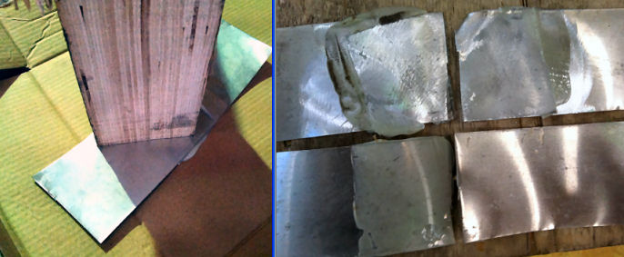

bexrbetter Posted May 19, 2015 Share Posted May 19, 2015 The tail spar roughen up to attach the glass rib, the glass is always shrinking to the tube and making the bond tighter over time. its not going anywhere, and vibration is not going to have any effect over time. its the best of all worlds. Sure Fiberglass is asymptotic, but it's main shrinkage takes place over the first week or 2 and the shrinkage is not greater than it's expandable range due to heat. Not my opinion, scientific fact. Fiberglass does not permanently bond to metal, roughened or not, and again, not my opinion, that's factual science. The joint will eventually fail, go ask 3M, Selleys, Cyberbond or someone similar. Besides just knowing how poorly metal and fiberglass bonds from many years of playing with the stuff and that's it's veritable lore (for a change), I did a whole series of dedicated coupon and other testing last year including fiberglass and a range of expensive epoxys. Here is some of those tests, some Morgan builders might recognise the offcuts in the video .... All tests failed to be considered as a standalone joint, fiberglass easily one of the weakest. Surprisingly, common hardware store "Liquid Nails" type was consistently one of the best and is actually the video above. Anyway, not here for a fight, I was asked the question and I answered. If you choose to fly with the standard setup, that's your prerogative, I won't and for the addition of 5 minutes work and a couple of rivets I don't see why anyone wouldn't support that. Link to comment Share on other sites More sharing options...

turboplanner Posted May 20, 2015 Share Posted May 20, 2015 Fiberglass does not permanently bond to metal, roughened or not, and again, not my opinion, that's factual science. The joint will eventually fail, go ask 3M, Selleys, Cyberbond or someone similar. That is correct, but we were talking about FRP being laid in such a way that when it shrinks it locks on to mutilated steep and the mutilations - grooves and protrusions provide a mechanical lock. Link to comment Share on other sites More sharing options...
bexrbetter Posted May 20, 2015 Share Posted May 20, 2015 That is correct, but we were talking about FRP being laid in such a way that when it shrinks it locks on to mutilated steep and the mutilations - grooves and protrusions provide a mechanical lock. Oh I understand exactly what's being proffered. After the bond has broken, over time the back and forwards movement will grind it smooth and eventually slip around. Sure, that may be 100 years and millions of cycles ..... but maybe not. Who knows, you guys are only guessing and you have no empirical evidence available, that's the problem. You may have sealed up some static pipes, but this joint has constant cyclic shear stress applied along with constant expansion/contraction at different material rates trying to tear it apart - even when it's just sitting. I've stated the plane is very safe and crashworthy so I'm obviously in support of the design overall and I have promoted the Morgan to individuals ho ask and in the HBA forum. I'm not here to cause drama and panic, but this bit is simply not up to my standard and it's technically not a good idea, as well as the fuel tank construction being too thin considering it's in the cockpit. A couple of simple rivets fixes this issue, lay up the tank thicker or replace it (as Sloper did) fixes the other. Minor, but important fixes. It's not law to build to the original specs, that's only a guide, once the kit is in your possession it's up to you. 1 Link to comment Share on other sites More sharing options...
