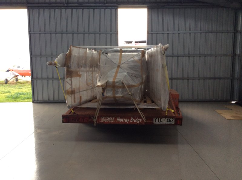

Steve L Posted July 28, 2015 Author Share Posted July 28, 2015 The kit has arrived, all unpacked and assembly has started. Cant believe how many parts there are, I'm sure KFA have sent me too much stuff. Looking at the parts inventory every part, nut ,bolt and washer is part number tagged which corresponds to the assembly manual drawings very professional. I'm impressed even I cant get things mixed up. They have done a excellent job. 10 Link to comment Share on other sites More sharing options...

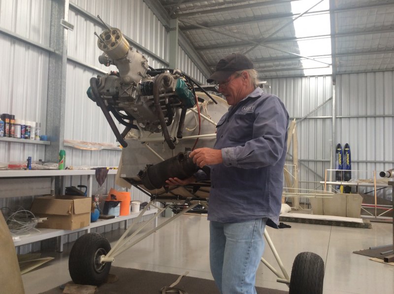

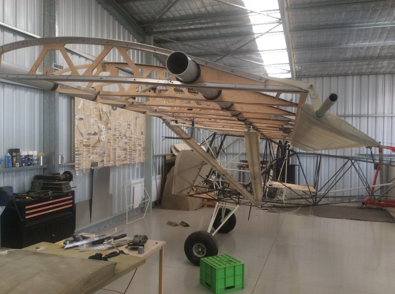

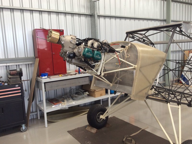

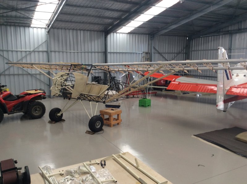

Steve L Posted November 27, 2015 Author Share Posted November 27, 2015 I'm back !!!! Hopefully for a couple of weeks this time. Day 20 and the tank extensions are nearly complete, Dry fitted the Rotax today, sat in the Explorer and made plane noises for awhile. The nose is heaps high I'll have to carry a milk crate to stand on to check the oil. ( and I'm six ft tall haha ) C 4 Link to comment Share on other sites More sharing options...
Kamloops Posted November 27, 2015 Share Posted November 27, 2015 Nice build. Keep up the great work. 1 Link to comment Share on other sites More sharing options...
Guy s Posted November 27, 2015 Share Posted November 27, 2015 Thanks for the update and looking good Steve. No worries with prop clearance in the paddocks eh. Link to comment Share on other sites More sharing options...
mAgNeToDrOp Posted November 27, 2015 Share Posted November 27, 2015 Nice work, what size/type tyres are those? Link to comment Share on other sites More sharing options...
Steve L Posted November 27, 2015 Author Share Posted November 27, 2015 Not big enough haha! They r Carslisle turf guide 8.00 - 6 . . . 18" tall with 4 psi in them Link to comment Share on other sites More sharing options...

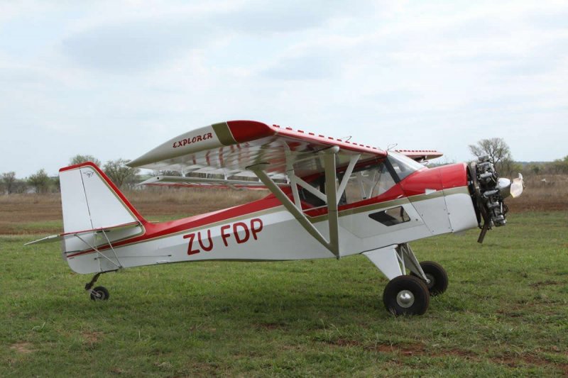

Steve L Posted November 27, 2015 Author Share Posted November 27, 2015 I'll take some tank pics tomorrow, colour red over white similar to ZU FDP. love the radial Link to comment Share on other sites More sharing options...

Kitplanes Posted November 27, 2015 Share Posted November 27, 2015 How about this one 2 1 Link to comment Share on other sites More sharing options...

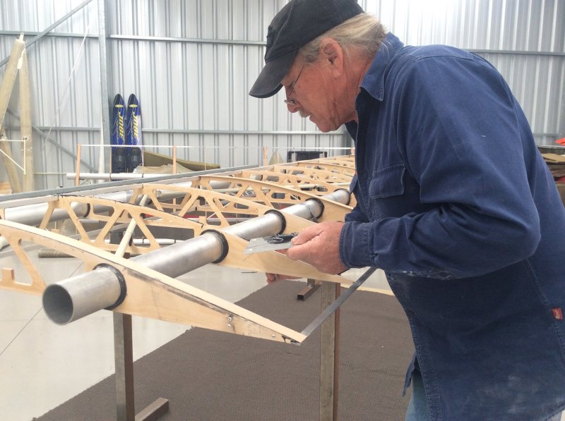

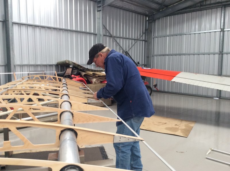

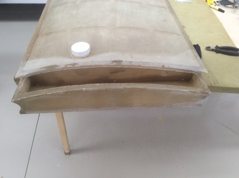

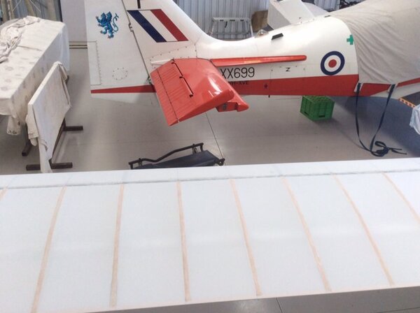

Steve L Posted January 11, 2016 Author Share Posted January 11, 2016 Has been awhile since posting. Tank extension pics below, still need to fit top covers and slosh them. Have dry fitted the wings for the last time to check the final pitot and fuel line routing and making sure the tank extensions work. Presently setting up the flapperon linkage, then wings are ready for covering. Link to comment Share on other sites More sharing options...

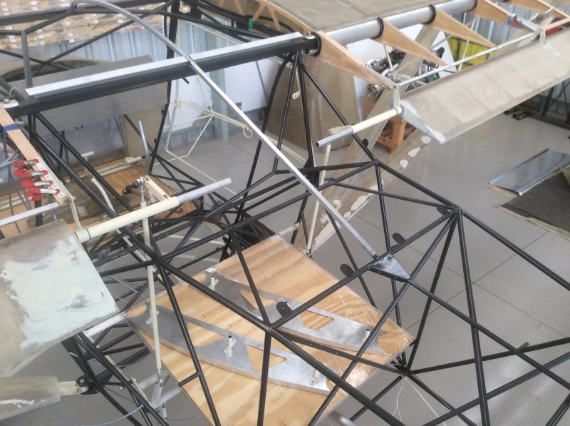

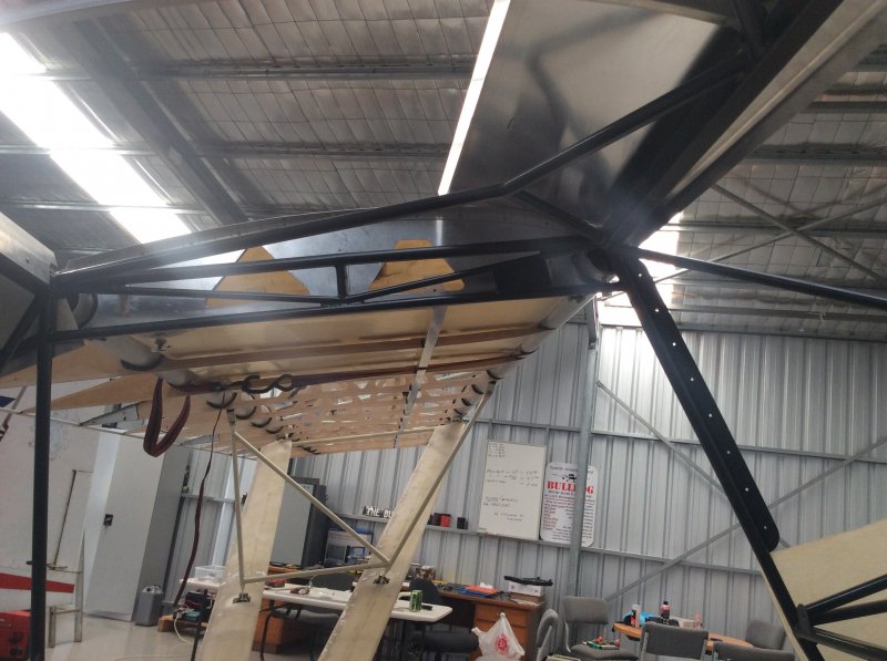

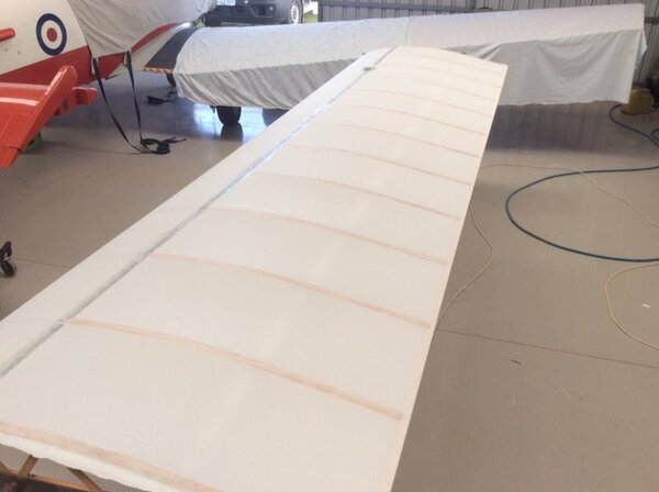

Steve L Posted January 11, 2016 Author Share Posted January 11, 2016 Here's some more pictures. The baggage area is huge, was thinking how the hell am I going to fill that till my wife came by today with some lunch, " that will hold about 40 pairs of shoes " she said . . . Bring on the brownie points haha! 2 Link to comment Share on other sites More sharing options...
