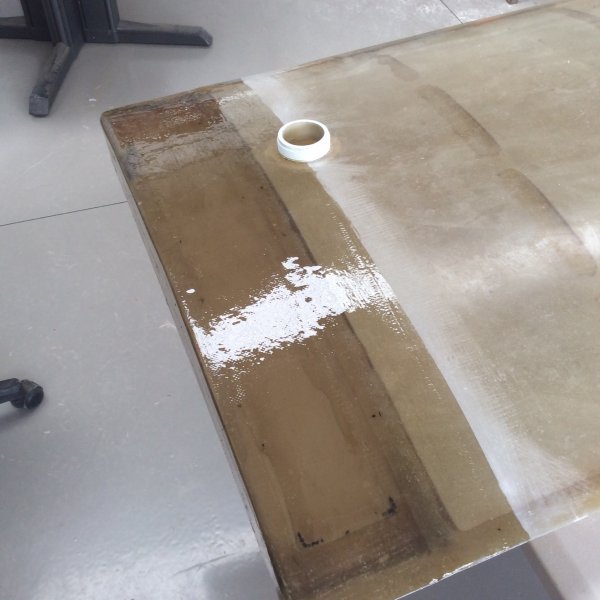

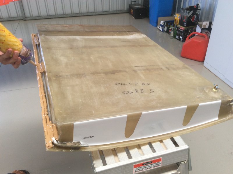

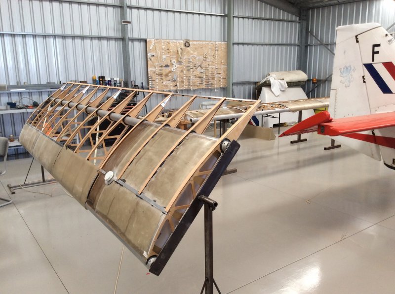

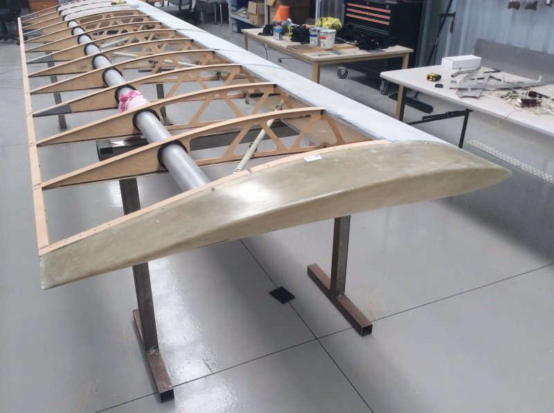

Steve L Posted March 20, 2016 Author Share Posted March 20, 2016 hi, I haven't posted for awhile so here's an update. First pic, applying glue to the lower edge of the tanks ( hope I have enough on there ) Second pics, tanks are fitted and only a couple of leading edge cuffs to go then sanding ready for the fabric. The fuselage is near ready for fabric too. Plan to get into the covering after Easter. Steve 1 Link to comment Share on other sites More sharing options...
Steve L Posted March 20, 2016 Author Share Posted March 20, 2016 I was actually thinking of placing a thin sheet of polly styrene on top of the tanks below the fabric. My thinking is it should distract some of the suns heat from heating and evaporating the fuel. Has anyone had any experience with this? was wondering if it would be worth it. Link to comment Share on other sites More sharing options...

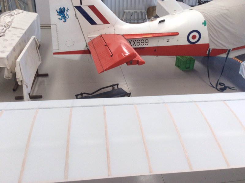

Kitplanes Posted March 20, 2016 Share Posted March 20, 2016 Its up to you but in 25 years its never been a problem in the African sun. In my opinion the sheet will make no big difference, in fact it will make the area on top of the tank look awkward as the wing will not look uniform. The fabric makes these waves between the ribs and what we do is stick a double capstrip on top of the tank to give the illusion of a rib being there and then you do not see the tank. Up to you. Also fist check what the reaction of the styrene with the dopes and thinners will be. I suspect it will eat up the styrene. 1 Link to comment Share on other sites More sharing options...
Kitplanes Posted March 20, 2016 Share Posted March 20, 2016 Sorry the pics only came through now this side. I see you did stick the capstrips on. Juts leave it as it is, it will be perfect. Link to comment Share on other sites More sharing options...
Steve L Posted March 20, 2016 Author Share Posted March 20, 2016 No worries Stefan will do thanks mate. As you can probably see in the last picture I have left gaps under the capstrips so stitches can pass through. I have done this top and bottom, will post a couple of closer pics tomorrow. I can start to see the some progress now Link to comment Share on other sites More sharing options...
Steve L Posted March 22, 2016 Author Share Posted March 22, 2016 Here's the pictures of the gaps that I have left under the capstrips, top and bottom. Its the best way I could come up with to keep the fabric stitches all uniform. The stitching will be spaced at 80 mm even across the fuel tanks. I have a few days away again and when back I hope to get into the covering. Link to comment Share on other sites More sharing options...

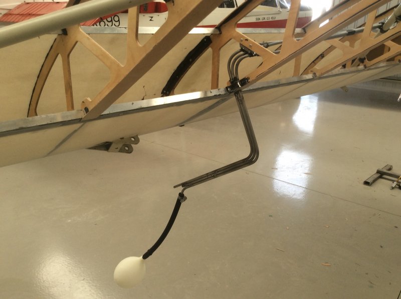

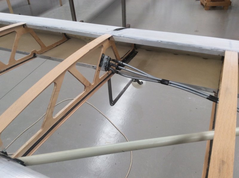

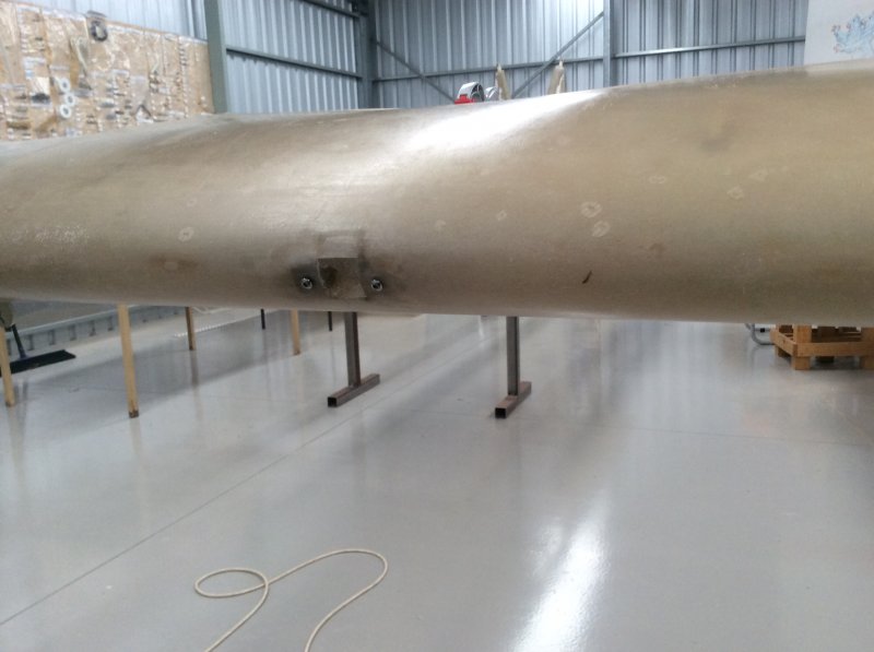

Steve L Posted March 23, 2016 Author Share Posted March 23, 2016 Couple more pics of the stall warning, the two bolts will hold an adjusting vane plate. I copied the Jabiru, its a simple system just hope it works as well on the Explorer, the wing profiles are similar. May just put one in the other wing too, now that will be interesting, anyone done that? 1 Link to comment Share on other sites More sharing options...

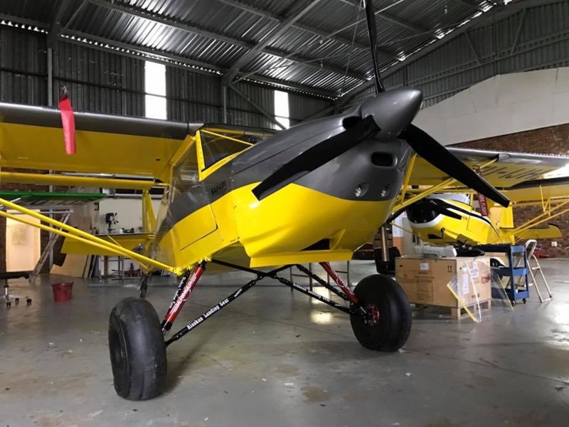

Steve L Posted April 23, 2017 Author Share Posted April 23, 2017 Hi Stefan, yes I'm still building. Due to commitments it has been quite a few months since I even looked at the Explorer let alone worked on it. Actually, last week I dusted the dust off so to speak (its been kept well covered) and gathered my thoughts as to where I am up to. Your message has come at a timely time. I see you have a very active Facebook site now where I noticed you are fitting Berringer Alaskan Gear to a Safari. would it adapt to my or any Explorer. It sure looks great and probably works better than bungees, that's how I would like my plane to look. I have included a couple of pics so you know which gear I'm referring too. Mmmmm now why did it do that, I'm not gunna try to fix it.:faint:haha! Steve Link to comment Share on other sites More sharing options...
Kitplanes Posted May 2, 2017 Share Posted May 2, 2017 Hi Steve, the Alaskan gear is great and would recommend them. Only thing is that in your case you will probably have to replace your wheels and brakes as well. The ALG uses a bolt on axle. Berringer made the system for us so the Matco E-series will also fit but when you start adding all these costs together you end up at 6500 USD easily. You would also need to modify the attachment points on the airframe to accommodate the gear. I would just buy the Matco E-series, weld a flange on the landing gear and buy the LSA 22" slicks from Matco and keep the bungees. Link to comment Share on other sites More sharing options...
