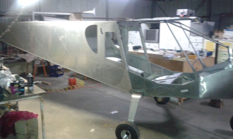

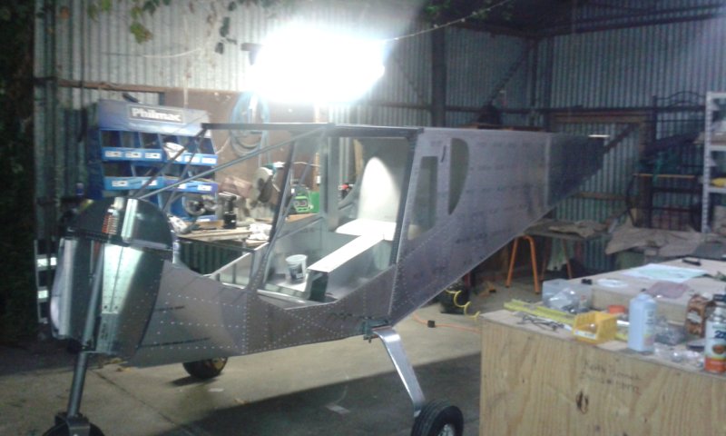

keith.b Posted June 15, 2015 Share Posted June 15, 2015 Well, 3 wheels.. 4 5 Link to comment Share on other sites More sharing options...

fly_tornado Posted June 16, 2015 Share Posted June 16, 2015 Looks like a job and a half. What paint are you using for corrosion? Link to comment Share on other sites More sharing options...
keith.b Posted June 16, 2015 Author Share Posted June 16, 2015 Thanks for the feed back. Yeah I know there is still a lot to do, but it's just satisfying to see things slowly taking shape.. A good build so far, everything just fits together. Regarding corrosion, using what the factory recommended, Cortec. The Only Mod so far is to do away with the bungee. Regards Keith Link to comment Share on other sites More sharing options...

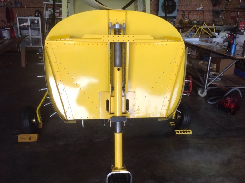

keith.b Posted June 16, 2015 Author Share Posted June 16, 2015 Hi Kieth, what did you use to replace the bungee Jan from Viking does a coil spring mod. Pic from his web site. Link to comment Share on other sites More sharing options...
terryc Posted June 16, 2015 Share Posted June 16, 2015 I've been wondering about that for sometime. What do you think of it now that it's fitted and what about ease of a retro fit Link to comment Share on other sites More sharing options...
keith.b Posted June 16, 2015 Author Share Posted June 16, 2015 I've been wondering about that for sometime. What do you think of it now that it's fitted and what about ease of a retro fit It's very easy to fit, drill 2 holes for the rods to pass through to secure the top cap on, spring fits inside the leg. The rods that hold on the cap slide over the pin that the bungee curved under. drill two holes for split pins. done.. They are excellent quality, about $500 from memory. I am very happy with it. 1 Link to comment Share on other sites More sharing options...

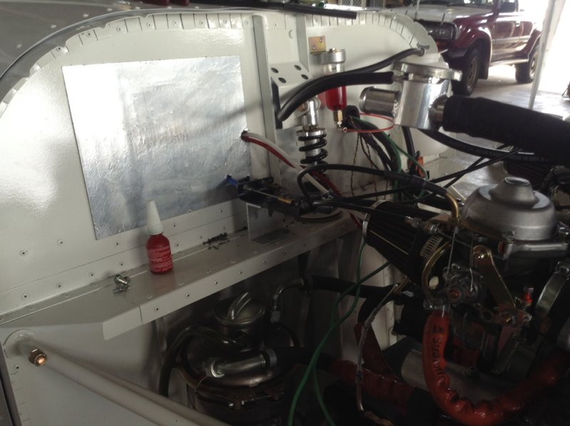

Guest Maj Millard Posted June 16, 2015 Share Posted June 16, 2015 The WAC Spirit which is like a Super Savannah uses a coil spring also. You can see it in the attached photo. It also has a screw adjustment at the top so spring tension is also adjustable. Obviously it is going to be less maintenance and probably last longer than the bungee. Link to comment Share on other sites More sharing options...

terryc Posted June 16, 2015 Share Posted June 16, 2015 It's very easy to fit, drill 2 holes for the rods to pass through to secure the top cap on, spring fits inside the leg. The rods that hold on the cap slide over the pin that the bungee curved under. drill two holes for split pins. done.. They are excellent quality, about $500 from memory. I am very happy with it. I'll order one this month, Thanks Keith. Link to comment Share on other sites More sharing options...
keith.b Posted June 17, 2015 Author Share Posted June 17, 2015 I'll order one this month, Thanks Keith. I don't think you'll regret it, it's such a simple well manufactured easy to install replacement for the bungee. You could also try the zenith 701 - 750 forums, to see if any are flying.. to get their feedback. Regards Keith. Link to comment Share on other sites More sharing options...
