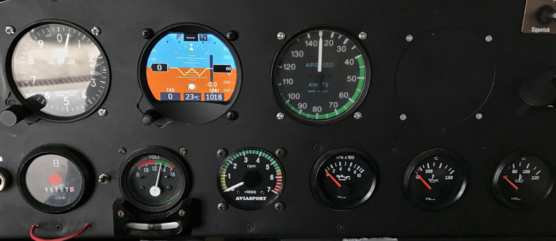

ducksrus Posted January 27, 2017 Author Share Posted January 27, 2017 Yes, I ended up buying one and fitted it to my Savannah, very happy with it. The parameters are all very accurate once you calibrate it. The heading bug on the primary flight display is great, I tend to fly on the HSI display (compass rose) and set the VOR needle to my heading and use it like a heading bug. The only time it glitched was early morning at Broken Hill, it was quite cold and the display took a while to power up. This can be typical with digital displays when it's cold apparently. Link to comment Share on other sites More sharing options...

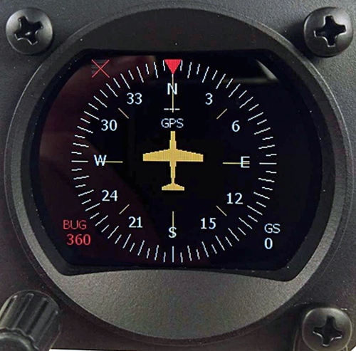

Garfly Posted January 28, 2017 Share Posted January 28, 2017 Yes I was very impressed with the AVMAP - seems a really good deal. But I went for the Kanardia 'Horis' in the end, largely because its roundness looked nicer in an otherwise round panel. The latest model (like the AVMAP) is switchable to a DG style compass-rose display - with heading bug (no quasi HSI). I'll be able to update my instrument in firmware. I think it's a great feature and, like ducksrus (above), I'd probably fly mostly on that screen. You can also buy an electronic compass module for it if you want heading (on top of GPS track). The main advantage of that being that it can then calculate winds aloft (since it already knows all other variables, including OAT). I see that the AVMAP comes with the compass - and winds aloft - as standard. I think the pricing is comparable (a bit under AUD 1.5K). I'm not sure if Kanardia has an importer here in OZ yet. I got mine direct from the factory in Slovenia. Kanardia 1 Link to comment Share on other sites More sharing options...

Garfly Posted February 6, 2017 Share Posted February 6, 2017 Since there's no local agent (as far as I know) you need to buy direct. But for me the process was easy. It came by post. I think I had to pay some tax at the Post Office to take delivery. Anyway, they're a good company to deal with. The guy I'm in contact with is Ales Krajinc. [email protected] I believe if you buy Horis now (either 57mm or 80mm) it incorporates the DG compass rose. And if you want the electronic compass module (the Magu), it's an extra. As I said, the only use I can see of it is to get Winds/Aloft. But I guess that it's worth it for that. Best check with Ales to make sure these new features are implemented and ready to go. I think they are - or very soon will be. Installation (which I had done by an L2) was very straightforward. They supply the T-pieces you need to tap into your existing pitot/static system. It also comes with a remote mountable gps aerial and an OAT probe. It needs a notch cut out of the round for the knob at the bottom left - similar to what's needed for an altimeter. Link to comment Share on other sites More sharing options...
