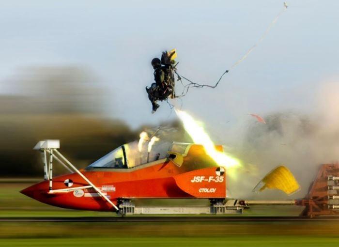

willedoo Posted June 3, 2020 Share Posted June 3, 2020 103 lbs is 46 kgs. What are they planning on using for pilots? 14 yr old girls?? A male adult who weighs only 46 kgs would make a Biafran refugee look overfed. That is light; I hadn't done the conversion. I seem to remember when they had the test dummy neck breaking problem that it happened with weights under 60 or 65kg.. Can't remember the exact figure, but around that mark. Only one pilot was grounded until the above fixes were brought in. I think the problem was with low altitude ejections where seat/pilot separation is immediate. The low weight dummies caused the seat to rotate further forward, causing a bigger snapback of the neck when the main chute deployed, hence the addition of the panel between risers. At least, that's the way I understood it. The new MK.16 seats are an interesting development. The test bed photo below gives a good view of the firing gun twin tubes in the cockpit. That part is a major change and opposite to previous seats where the inner firing tube remains with the seat and the inert outer and intermediate tubes remain in the aircraft. To save weight, the MK.16 uses the twin guns as the rails and does away with the need for a side chassis. Basically upside down. The charged inner tubes are part of the aircraft and the inert outer tubes are fixed to the seat and egress with it. The drogue harness setup is moving more to the way the Russian seat works with a more rearward pull. A bit different from the older seats I'm familiar with where the drogue pull is on the top of the seat only. That had the effect at high speed of pilot and seat heading feet first into the wind blast, which is a safe way to de-accelerate. I guess there's always the possibility that the MK.16 drogue harness would have cutters to release the lower straps and provide the same feet first attitude if you egressed above chute deployment speed. The rocket pack angle would also be trying to push the seat onto it's back, so that might help in a high speed situation as well. Link to comment Share on other sites More sharing options...
