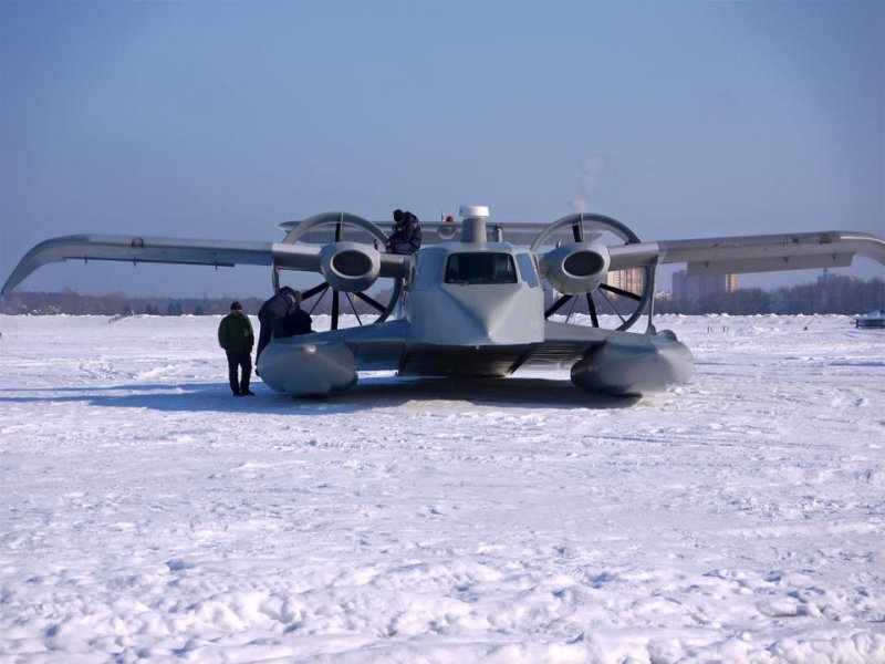

The 'Volga'-class WIG was probably the most successful - able to 'fly' along iced up rivers for both passenger and emergency-services uses:

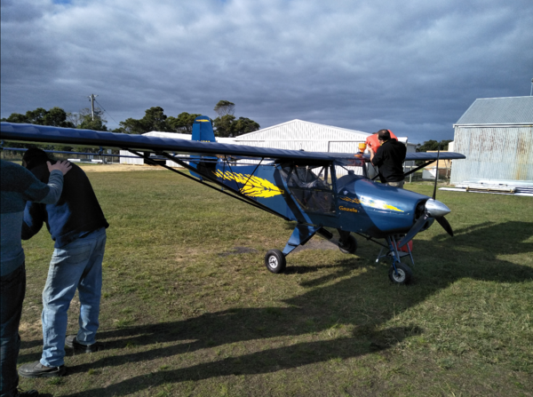

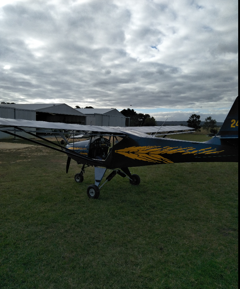

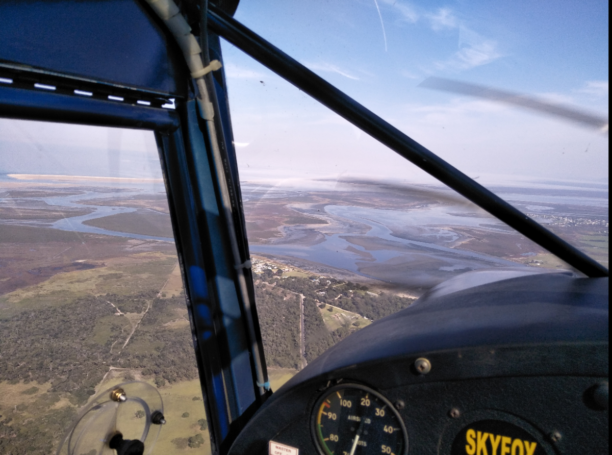

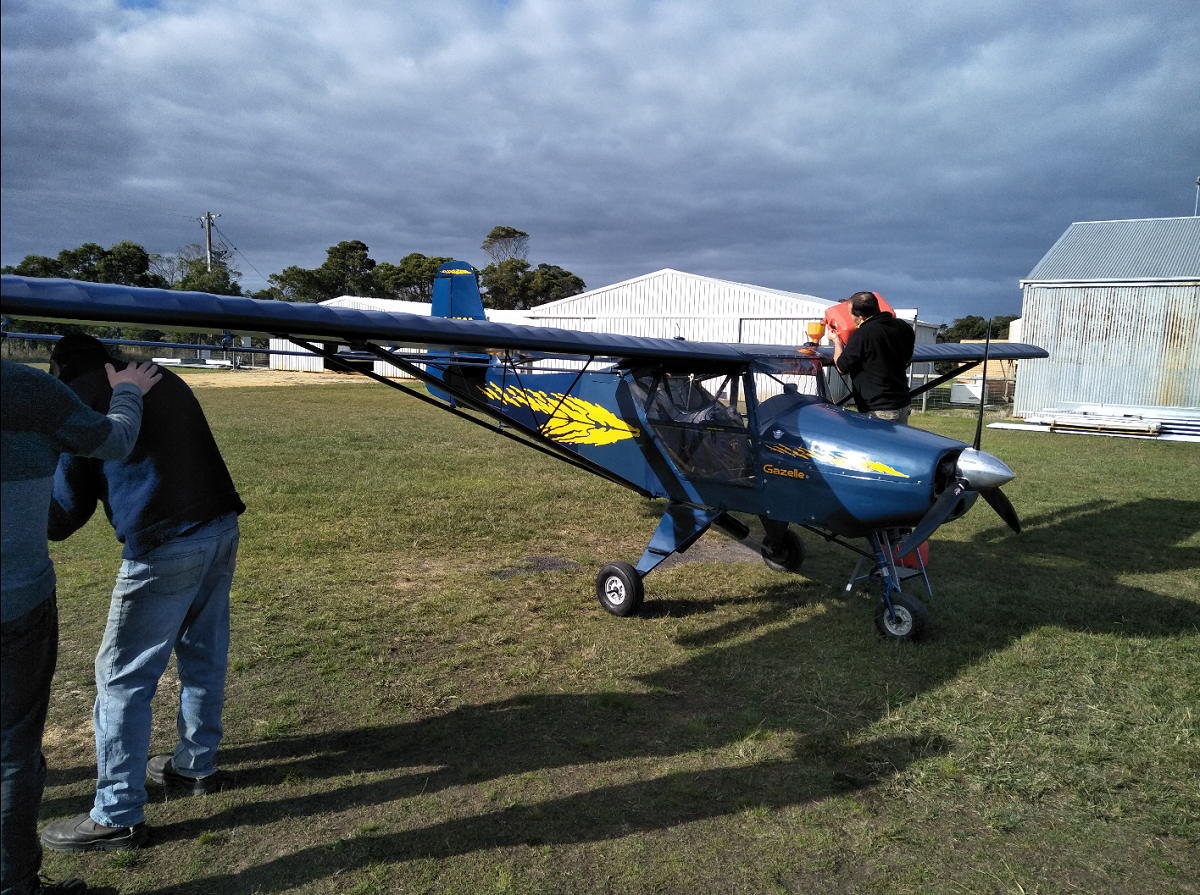

Bought a Fox recently. Very happy....it flies!! Magic! There are some who seem to claim it’s “so easy to fly”, you’re not really a pilot... Having flown 17 different types of SE aircraft below 5700 Kg, some well below...with a wide range of performance, I say that is nonsense. It’s an aircraft that will keep your skills more than up to scratch, in fact, being so light, speed control on finals and landing it, are definitely a bit more challenging than a C172 for example. I’ve flown the Eurofox and I agree, it seems to be what the Skyfox would have, or should have, developed into. They look very similar, cockpit doors virtually identical. Very nice machine the Euro. The Skyfox seems to have a very good safety record. The aileron hangers seem to be the biggest issue, so their condition if wood, needs to be carefully monitored. The biggest threat today, is the fact they are getting old......I agree about the fuselage, it looks pretty strong! Tubes everywhere. The other point of interest, is the AD for an additional fuselage lower cross member. Age related I think, more than a design problem. I must admit, for a trainer, they could have made the landing gear a bit stronger. For those on a budget, I think they are very good value today. I also think, getting one and re-building it, could bean attractive option rather than buying a kit. The one problem being those irreplaceable wing spars. Some recent pics of my beast, after much love and servicing, back in the air!7F8AAAF2-513C-4DDF-BE70-8B32840284CF.thumb.png.fd6f7e911aa0b7401dc75ff325b392d2.pngBA0616B8-BBA7-4588-B510-4C75B670D458.thumb.png.18e5d47e305edd18dffe1b4b3cc5bbb1.png14AE5207-0BFE-43F2-92EE-5F9E0E4CCFA7.thumb.png.7224dda96ba37596cc7015edf7213b58.png
