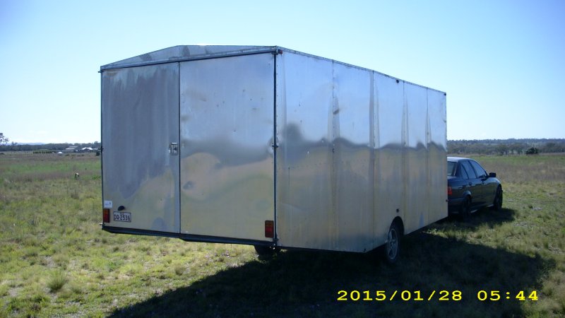

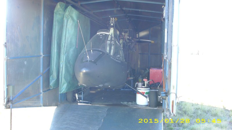

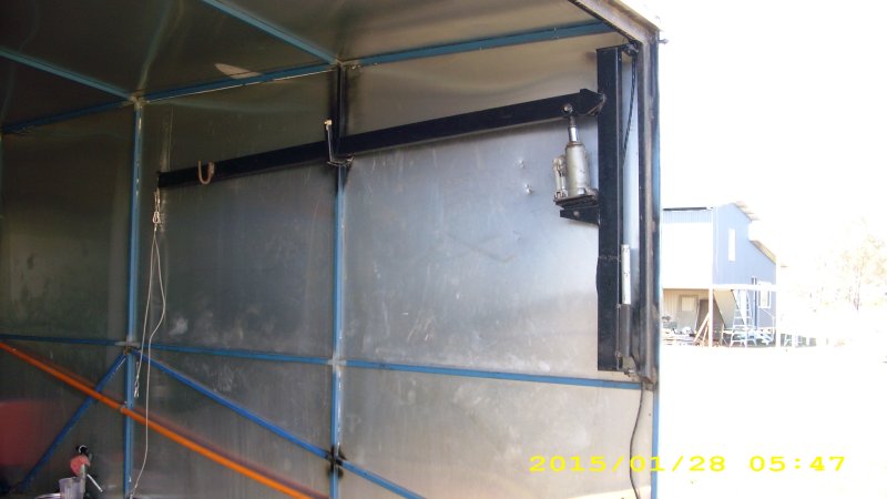

My Drifter lives in a trailer, I rig it every time I go flying. I have it set up so that I can rig/de-rig in about 30 min on a good day or 40 min if I dawdle. My trailer is fully enclosed, but lightly built. It has a hoist to lift the wings on, and a winch to pull the fuselage into the trailer.

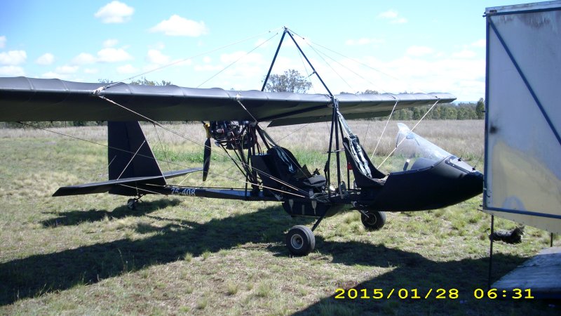

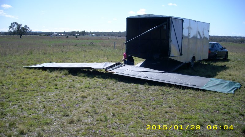

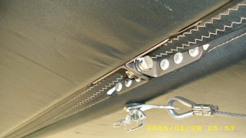

Some pics. You can see by the time stamp (time and date not actually correct) that it took 47 min to rig.
  • Winner 1
Also for the record, the trailer cost me about $2500 in materials. The empty weight is 480kg and would be lighter with an aluminium checkerplate floor, but I like that the ply adds weight down low.
