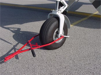

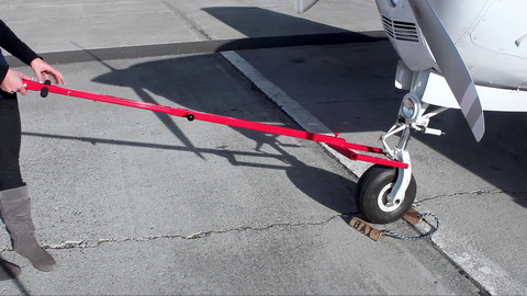

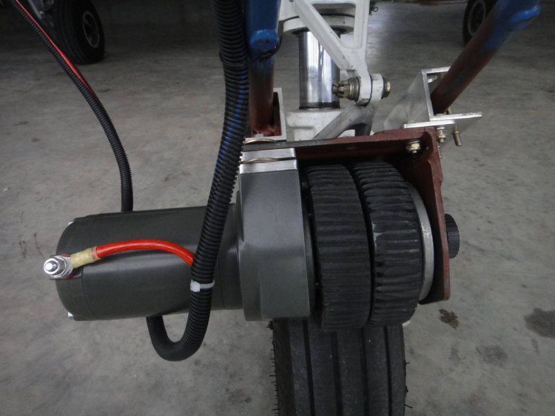

Head in the clouds Posted November 29, 2015 Share Posted November 29, 2015 It's been pointed out to me that it's a Gazelle not a Skyfox hence no tailwheel, so I'm wondering why the standard nosewheel towbar method doesn't work? If you don't have one it shouldn't cost much to have one made up in a metalworker's shop. The first three are images with an idea of cost from a net search for "nose wheel tow bar". If you post a picture of your nosewheel Debra, we could see how a standard one of these could be converted to fit your plane? You do have to [provide the effort to shove it around though, but it's much easier than trying to push down on the tail and shove it at the same time, better for the plane too - These next pics show powered varieties of plane movers, the first has been custom made using a 12V gearmotor and rubber donuts which rub on, and drive the nosewheel while you steer it with a towbar like the ones above. The gearmotors can be had by online purchase for about $100 and a mechanical shop might be interested in making the rest up for you. The second one is an electrically driven (probably 12V rechargeable) buggy that clips onto your nosewheel and lifts it off the ground to give weight and hence traction to the buggy wheels, they're about $1000 last time I looked. The third one is similar but the nosewheel rests on the buggy and there is a locking device to hold it there, they were about $1600 IIRC. (Click on the images to enlarge them) EDIT - apologies Robbo, you beat me to it, but they're a bit expensive now aren't they? I actually drew one up some years ago that would run off a small motorcycle battery. I might dig out the CAD files and see what it would cost to have the parts laser cut. There would have to be a market, I guess, and they wouldn't be anywhere near that price. 1 Link to comment Share on other sites More sharing options...
