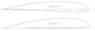

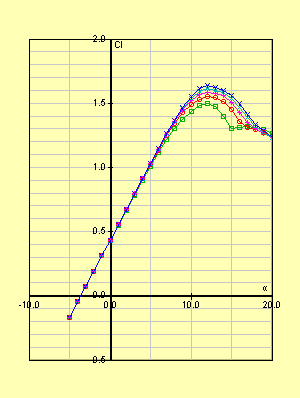

pylon500 Posted December 10, 2015 Share Posted December 10, 2015 certain airfoils will generate positive lift with negative angle of attack Basically what I was getting at. I was going to ad some diagrams (but went and had tea instead) Here ya go.....; The bottom surface of the old Clark Y section can have a negative angle (I know, irrelevant) while producing lift, in fact at high speeds even the chord line can be at a negative AoA, and still producing lift! The above polar is for some variations of the Clark Y section, hence the different colour plots. (I just pinched this off the net without reading too much..) The horizontal plot line above is AoA, while the vertical line is the lift coefficient. You can see that at 0° AoA, the wing is still producing about 45% of it's capable lift. Yes, the aircraft would be descending, but it IS flying, not plummeting out of the sky. which aircraft can fly with a negative angle of attack? Most gliders..... Link to comment Share on other sites More sharing options...
facthunter Posted December 10, 2015 Share Posted December 10, 2015 The zero lift line on most assymetric aerofoils is a negative AoA.. Nev 2 Link to comment Share on other sites More sharing options...
