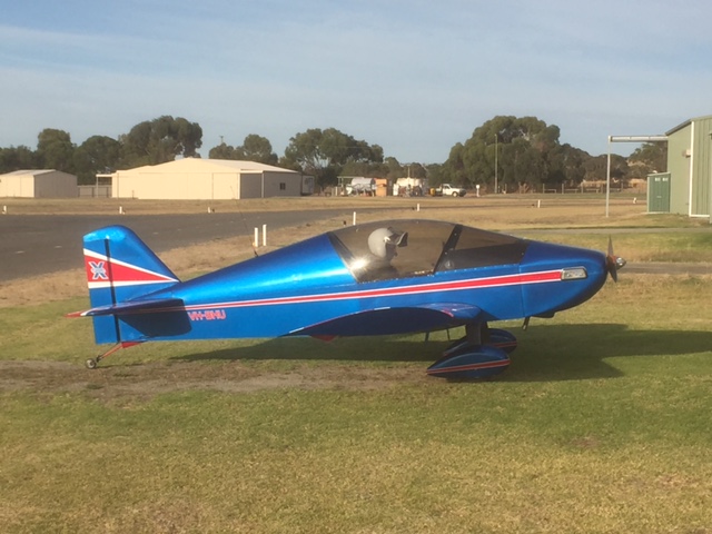

peter Posted December 27, 2015 Share Posted December 27, 2015 Onex VH BHU took to the sky yesterday with test pilot Chris Kelly, and again early this morning with me at the controls. 3 years since ordering the kit! Over controlled it enormously on take off, stick forces are so light it is amazing. Took it up to 3000 ft and ran it hard then eased back for some slow "approach speed" runs with 1 and the 2 stages of flap then some gentle turns, climbing and descending and straight and level, topped out at 120 knots IAS, 14 degrees OAT. Landing view is different to say the least and just touched tail wheel before the mains. Great machine, well balanced, will not need any trim tabs, flies with 2 fingers on the stick. To say I'm delighted would be a huge understatement. Peter 14 9 Link to comment Share on other sites More sharing options...

nickduncs84 Posted December 29, 2015 Share Posted December 29, 2015 Awesome!!! Love the paint job! Link to comment Share on other sites More sharing options...
