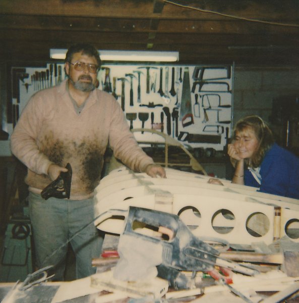

I built an HM14 with HM293 wings 25years ago, I powered it with a Robin 440 with a homebuilt V belt reduction.
I had a number of attempts to fly it but because of the lead/lag delay in yaw/roll, once off the ground I couldn't keep it on the centreline of the strip with PIO dutch roll phugoid roll/yaw.
Some years later Fred Byron asked if he could play with the problem and replaced the all flying rudder with a smaller fin and rudder and cut a Cosandy? Flap into the rear wing and re-powered it with a Rotax503. The Flea was subsequently successfully flown and then sold to an American collector.image.jpeg.a6f59d79c9a9a34b19d096582fb52720.jpeg
I built an HM14 with HM293 wings 25years ago, I powered it with a Robin 440 with a homebuilt V belt reduction.I had a number of attempts to fly it but because of the lead/lag delay in yaw/roll, once off the ground I couldn't keep it on the centreline of the strip with PIO dutch roll phugoid roll/yaw.
Some years later Fred Byron asked if he could play with the problem and replaced the all flying rudder with a smaller fin and rudder and cut a Cosandy? Flap into the rear wing and re-powered it with a Rotax503. The Flea was subsequently successfully flown and then sold to an American collector.[ATTACH=full]40953[/ATTACH]
Indeed it was - I flew it for Fred prior to it going to the US and it was quite nice to fly. The fixed fin/rudder combo gives them much nicer feel on the control column than the full flying rudder and it had a Rotax when i flew it at Evans Head so it had at least another change from the cossandy and fin/rudder.
I mentioned the change to a 503. I had sold the Robin engine and re-drive to Mark Fisher who was going to use it to power a Strognik? S2A Motor glider, Mark sold the incomplete motor glider to someone in WA, havn't heard if it was ever completed. It's a shame Fred's health failed not long after he sold our Flea, he had some great ideas on Flea design and development. I havn't heard from Fred for several years, and given his poor health I fear the worst.
I lost interest in the Flea concept and have designed and built several 3 axis aircraft since then.
