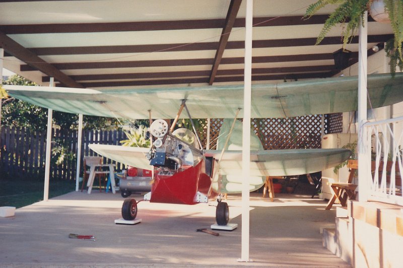

kasper Posted January 25, 2016 Share Posted January 25, 2016 I mentioned the change to a 503. I had sold the Robin engine and re-drive to Mark Fisher who was going to use it to power a Strognik? S2A Motor glider, Mark sold the incomplete motor glider to someone in WA, havn't heard if it was ever completed. It's a shame Fred's health failed not long after he sold our Flea, he had some great ideas on Flea design and development. I havn't heard from Fred for several years, and given his poor health I fear the worst.I lost interest in the Flea concept and have designed and built several 3 axis aircraft since then. Sorry about the oversight - I gave Fred bits for the R503 from my spares box ... was fun flying behind it - it was free air but we only had the fanforced rear housing ... so there was extra casting sticking out. Haven't spoken to Fred for a few years and last time I met up with him he was still cancelling the daily 'rat poison' (warfarin) with beer ... all under the doctors orders of course. His garage still held much of Flea building and I gave him a belt redrive set for another engine he was hoping to do for a flea but most of his time was on helping someone build a 601 Link to comment Share on other sites More sharing options...

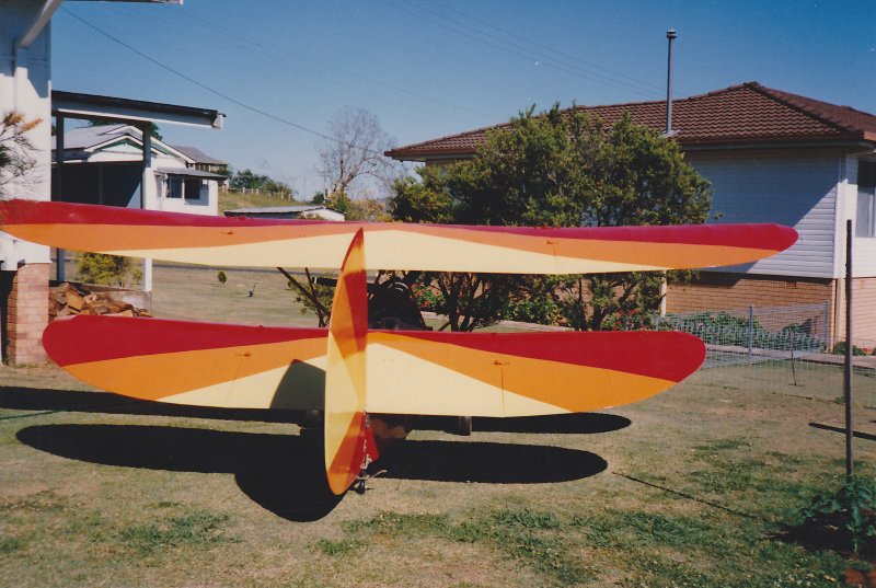

kasper Posted January 25, 2016 Share Posted January 25, 2016 And another[ATTACH=full]40963[/ATTACH] Oh and I preferred your 'thruster' type undercarriage on the HM14 to either the original sprung beam axle or the later tripod with bungee - flew both of those on HM14s in France and they are not as nice as the steel springs you used - even if I did manage to land it in the middle of a puddle and give myself and the flea rainwater rinse :-/ Link to comment Share on other sites More sharing options...

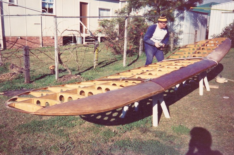

rotax618 Posted January 25, 2016 Share Posted January 25, 2016 My flea had a standard length fuselage as per Henry's book "Sport de la Air"? The few times I got it off the ground I found it very stable in pitch but because of the enormous flying rudder and short couple was neigh impossible to keep straight. The 40hp Robin was adequate power, less power would certainly require more wing span/area. This is another photo of a friend helping to prepare the front wing for covering. 1 Link to comment Share on other sites More sharing options...
