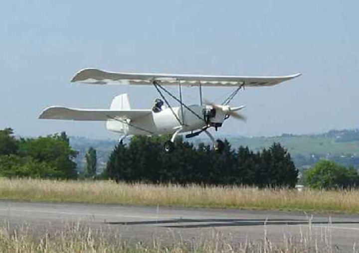

Admin Posted October 25, 2007 Author Share Posted October 25, 2007 What about this one - what a great sunvisor: Link to comment Share on other sites More sharing options...
Deskpilot Posted October 26, 2007 Share Posted October 26, 2007 Modern version of the Flying Flea?? Link to comment Share on other sites More sharing options...
facthunter Posted October 26, 2007 Share Posted October 26, 2007 Flying flea. Deskpilot, I think it is, In fact I would put money on it ( and I'm not a betting man ). No ailerons, big rudder, hinged mainplane. Sometimes they put differential spoilers to aid x/wind landings. Nev.... Link to comment Share on other sites More sharing options...
hihosland Posted October 26, 2007 Share Posted October 26, 2007 I think that is the version that has ailerons on the rear wing with the fore wing free floating. The only control pitch control being a large trim tab in the centre of the fore wing. Is there a web link to this aircraft Ian? davidh Link to comment Share on other sites More sharing options...
Admin Posted October 26, 2007 Author Share Posted October 26, 2007 Can't seem to find a website for it but it is called an Acro CLP. The only details I have is: Description: This is probably best performing of all the microlight Flying Fleas, with perfectly clean aerodynamic lines plus a composite fuselage. The fabric-covered wooden wings are detachable in three parts for transport. It is available in kit form or ready to fly. Price (excl. VAT)52260 € Kit Price (excl. VAT)16800 € Empty weight (EW, kg):280 Wing span (WS, m):8.50 Wing area (WA, m2):17.6 Tank capacity (TC, litre):45 Engine (Eng):Rotax 912 Power (hp):80 Max all-up wt (Wmax, kg):472.5 Number of seats (St):2 Maximun speed (Vmax, km/h):250 Cruise speed (Vc, km/h):200 Stall speed (Vs0, km/h):63 Climb rate (Vz, m/s):- Fuel consumption (FC, l/h):- Class:FAI-ML Certification (Cert):- hoto1: Photo2:Not avaliable. CategoryHomebuilt Manufacturers DescriptionNot a new design but unavailable to the public for some time, this staggered-wing aircraft will be back on the market in 2007, if the plans of the manufacturer come to fruition. Empty weight (EW, kg):- Wing span (WS, m):- Wing area (WA, m2):17.6 Tank capacity (TC, litre):35 Engine (Eng):Rotax to Continental Power (hp):35-65 Max all-up wt (Wmax, kg):450 Number of seats (St):2 Maximun speed (Vmax, km/h):170 Cruise speed (Vc, km/h):160 Stall speed (Vs0, km/h):60 Name:Acro Alias:Acro Address:Aérodrome de Mâcon-Charnay City:Charnay-les-Mâcon Postal_code:71850 State: Phonecode:+33 Phone:(0)6 03 19 94 97 Fax: Email:[email protected] Homepage: Contact:Yves Croses Country:FRANCE Category:Fixed-Wing - ML / LSA Manufacturers Aircraft:CLP [Fixed-Wing - ML / LSA Manufacturers] Airplume [Homebuilt Manufacturers] Link to comment Share on other sites More sharing options...
