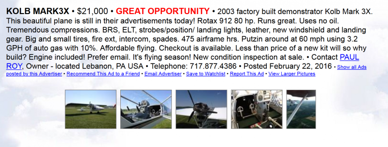

Yes, I seen that one. Very cool! I'm still learning, but are those LS? I don't know anything about ownership. How is this different than owning an ultralight? Registration insurance etc.
