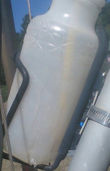

Overflow bottle had pressurized I guess and blew a hole out the bottom.IMG_20160410_160629.jpg.2367f52d827fe9b2048416b5bf93f4ec.jpg

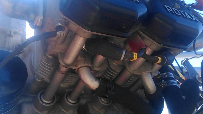

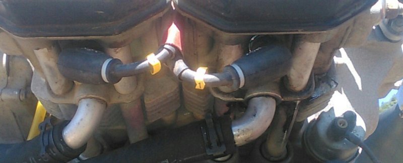

Oil leak cylinder #1IMG_20160410_155947.jpg.be58e4779c5b3c06e12bb2df791985a0.jpg
Small leak cylinder #2IMG_20160410_134225.jpg.0c590521a8e8dbb88143f5e51c5278ab.jpg

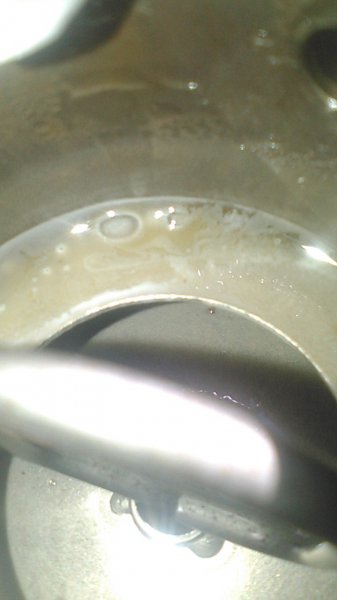

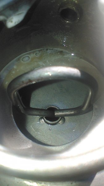

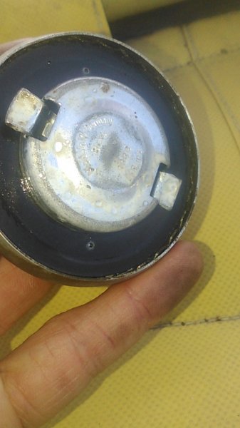

Cream and water residue on oil cap and in reservoir

"Overflow bottle had pressurized I guess and blew a hole out the bottom"
If the overflow bottle does not already have an amount of coolant in it (in other words its empty), the incoming flow of boiling coolant will melt the more flimsy bottles like that.
  • Informative 2
Thanks, I can't believe this overflow bottle was used. Does it come this way from the factory?
I expected it to fill up with coolant when I turned the motor off. Should I add some room temp coolant next time?
Thanks, I can't believe this overflow bottle was used. Does it come this way from the factory?I expected it to fill up with coolant when I turned the motor off. Should I add some room temp coolant next time?
Yes, it should be about 1/2 full all the time.
