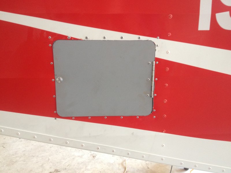

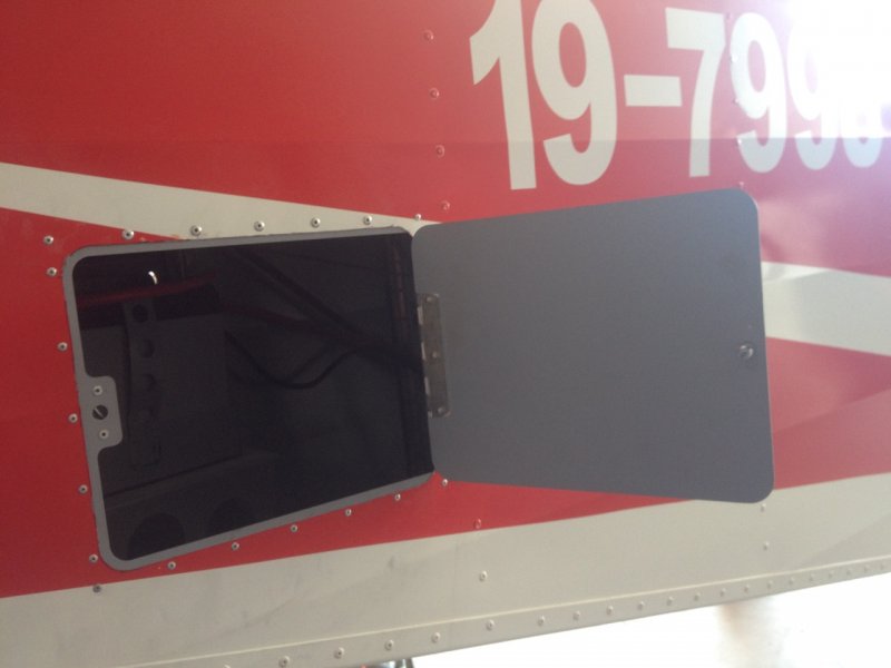

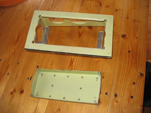

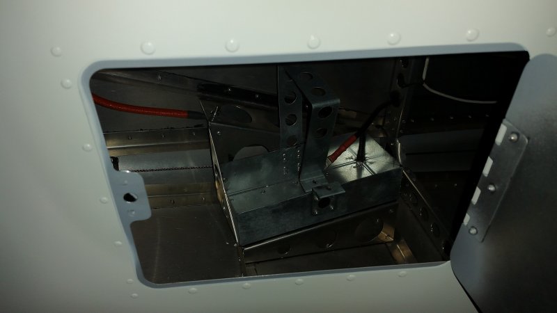

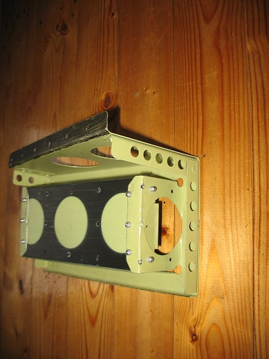

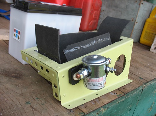

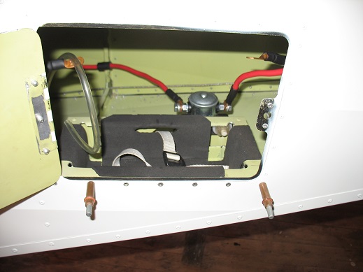

I would love to see pics of your battery box set up. Since I will be using a Corvair engine I will also need to shift the battery back. I ordered two boxes, mounted the first one in the stock location just for grins. Now, how to mount one near the access door in the tail???
I used some surplus angulars from the area around the extra fuel tanks and fixed them between the fames either side of the door. Trouble is once you put the battery in there is very little room to reach in and do up the retainer bolt, hence the need to swap the door to the opposite side. Photo coming soon.
With a few careful cuts and folds, I modified the battery box so the battery drops into a "well" cut into the top of the original "shelf". 1178757777_201208(4).jpg.3f8f7e206cb4130b3bc92eda0af67cf6.jpg
I added some rubber padding on the bottom and sides.
I elected to install a battery isolator solenoid on the positive cable in the wiring at the battery box. A ground wire from the solenoid runs to a "Master" toggle switch on the panel. Grounding that wire via the switch powers the system.
This leaves lots of room to connect the battery cables either before or after battery placement and makes installation and removal a snap.
My solution to battery access.
Fly safely,
Dan
Thanks for the pics and the different solutions to the problem! Kyle, how is your box installed? It looks like the stock battery box but I can't see how you've modified it... Thanks all!

Do you have any pics of the battery box install? Close ups? How did you modify it to fit? I've heard that the taildragger version has the battery in the tail... maybe they have a custom support design?
