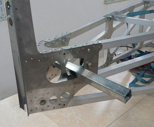

bexrbetter Posted August 1, 2016 Author Share Posted August 1, 2016 So I'm slowly getting through the thumb pain and the heatwave is going away a little, so getting back up to speed. Concentrating on the tail a bit now and after a few iterations of horizontal stabiliser pivots, have arrived at this mock up - please note just a rubbish piece of square tube to test with, all bolts loose, no nuts even, and not indicative of the final materials used. 2 Link to comment Share on other sites More sharing options...

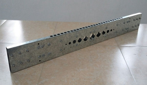

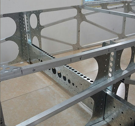

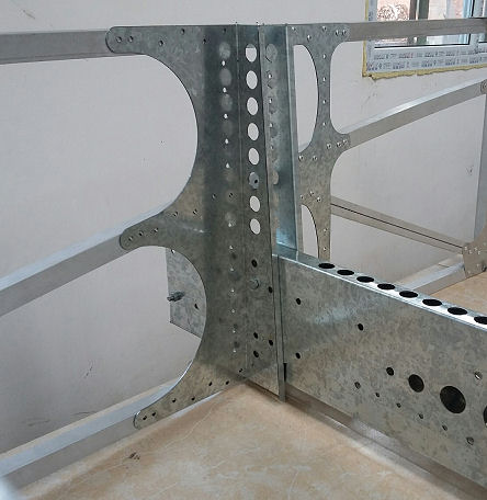

bexrbetter Posted August 2, 2016 Author Share Posted August 2, 2016 So I'm almost settled on a design for the center wing crossmember after a bunch of experiments. I have simplified it to a self supporting, easily produced and assembled module, along with far simplified design for the side plates to attach it to the longerons. Both are simply laser cut, folded and bolted/riveted together in minutes - and very importantly, super cheap. I haven't decided on the final material yet so don't take the prototype pieces shown here made from galvanised sheet as the actual finalised product. Sheet steel is less painful to my pocket to throw in the rubbish bin if the design proves to need changes a few steps further along. 7 Link to comment Share on other sites More sharing options...

Nobody Posted August 4, 2016 Share Posted August 4, 2016 Bex, I hesitate adding this comment as I realise it is difficult to judge with only two photos, but do you mind sharing your thoughts on the pattern of lightening holes in the carry through? I would have thought that the moment was constant through the member and you would want as much material as possible in the top flange. Is there something else going on here? The pattern in the sie with the increasing hole size looks good, following the shear flow. Nobody Link to comment Share on other sites More sharing options...
bexrbetter Posted August 4, 2016 Author Share Posted August 4, 2016 Bex,I hesitate adding this comment as I realise it is difficult to judge with only two photos, but do you mind sharing your thoughts on the pattern of lightening holes in the carry through? I would have thought that the moment was constant through the member and you would want as much material as possible in the top flange. Is there something else going on here? Yup, there's a lot more going on and I don't actually need either top or lower flanges, but without them I felt it would look too weird for acceptance from the rather conservative, not to mention, gossipy, Flyers. You should see the plane I would like to build! Bex,The pattern in the side with the increasing hole size looks good, following the shear flow. And considerably smaller than what they could be, be I can't align front and rear if I went bigger, would look weird. Link to comment Share on other sites More sharing options...

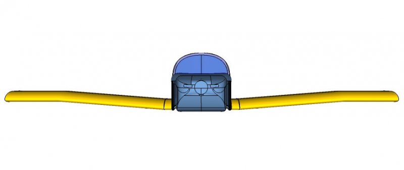

bexrbetter Posted August 6, 2016 Author Share Posted August 6, 2016 Funny how some things run. Many times you need to compromise on what design you want due to lack of common or easy to source materials. Sometimes it all goes to plan. But there's a few other times that everything not only falls into place, but suddenly you see a chance to do even better and easier with simple design and common materials, and the wings just took a turn that way. I had worked out a simple method and material list for a simple straight wing with dihedral, then when I was playing in the computer a few days ago optimising it, suddenly I realised that it was actually easier and less effort with the same material list to make a gullwing which very few planes have other than a few Gliders. There's some possible minimal aero advantages, but the real reason is they just look better, it's that simple. 2 Link to comment Share on other sites More sharing options...

onetrack Posted August 6, 2016 Share Posted August 6, 2016 Bex, doesn't the gullwing design mean more fasteners, and multiple wing sections, that detract from the inherent strength of one straight, simple section? 1 Link to comment Share on other sites More sharing options...
bexrbetter Posted August 6, 2016 Author Share Posted August 6, 2016 Bex, doesn't the gullwing design mean more fasteners, and multiple wing sections, that detract from the inherent strength of one straight, simple section? Again; "I had worked out a simple method and material list for a simple straight wing with dihedral, then when I was playing in the computer a few days ago optimising it, suddenly I realised that it was actually easier and less effort with the same material list to make a gullwing" If you did it in some of the traditional styles of building then in some cases you might be right, but you may have noticed already that I don't do things like other people do. 3 1 Link to comment Share on other sites More sharing options...
Marty_d Posted August 7, 2016 Share Posted August 7, 2016 I look forward to seeing how it's less effort than a straight wing... bottom line is there's a change in the plane of the wing which requires a joint in the skins at the very least. 1 Link to comment Share on other sites More sharing options...
onetrack Posted August 7, 2016 Share Posted August 7, 2016 If you did it in some of the traditional styles of building then in some cases you might be right, but you may have noticed already that I don't do things like other people do. Ahhh, Yes! So this design improvement, is just the gradual progression, towards the fabulous and unique Bex Ornithopter? 1 Link to comment Share on other sites More sharing options...
Pilot Pete Posted August 7, 2016 Share Posted August 7, 2016 bottom line is there's a change in the plane of the wing which requires a joint in the skins at the very least. Arent there joins in the skins of most wings anyway? 2 Link to comment Share on other sites More sharing options...
Pilot Pete Posted August 7, 2016 Share Posted August 7, 2016 Do you still plan on having a rotatable hinge joint at the root to enable wing fold back with the gull wing? 1 Link to comment Share on other sites More sharing options...
bexrbetter Posted August 7, 2016 Author Share Posted August 7, 2016 Ahhh, Yes! So this design improvement, is just the gradual progression, towards the fabulous and unique Bex Ornithopter? "design improvement" might be construed the wrong way. I'm not claiming anything is better design wise other than being far cheaper, easier and faster to build. If you equate planes to cars, there's plenty of BMW's through to Ferrari's out there, especially related to price, but not so many Toyota Camrys. bottom line is there's a change in the plane of the wing which requires a joint in the skins at the very least. Bottom line is there already was a join in the wing skin at the same place, nothing has changed at all, same sheets, same ribs, same spars as I would have used for the straight wing. As I said, and for the 3rd time; the material list is unchanged. 3 Link to comment Share on other sites More sharing options...

Marty_d Posted August 7, 2016 Share Posted August 7, 2016 Arent there joins in the skins of most wings anyway? Along the length? Not in mine, unless you count where the top skin angles down to the top of the cockpit. Link to comment Share on other sites More sharing options...
bexrbetter Posted August 7, 2016 Author Share Posted August 7, 2016 Along the length? Not in mine, unless you count where the top skin angles down to the top of the cockpit. Many craft have a full length skin but I choose not to for cost and especially handling concerns, a decision made long before any gullwing considerations. 1 1 Link to comment Share on other sites More sharing options...
