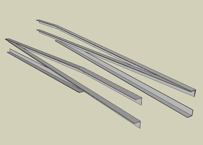

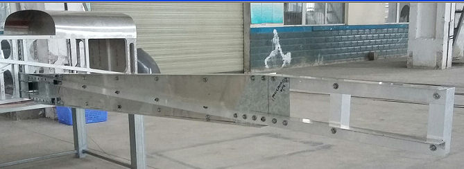

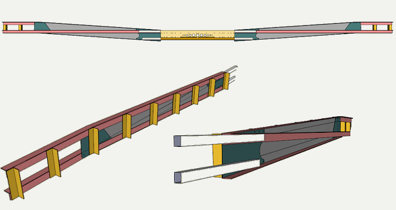

bexrbetter Posted October 13, 2016 Author Share Posted October 13, 2016 The gullwingwing designs are almost finished after many minor structural iterations to make sure they can be easily replicated and repaired at home. I would have had one done today had I had electricity, there's a building being constructed nearby and the local area power gets shut down occasionally for them to install stuff. The primary structure is of aluminium angle and the assemblies are bolted together, very strong, not super light but not terribly heavy either, but importantly, cheap to build using common materials and replicable techniques. 3 Link to comment Share on other sites More sharing options...

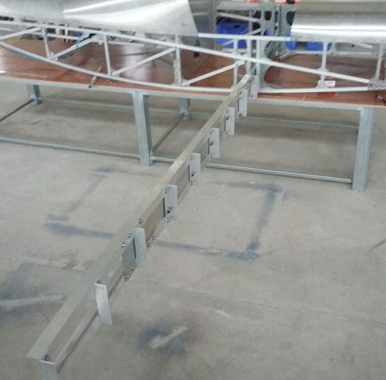

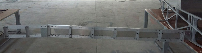

bexrbetter Posted October 14, 2016 Author Share Posted October 14, 2016 ... and turning it into reality, although a bit to go yet, rivets would be nice, tomorrow maybe ..... 6 Link to comment Share on other sites More sharing options...

Marty_d Posted October 15, 2016 Share Posted October 15, 2016 ... and turning it into reality, although a bit to go yet, rivets would be nice, tomorrow maybe ..... [ATTACH=full]46268[/ATTACH] [ATTACH=full]46269[/ATTACH] [ATTACH=full]46270[/ATTACH] On the final version is the spar web solid riveted to the extrusions? Link to comment Share on other sites More sharing options...
