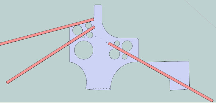

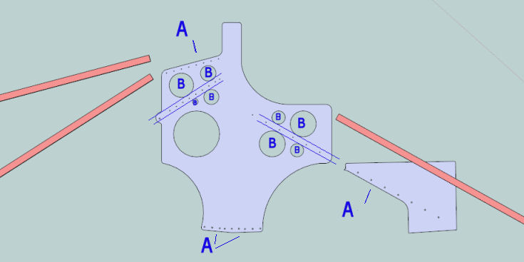

Please note this is a jigless, self aligning build, built on any reasonable flat'ish workbench or floor if you still got young limbs!

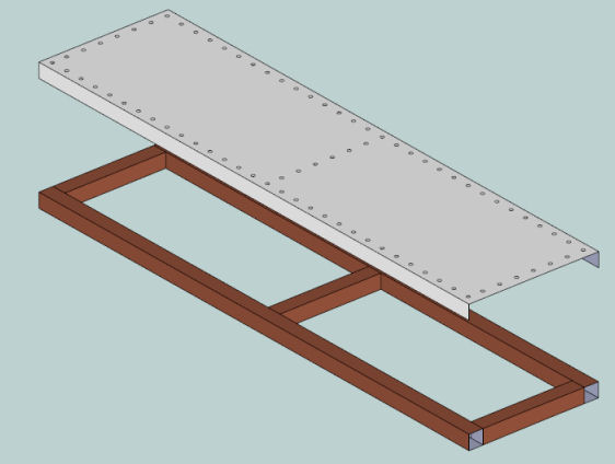

Example; You see that center fixture plate above, flat sides "A" are an alignment tool, as are the edges of the holes "B", it works a treat. Sit the plates on top of the tubes, use these aligning aids and drill through the pre-lasered holes. Clean and rivet.
It really is that easy.
The thicker support plates have the correct sized hole, while the thinner aluminium sheets have pilot holes only, or else the drill wanders and ovals a full sized hole.
Here is another example used,
A pre-laser holed and folded "U" channel, or 90 degree fold otherwise, is supplied and you merely pop your tubes into the 90 degree corners accordingly, add your cross braces, drill, clean and rivet.

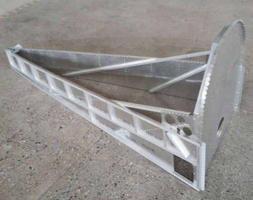

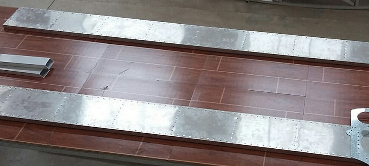

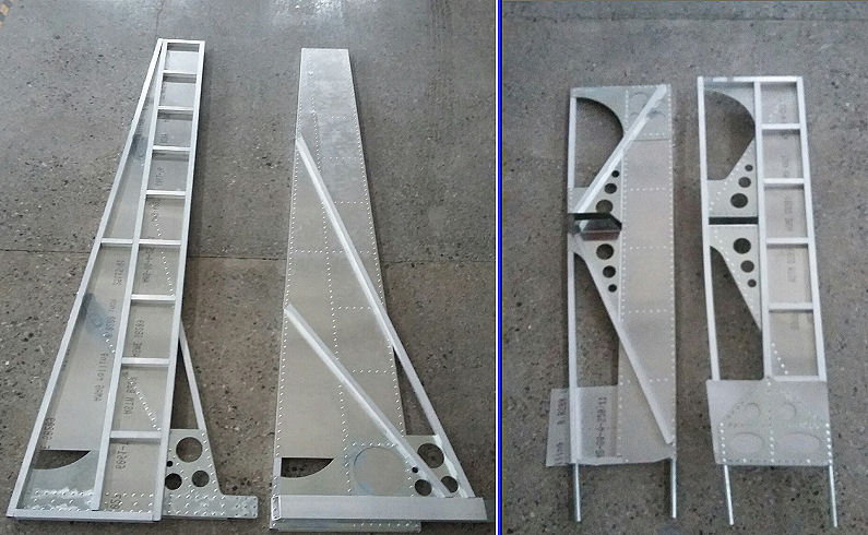

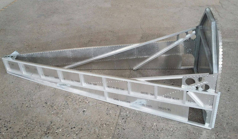

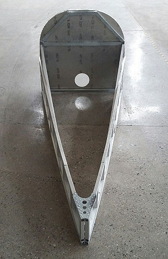

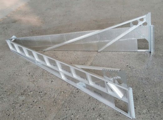

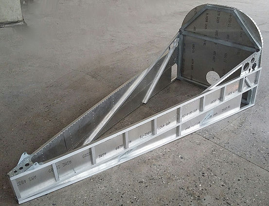

So finished these sides this morning, and started screwing, ok riveting, the rear half together.
This involved first joining the tail, then merely bringing the halves together to the roll cage, clamp, drill through the lasered pilot holes, clean and rivet. All self aligning and self jigging without measuring anything.
I am extremely pleased with the ease and speed they go together, not to mention the result.
One of the good things is that now the entire rear half, and entire front halves of the fuse will be able to be built independent of each other and bought together at a later stage as required.
There are homebuilders who lack building or bench space, and this will be ideal for them.
Marty, as there are no rear half central laterals installed yet, that's why there's little "curvy" at the moment. Those laterals will push it out further in the middle.

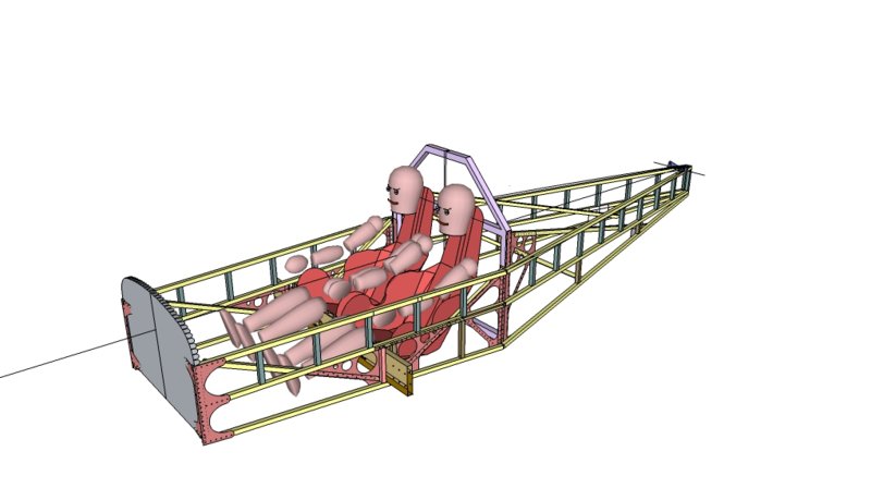

My 4 year old daughter asks "Why don't the people have any bodies?"I was going to ask why they look p*ssed off, maybe it's because of that!
Because they can't respect the weight limits for ULMs in France if they have bodies ;)
