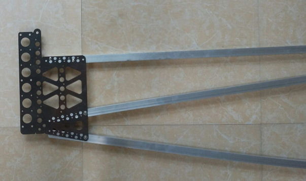

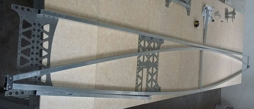

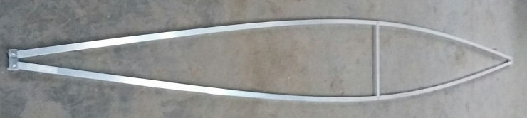

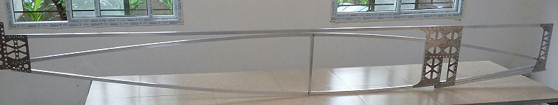

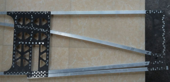

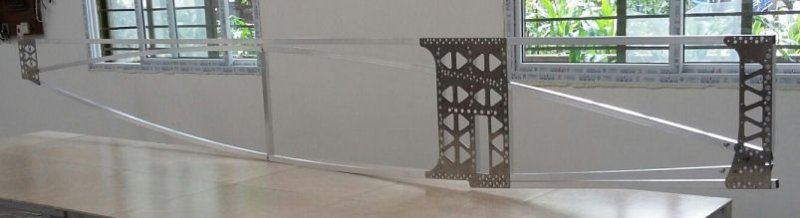

bexrbetter Posted June 3, 2016 Author Share Posted June 3, 2016 Well looks like we have rung out all the ladder puns, better get back to my things. Taking notice of what you guys say and thinking about things, the last 2 days I had a look again at the "Boxy" accusations, after having a good old cry, you heartless bastards. Now while putting a curve in a tube presents no problem at all, I've even got my own electric triple die roller sitting around and various dies, doing it time after time is near impossible. It's ok for a one off build where you can make some adjustments by either rolling a little more or straightening it out on the floor - as simple as pushing both ends down or trapping and end in something and levering it. As we want the same result over and over and no one wants a twisted plane, rolling was always out as a choice, hence the flat bottoms you currently see. Simply flexing a tube up has it's drawbacks, it of course wants to pull the top longeron down so you need bracing, gussets and diagonals to prevent it doing so - more weight and complexity. .. and then it struck me. A guy on a bicycle when I was crossing the road busy thinking about this. How about if I flexed the lower tube up and oppose it's force with another going the other way ... bingo!, self contained curve that can be replicated every time. Simple as securing each end and putting a separator in the middle. So I spent 10 minutes to create this .. And then I pulled some tubes off one of the existing sides, laid down the "lens" (that's the actual legitimate name for this shape) on top and it looked like this .. Hmm, 4 natural triangles, gentle curves for the "Boxy" whiners, might be onto something here. So yesterday spent a bit of time in 2D CAD, drew up some new front, mid and rear support plates to accept the lens, and off to the laser guy this morning who cut them from some leftovers so I could do a trial run and now I have this ... So going to get a little FEA done over the weekend and see how it stands up (with suitable bracing etc.). 6 Link to comment Share on other sites More sharing options...

pylon500 Posted June 3, 2016 Share Posted June 3, 2016 Shame about all those side plates you had lasered !! And as mentioned before, if fully skinning the sides, you only need light bits of angle to stiffen the skin. Link to comment Share on other sites More sharing options...
geoffreywh Posted June 4, 2016 Share Posted June 4, 2016 I wrote earlier that it looked " boxy" That was not serious critique. I think that the excellent, strong and easy to assemble box that you produced could be shaped as you wished, fleshed out with a fibreglass ( G forbid) turtledeck, canopy P51B style. and somebody elses "off the shelf " cowling. Don't get sidetracked by our comments, your idea was coming along very well. 1 Link to comment Share on other sites More sharing options...
