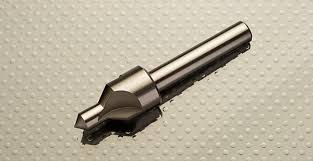

IBob Posted June 4, 2017 Author Share Posted June 4, 2017 Countersinking rivets. The manual suggests using an ordinary drill for this. I started my build with the 2 cheap drillsets I already had, later bought a Bosch set (1mm size steps), and more recently a Hitachi set (lower quality but smaller steps in sizes and multiple drills of each size). For countersinking rivets you need a drill tip angle of 120 degrees (I think). The Bosch and Hitachi are 120 degrees, the cheap drillsets (I now realise) are pointier than that, which explains why my early countersinks were difficult and required a lot of care to avoid opening out the rivet hole: Another good reason why I should have bought a good drill set at the start of the build. The best way to do countersinks is with a proper piloted 120Degree countersink bit: the pilot is an extended tip that sits in the rivet hole and holds the bit central, so avoiding tool chatter. They are available here, but very expensive and I would need 3 sizes. Can anyone point me to an affordable source? Link to comment Share on other sites More sharing options...

IBob Posted June 5, 2017 Author Share Posted June 5, 2017 Countersinking rivets.The manual suggests using an ordinary drill for this. I started my build with the 2 cheap drillsets I already had, later bought a Bosch set (1mm size steps), and more recently a Hitachi set (lower quality but smaller steps in sizes and multiple drills of each size). For countersinking rivets you need a drill tip angle of 120 degrees (I think). The Bosch and Hitachi are 120 degrees, the cheap drillsets (I now realise) are pointier than that, which explains why my early countersinks were difficult and required a lot of care to avoid opening out the rivet hole: Another good reason why I should have bought a good drill set at the start of the build. The best way to do countersinks is with a proper piloted 120Degree countersink bit: the pilot is an extended tip that sits in the rivet hole and holds the bit central, so avoiding tool chatter. [ATTACH=full]50630[/ATTACH][ATTACH=full]50631[/ATTACH] They are available here, but very expensive and I would need 3 sizes. Can anyone point me to an affordable source? Link to comment Share on other sites More sharing options...
rgmwa Posted June 5, 2017 Share Posted June 5, 2017 They are available here, but very expensive and I would need 3 sizes. Can anyone point me to an affordable source? You could try: 82, 120, & 130 Degree Countersink Cutters | Brown Aviation & Aircraft Tools or Counter Sink Cutters - Cleaveland Aircraft Tool It would be a good idea to get a countersink cage too. rgmwa Link to comment Share on other sites More sharing options...

Kyle Communications Posted May 8, 2019 Share Posted May 8, 2019 [/url]https://www.henchman.com.au/Countersink-Tools/Micro-Stop-Countersinks/pl.php I just bought one of these from here in OZ..very cheap actually. Aircraft spruce version is more than double the price in aussie dollars then add the freight. I bought one as it is used a lot building the S21. They do a lot of countersinking and skin dimpling. Its the one that you see in the Rans current S21 build videos it doesnt have the plastic foot but you can easily make one if required 1 Link to comment Share on other sites More sharing options...
